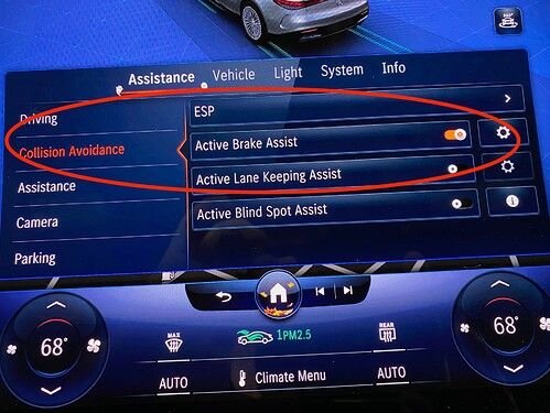

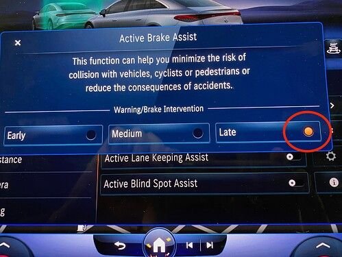

After discussing with the dealer I'm convinced it was the truck slightly drifting towards my lane. Furthermore this tolerance can be set:
Correct settings.
Despite that the EQS does seem to have more of an issue with big box trucks than any of my previous MB's which had none.
