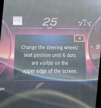

... untili six dots
I kept getting this message everytime I started driving after the car had been turned off. Embarrassingly so, now I know what it means. I was following another driver at night who kept putting on their
turn signal, but not turning. That was actually a message for me that my turn signal was on. I couldn't see it (or hear) it as the steering wheel was blocking the dash. duh.

Back to the original posting about the 6 dots:
It means there is an obstacle between your face and the camera in the dashboard - Mercedes monitors your eyes to warn you if you fall asleep. It happens typically when you drive holding the wheel at the top. Move your hand to the side and the message goes away.

He couldnt see the turn signals. What was in the way was the steering wheel.
