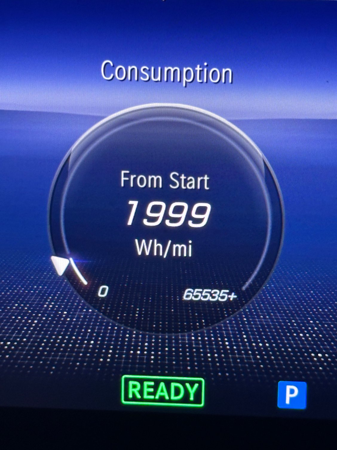

Hello all. Just got my EQS updated to E330 by the dealer but my consumption still shows a not useful range of 0-65535+ Wh/mi.
Anybody else in the same boat? Does anybody know how to fix this? I’ve already reset the entire system and it’s still broken.

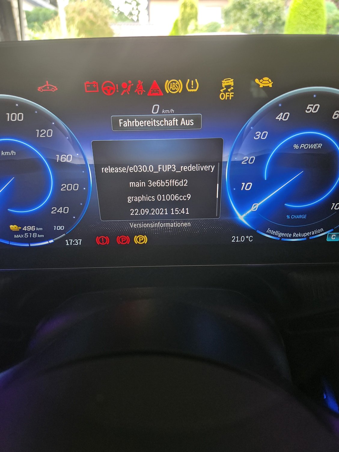

I think the instrument cluster also needs an update, unfortunately it is not updated with MBUX. I also have MBUX version E330 from April 2023 but my instrument cluster version seems to be from 2021 on my EQE

On Youtube there are several videos that show how to access the hidden workshop menu, this one for example (Be careful not to confirm anything in this hidden menu under Assyst Plus Settings)
An update can only be performed in the workshop. I don't know exactly if any of this information provided in the hidden menu refers to the software version of the instrument cluster.

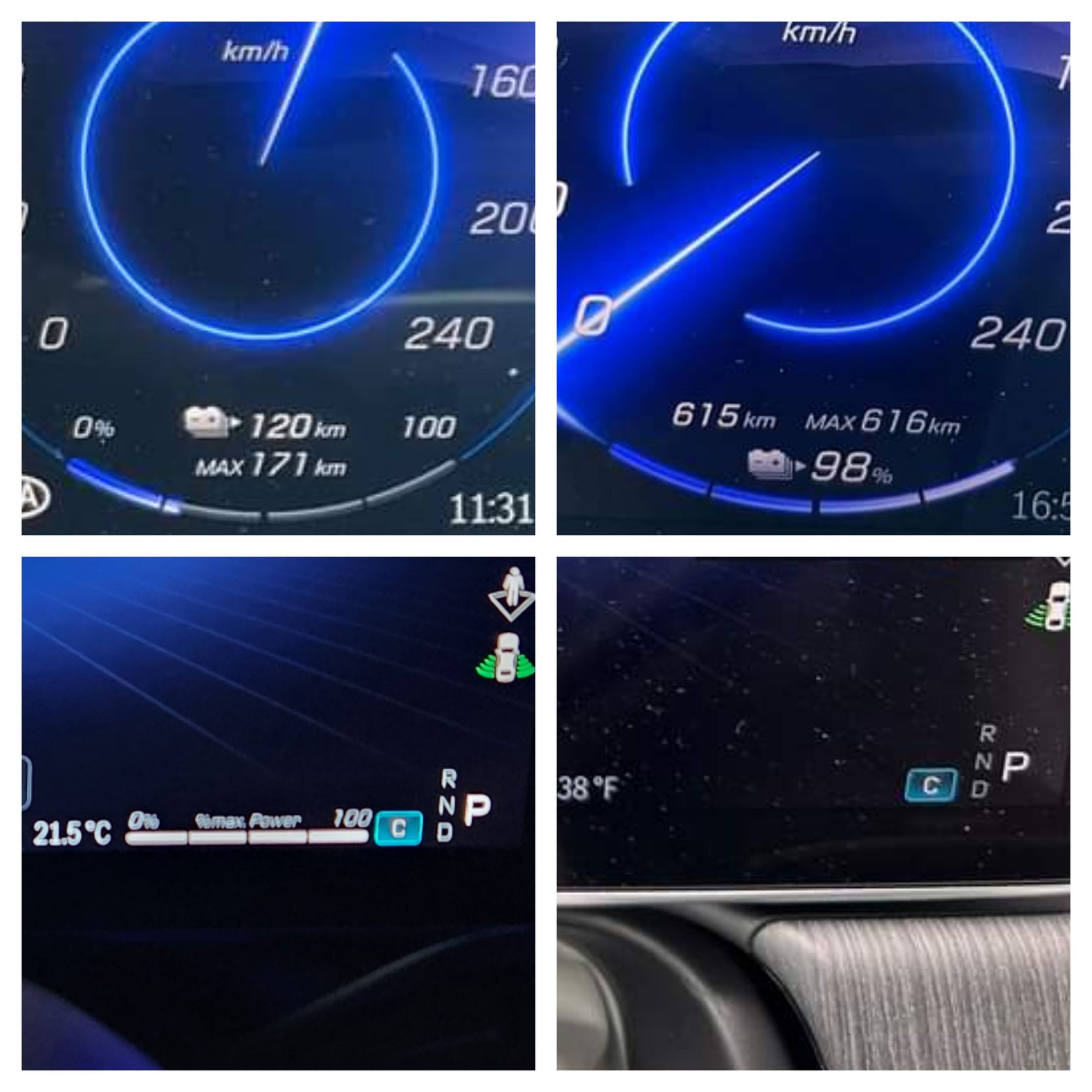

But you can recognize an outdated version e.g. by the fact that the the battery level indicator is missing the percentage at the bottom left or in the Navi-, Assistance- and Service view is a power bar at the bottom right, where the bar does not move and only constantly displays Max Power.
