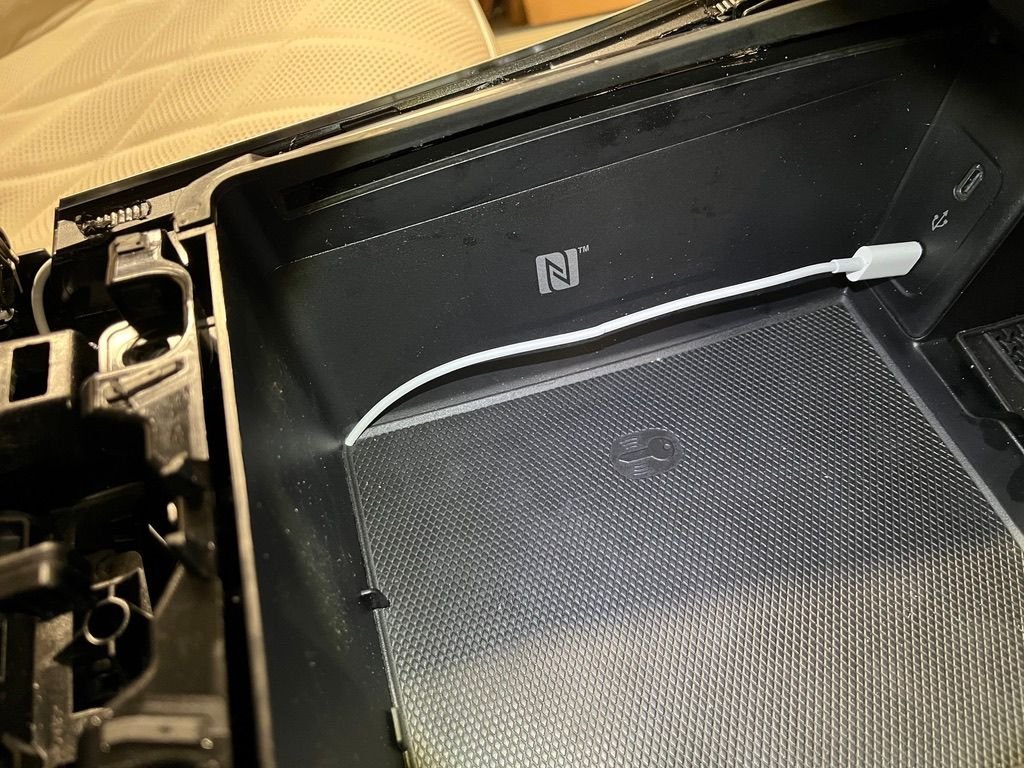

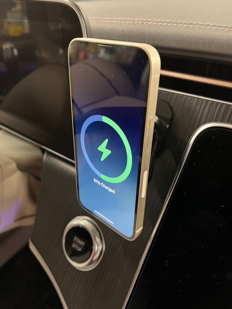

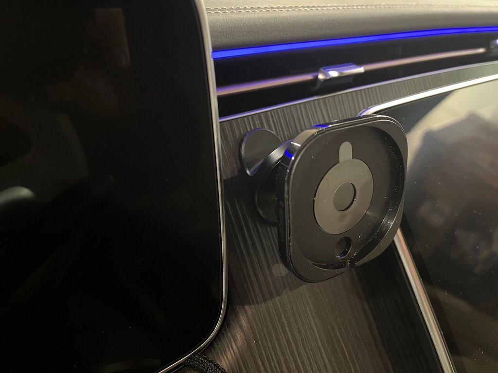

I got tired of trying to align my phone with the factory provided wireless charger. I was able to mount a MagSafe phone holder on the non-Hyperscreen dashboard. I disassembled the center console to run the charger cable to a USB C port in the cupholder compartment. Using the USB C port in this compartment automatically enables the take-your-cell-phone reminder when exiting the car.
