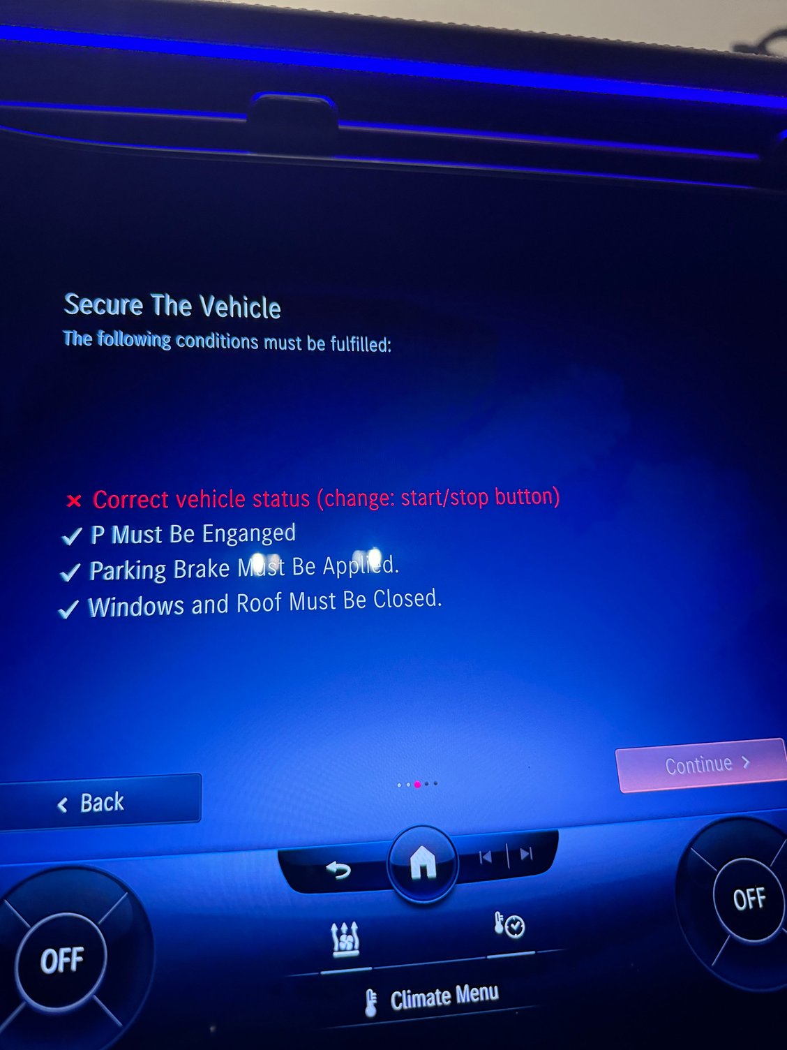

Can't install OTA Update
This latest OTA update won't install. It's not installing it automatically, and when I try to install it after turning off the car I get the attached error.

I bet it thinks one of the windows is not closed. Check the app. If the app says a window is open, do the window reset procedure.

I just got the same error. I assumed that "Correct Vehicle Status (change start/stop button)" meant that I should turn the car back on. It turns out that I was right. Once I pushed the Start Button, the update went to the next screen and from there I was able to initiate the install.
