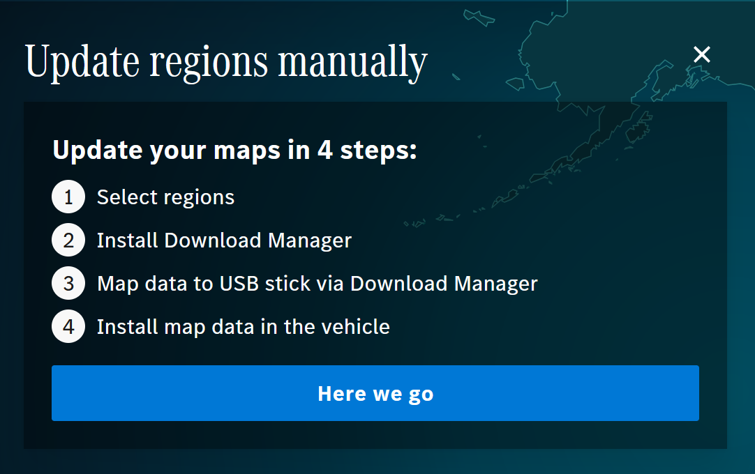

EQS is supposed to automatically update the maps. I have a 23 EQS 580 sedan, which will be 2 years old this December. It has not once updated any of the maps automatically. You can manually update the maps yourself, which I ended up doing. I’m on version 20/2024 in the US. It’s a bit time consuming. You download the map from your computer to a USB stick and plug it into a usb port in the car. I think the car has to be turned on to download because when I left the stick in the car overnight, the next morning it was on the same % download as when I turned it off the night before. Sometimes it took a few attempts before the maps finally loaded. It took a while but eventually I was able to install all the newest maps I wanted. Maps are divided by region. If you live on the east coast you don’t have to download the west coast maps.

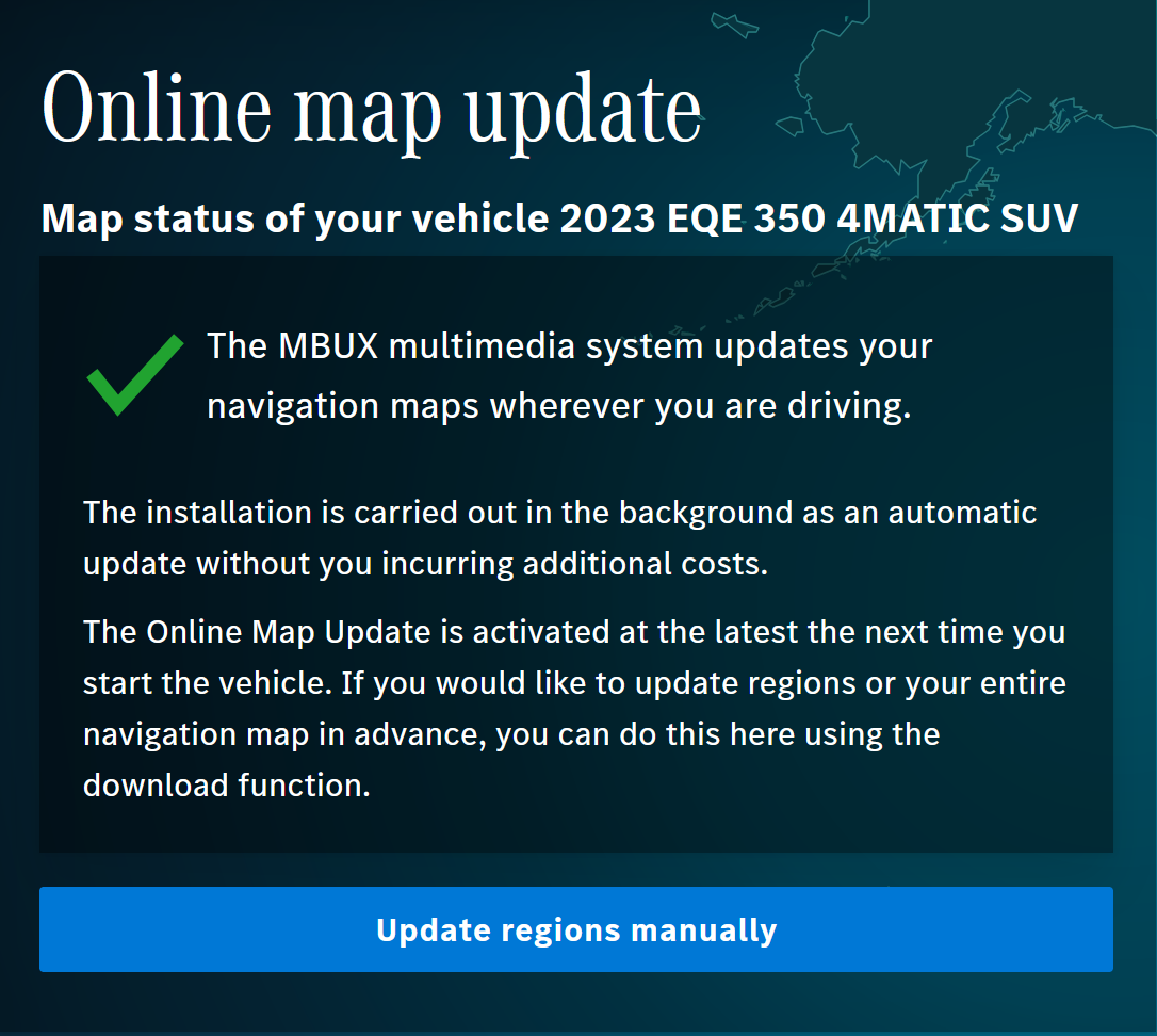

Originally Posted by sjhwilkes
Where on earth did you find maps to download to a USB stick? The site is full of circular and dead links and I can’t find anything useful apart from the manual.
From the Mercedes me account logon with my PC. GO to Digitial Extras and Map update:
1st step
1st step
Select #2 then #3
Select #2 then #3
