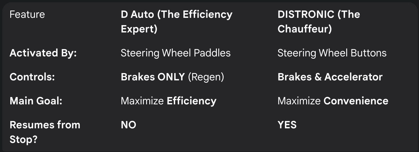

## Meet Co-Pilot #1: D Auto (The Efficiency Expert)
This is the system you activate with the steering wheel paddles. Think of D Auto as your car's meticulous Chief Efficiency Officer.
  • Primary Goal: Its one and only obsession is to save and recapture energy. It is fundamentally a recuperation (braking) system.
  • Activation: You "hire" this co-pilot by using the paddles until "D Auto" appears on your driver display.
  • Execution (What it does): D Auto's job is to be the smartest "braker" in the world. It uses radar and navigation data to decide when to coast (the most efficient state) or when to apply regenerative braking. It's so smart that it can bring you to a perfect, complete stop behind another car.
  • The Crucial Limitation: Once you are stopped, the Efficiency Expert's job is done. It has successfully brought you to a halt with maximum efficiency. It will never, ever touch the accelerator for you. It will hold the car in place, but you, the driver, must tap the accelerator to get moving again.
## Meet Co-Pilot #2: DISTRONIC (The Chauffeur)
This is the system you activate with the dedicated cruise control buttons on the left side of your steering wheel. Think of DISTRONIC as your personal automated chauffeur.
  • Primary Goal: Its obsession is to manage your speed and distance for maximum comfort and convenience. It is fundamentally a cruise control system.
  • Activation: You "hire" this co-pilot by pressing the "Set" button.
  • Execution (What it does): The Chauffeur's job is to take complete control of your momentum. It has access to both the accelerator and the brakes (both regenerative and friction). It will accelerate to your set speed, brake to maintain distance, and bring you to a complete stop. And, crucially, when the car in front moves, it will automatically resume driving and accelerate for you.

Two minor quibbles:
"Tap the accelerator" implies constant moving is started like the process to resume after D-Auto. Better to say use the accelerator to resume moving again.
The automatic resumption will be cancelled if the vehicle is stopped for an extended period of time. Tapping the accelerator or selecting the Resume button on the left side control on the steering wheel.

Originally Posted by LastOne
Two minor quibbles:
That's some truly sharp-eyed feedback. You've keyed in on a couple of incredibly subtle but important details that perfectly reveal the competing "personalities" of D Auto and DISTRONIC.
You are absolutely right that you "use" the accelerator to resume from a D Auto stop, not just "tap" it. That distinction is perfect because it highlights that D Auto is a system of pure assistance—it's a co-pilot that helps you brake with maximum efficiency, but you are always the pilot in command who decides when to go.
DISTRONIC, on the other hand, has a completely different personality. It's a system of delegation, and your point about its time-limit on auto-resume is a perfect example. That time limit isn't arbitrary; it's a direct result of the engineering and legal liability calculations that govern these Level 2 systems. The logic assumes that after an extended stop, the driver's attention may have drifted, so it requires that "digital handshake"—a tap of the accelerator or a press of the 'Resume' button—is the driver's way of explicitly confirming to the car, "Yes, I am still attentive and I accept the responsibility for moving forward."
