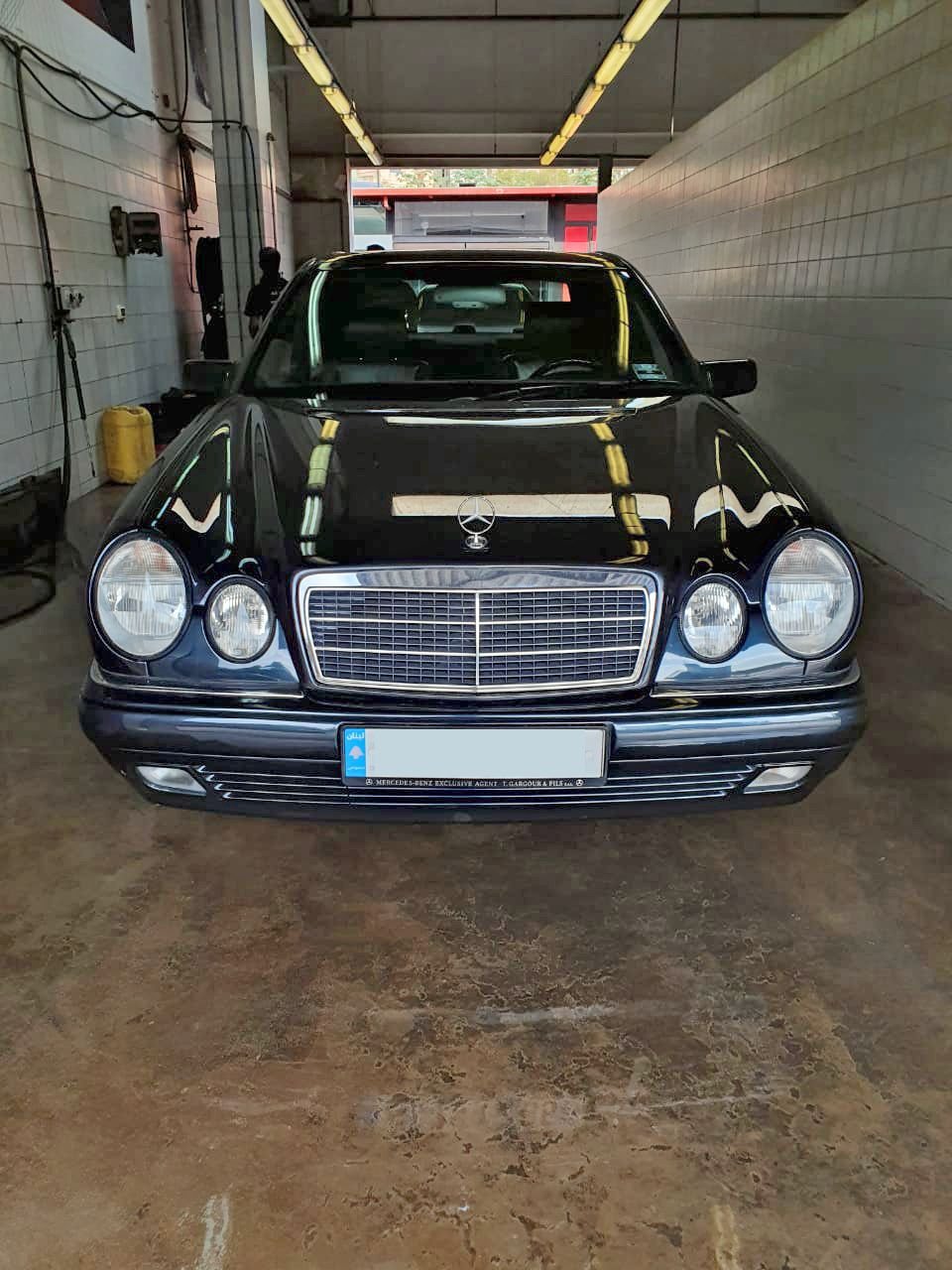

  • Just Before Its Grille Replacement
    Seats are in excellent condition for 245K Km, but will cleaned and given proper treatment.

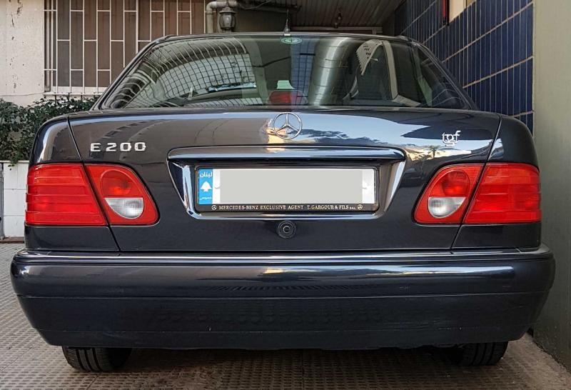

    Added the type badge on the left, new taillights all around!
    Fresh Michelin Tyres, Brand New Alloys, Screws, Central Caps & Pressure cap.

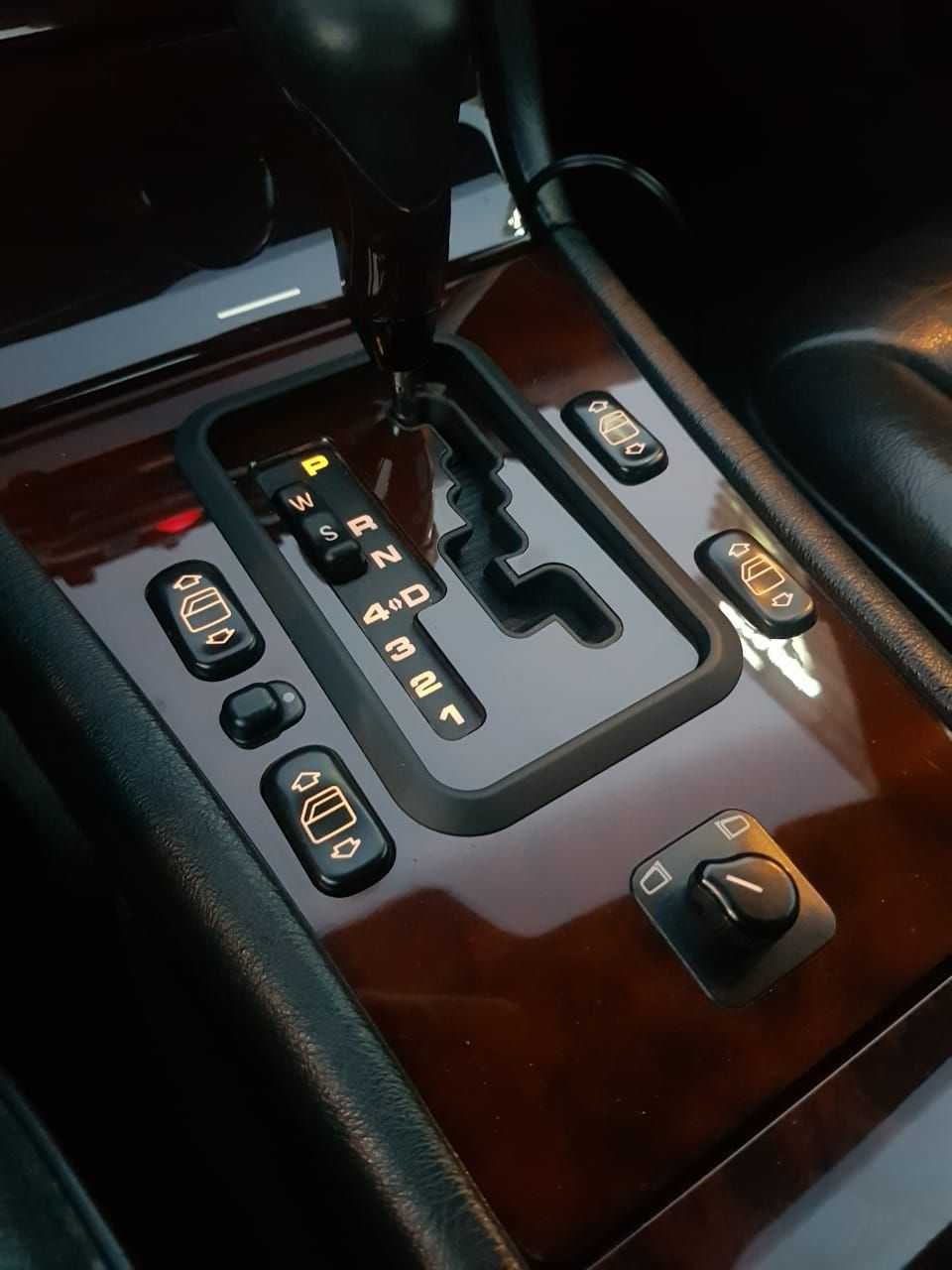

    New Wood, Switches & Gates All Around!
    The Elegance Grille as it should be.

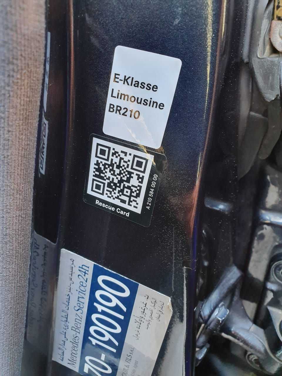

    The 24/7 and the Rescue Team QR Code!
