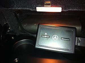

For those of you who own an iPhone/iPod and want better integration with your 2009+ G-Class, I can verify that the new Mercedes Media Interface Plus adapter works in my 2010 G55 (international version). This device is currently only sold in the US because the Pandora integration only works in the US (in theory) and it is English-only for the moment.
My next project is to get the MB InCar HotSpot (WiFi router) installed. They haven't released a kit for the G-Class yet, but after digging around the EPC data it seems that the kit from the GL/ML should work.
Some photos of the install:
Attached Thumbnails New Media Interface Plus installed and working-photo-1.jpg   New Media Interface Plus installed and working-photo-4.jpg   New Media Interface Plus installed and working-photo-3.jpg

Thats pretty cool, what did it cost?

yeah and where you got it ?

It costs about $300, but for now is only sold by dealers in the US. I bought mine via eBay.
