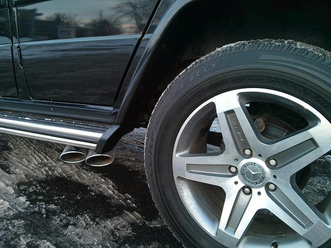

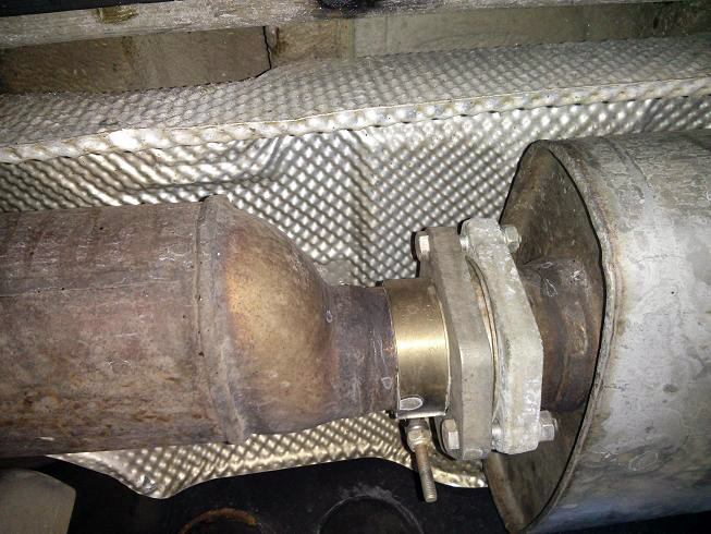

G500 with G63 Exhaust using Custom Exhaust Adapter
Karl from g-wagenaccessories came and saved the day. I was really hesitant of doing a permanent weld and wanted to have an OEM look with the ability to fix anything if needed in the future. He designed a custom exhaust adapter that is a perfect fit for the G63 Exhaust that I purchased. The adapter is made of heavy duty stainless steel and gave me the ability to install it with ease.
All you have to do is measure the length of the new mufflers and where they exit from the side and then cut the exhaust pipe after the 2nd cat, clean the surface of the existing pipe where the cut was made. Slip on the adapter over the opening and then tighten the T-Bolt clamp.
Now the best part, the rest is basically an OEM installation. The other end is a perfect flange and goes right into the G63 mufflers. Tighten with the 3 bolts from the adapter to the exhaust and its DONE!
