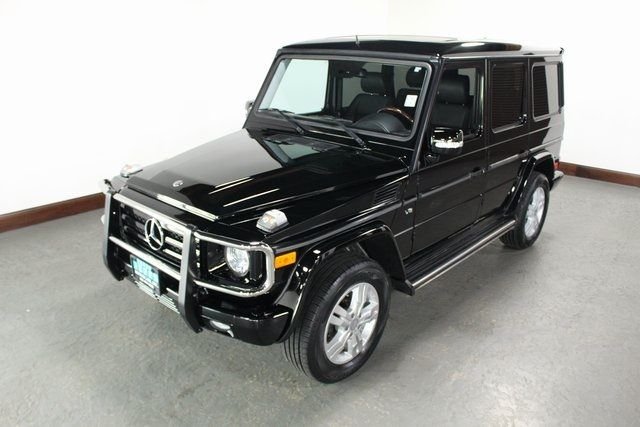

Hey Guys,
New owner of a 2009 G550. I have been lurking around G Wagons my whole life and finally decided to jump in. I bought a 2009 G550 with 67K miles. The car is from Ohio, I live in Portland Oregon so I really took a leap a faith buying on photos, video and carfax. When the care arrived it immediately took it to MBI Motors where I live for a, ah hem..., a pre purchase inspection. Keeping fingers crossed, and luckily the rig checked out ok and they said it had no big / obvious problems. They only found, rear diff leaking a little, rear shocks leaking a bit and they told me the whole exhaust system has a lot of rust. So the salt used where it lived for many years had really eaten away at the exhaust system. They said I should be fine for now but was told to be prepared to replace the whole exhaust system at some point and that the cost to replace the whole exhaust system would be $10,000. So I was wondering if that sounds right? I do not expect maintenance for the G to be thrifty and am prepare to do what it takes to keep it on the road. $10K sounds high for pipes though. I am surprised MB does not use stainless steel. I have a 1989 VW Vanagon Syncro with a Subaru motor in it and it has a SS exhaust system. for $10K I would think SS would be in order?
There was 3 quarter sized what looks like bubbling paint, I assume rust is underneath? Wondering if this is common with Gs?
Door hinges also show a little brown and looks really dry, should I smear some a axle grease on these hinges or something to aid in the movement and also keep further rusting at bay?
MPG, Im hoping for 10-13 and am prepared for this. Do you guys think if I add a roof rack and rear bumper, this one
https://www.g-wagenaccessories.com/p...ry-rear-bumper
I would be getting a lot less than 10- 13? or will these items not effect the MPG? I was told that if I wanted a tow hitch I need this bumper. Total added weight would be about 200 lbs
The car is awesome and I absolutely love driving it.
thanks guys,
