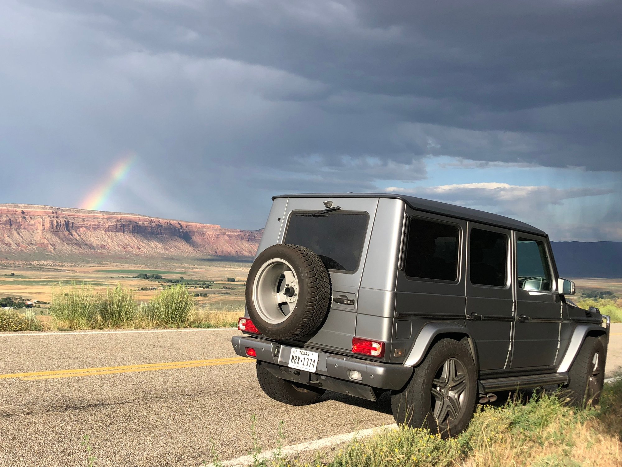

305/55's in toyo AT2s fit well without a lift and 31mm spacers - they work even better with a mild spring spacer....20mm would be perfect.
I went with a 40mm version and new Fox shocks and upgraded to 35's after this trip..... will be adding new brake/ locker lines and a 60 mm spacer to get it where I want it.....very slippery slope !

just to clarify - those are the 305's with spacers but no lift - this is with 40mm and 35's......
