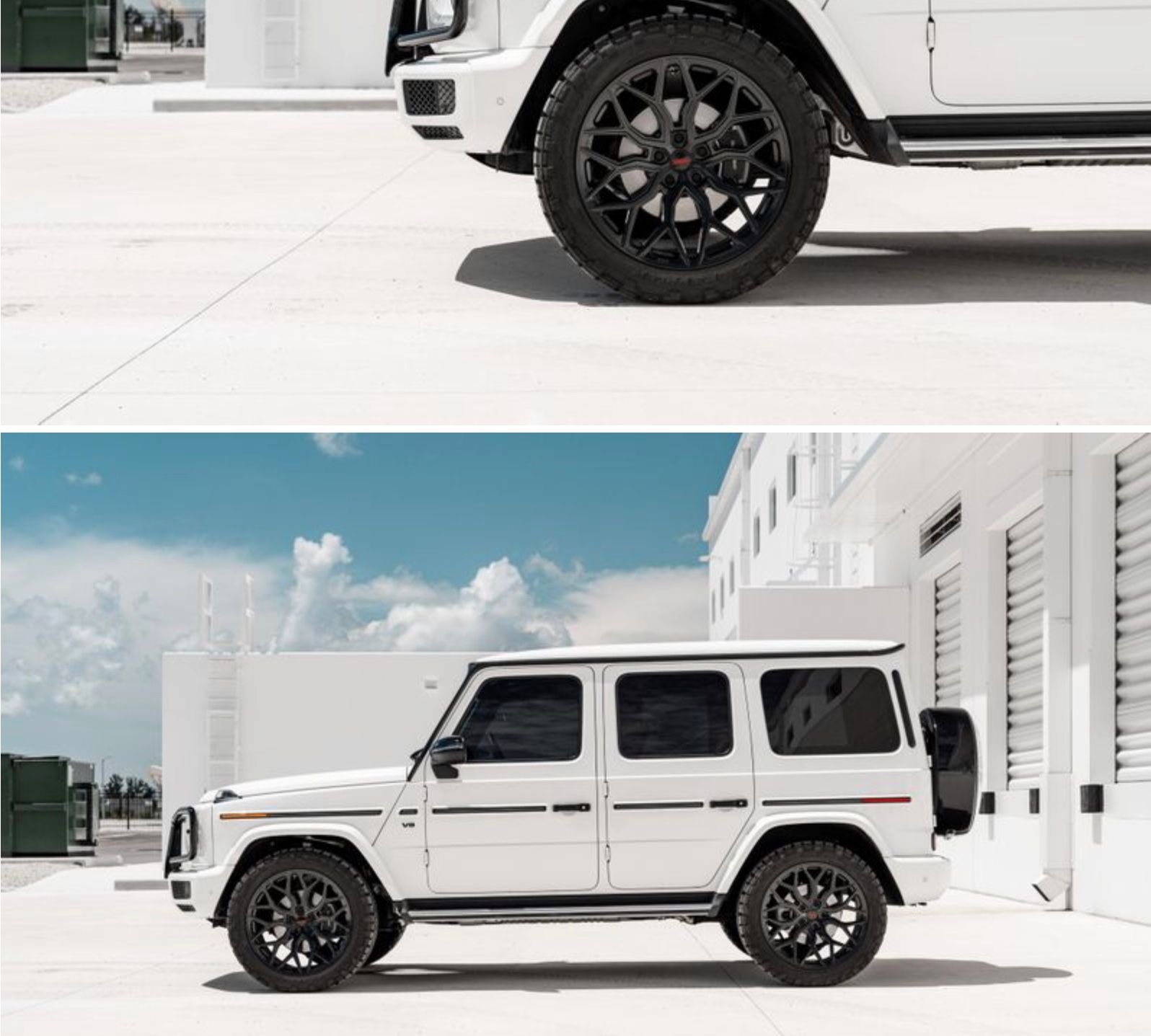

Oct 5, 2019 | 11:22 PM
These are Nito ridge grapplers 33x12.5R22 the wheels they’re fitted on are 22x10.5, I do believe this is without a lift and about as thick as you can get without one.
Reply 0

Oct 7, 2019 | 09:19 PM
Those tires rub on the g63. The g63 is different in the fender wall than the g550.
Trust me me I learned the hard way.
Reply 0
