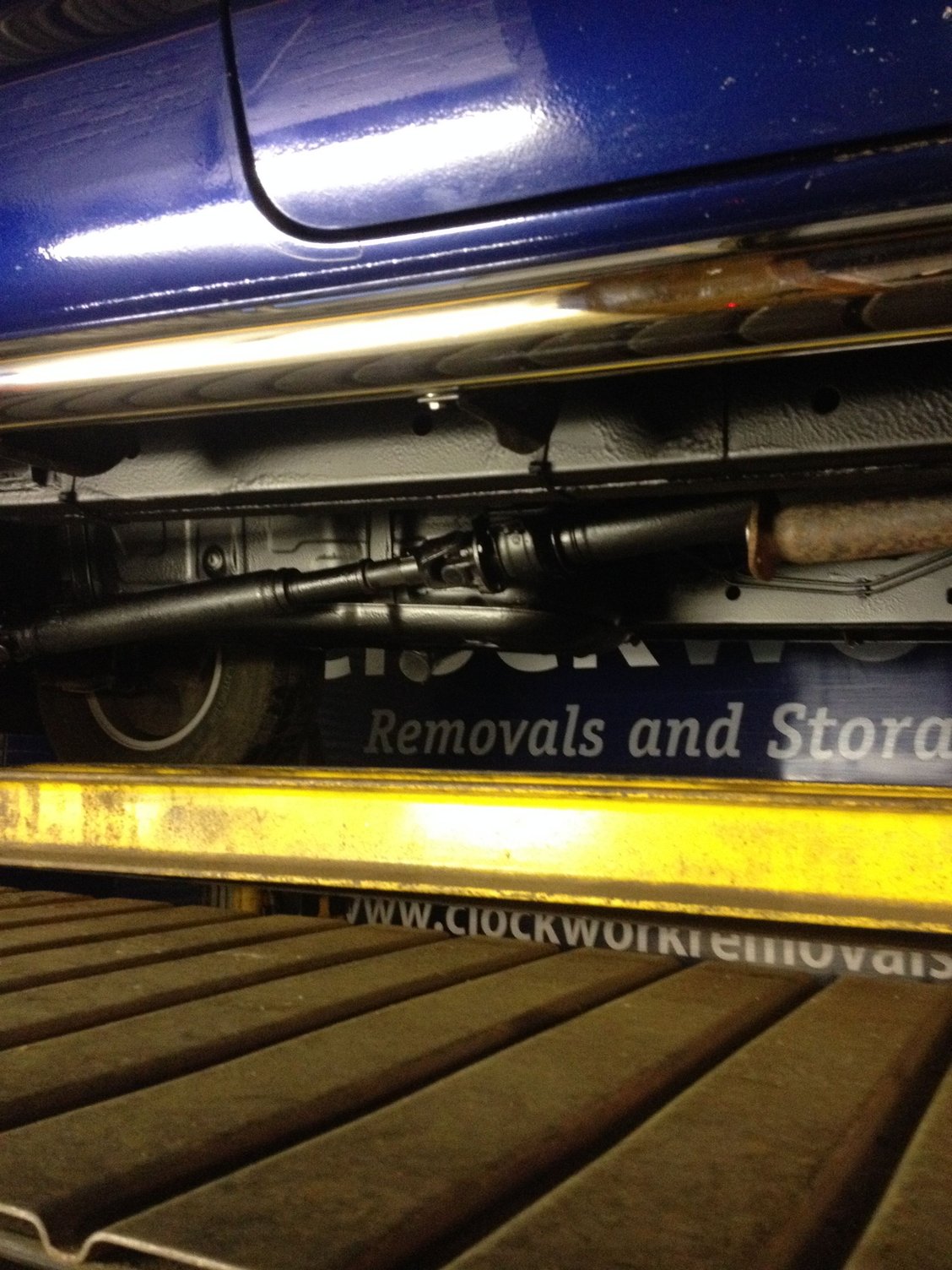

At my husbands garage in the UK we mix
https://www.greasemonkeydirect.com/p...hutz-underseal
with
https://www.hammerite.co.uk/product/waxoyl/
both products must be warm to do this and then we apply it all over the underside of the vehicle with this...
It seals the underside of the car and protects it from rust and it retains a kind of tacky feeing so it doesn’t dry and crack. It seems to hold up really well in this country... salted winter roads , rain, snow, rain, rain, rain, rain lol...
Not the greatest picture in the world but the only one he could find on his phone of the finish.
The worst part is the prep. All wheels removed, the whole vehicle masked above ground, the ramp masked, everything in the area masked- it’s super messy but the results are great.
