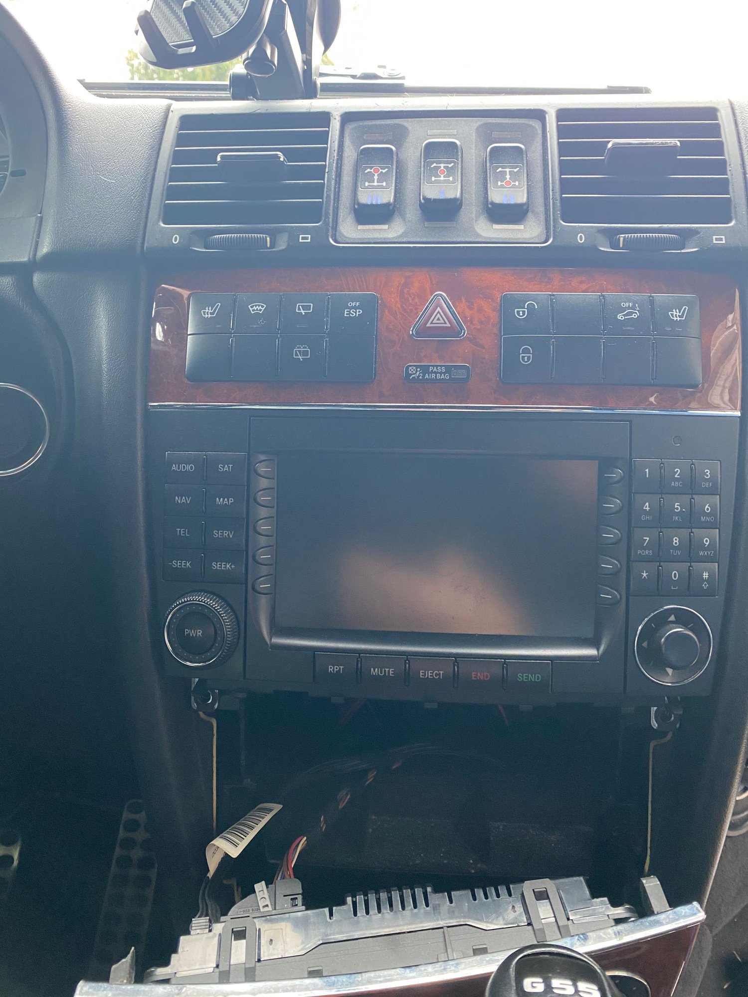

I am in the middle of adding the AUX cable to my Command Unit, and for the life of me can not figure out how to remove the radio.
You make it seem like a breeze.
How did you take the top part off?
I started from the bottom and only have access to the two bottom screws to the unit, not sure where to attack next.
Any info would be amazing!

Hah, nice Ian. I posted a reply over at CW. Will copy here for anyone in the future looking for this info:
"For the upper button panel, if it is anything like the 2005, you have to remove the differential switches first by prying it out. 2 clips on each side, but prying from the top or the bottom with a pry tool works well. Just be careful not to damage the AC vent surround pieces. There is a screw under the differential buttons that secures the top button panel to the internal cross bar. After that screw is removed, you can pry the unit out or maybe even push it out from the back side (the 2005 of course is one complete piece top to bottom). Maybe after the switch panel is removed there will be more screws under to remove the radio easily."
In the post you linked above with the picture of the dash apart:
"Here's a picture of the 2005 center stack removed. You can see the top screw location next to the differential rectangular connector on that metal plate. I can't imagine the setup having changed that much between 2005 and 2008 given the dash layout is generally the same."
One additional thing I noticed, the panel clips are on there really tight. It was almost uncomfortable the amount of force you have to pry with to get them to pop out. I don't have a better solution for this and I think breaking things won't be out of the question.

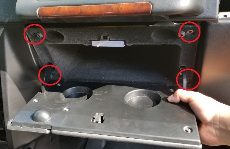

Start by removing the glove box by removing the 4 screws circled in red below:

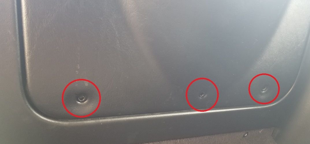

Remove the panel below the steering wheel by first removing the 2 screws behind the dash cosmetic trim panel, circled below in red.
On the bottom of this panel are 3 screws. Remove those also.

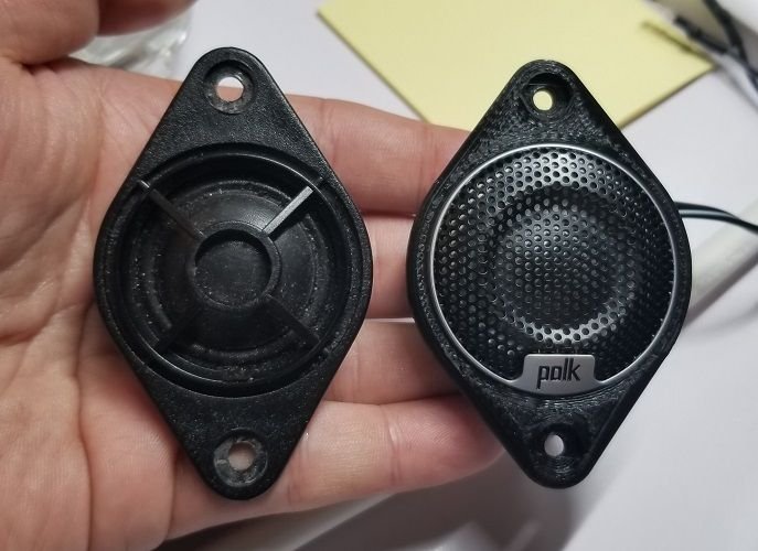

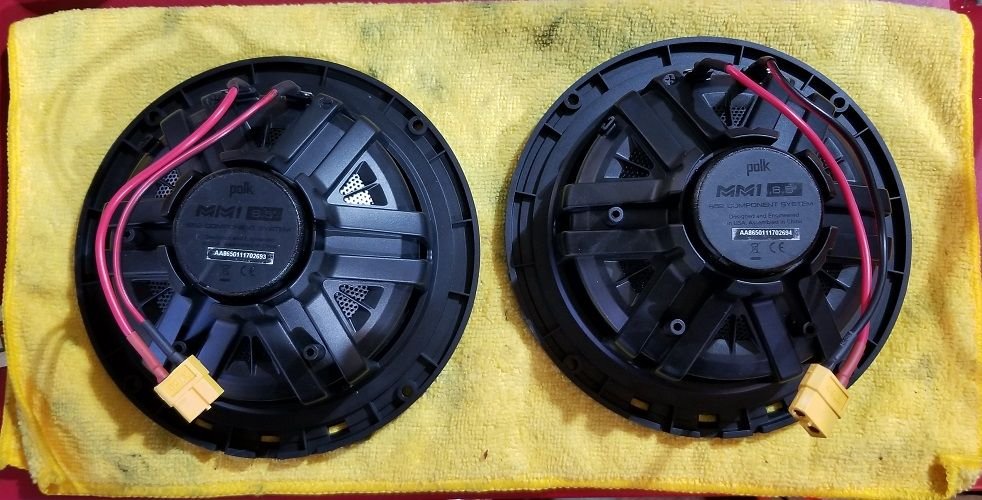

I replaced my front speaker system with a component system from Polk Audio, MM 6502. The 1" tweeters are almost identical in size to the OE tweeters, which was one of my main reasons for selecting this component set. I designed and 3D printed adapter brackets and glued them together.
Here are the tweeters installed using the OE hardware without any modifications to the dash. I, of course, did this on both the passenger and driver sides and ran the tweeter wires down the dash and secured the speaker wires to existing wiring harnesses.

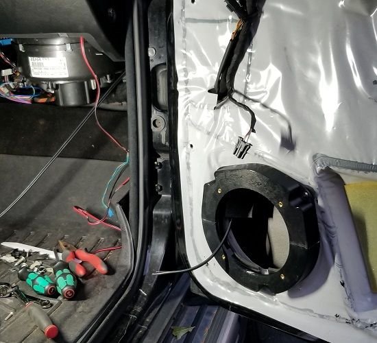

The front door woofer installation, fortunately, is much simpler. Remove the door panels and pull up the weather barrier. As you can see, my weather barriers have seen better days and will eventually be replaced.
I added several layers of sound deadening materials behind the speaker on the inside panel of the door skin. I used 2 layers of butyl/foil based materials, and topped it off with a closed cell foam layer. I covered the entire bottom 24" of the door. I checked the window clearance and did not have any issues.
For mounting the woofer, I cleaned off the speaker mounting area and traced the mounting features using contact paper. The speakers on the front L and R doors are the same part (same mounting locations), but that means the features on the door are not symmetrical/mirrored. They are just slightly different.
Below are the templates I made tracing the features with a black marker on contact paper. I laminated the contact paper onto white printer paper, and then scanned these with a ruler to be able to correctly scale the scanned images in my CAD software.
Designing and 3D printing the speaker adapters was pretty straight forward. The upper surface of the speaker should be positioned 1.5" offset from the door surface, exactly the same as the factory speaker height. Below are all of the components to install along with all the stainless hardware.
I wired in the same 2pin connectors that I've used in a few other places to make the speakers removable without cutting. I ended up using foam and tesa tape on all of the wires in the door to prevent them from vibrating during driving or speaker operation.
I ran the woofer wires through the door wire bundle. This was pretty easy on both sides using a stiffer wire and pulling the speaker wire through. After checking wire lengths and plugging in the speakers, I installed everything. I did not use the supplied speaker covers as they would not fit, nor were they necessary.
I installed the crossovers in areas that they could be relatively easily accessed, as the Polk MM6502 crossovers had an adjustable tweeter setting.

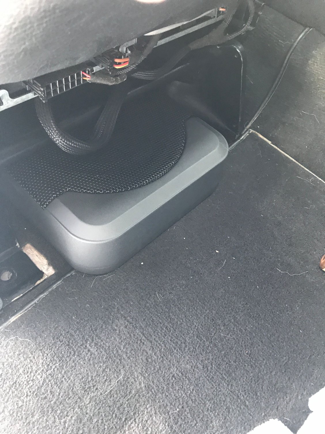

Alternatively, another member on the forums said that you can fit an Alpine PWE-S8 under the Passenger's seat if you remove all the phone electronics and box. This is very attractive as it is an 8" subwoofer + amplifier and connecting it to my system would be very easy overall, as long as it fits. I may look into this during the winter if I cannot find a good way to add the bench subwoofer back into the mix without spending more $.

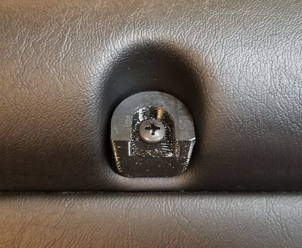

Side project: For my front door panels, the lower door pocket securing screws did nothing. The area was completely broken and didn't secure the bottom of the door panel, nor did it secure the bottom of the door pocket.
I took a few quick measurements and designed/3D printed a few larger washer-ish pieces that fit into the door cutouts. They worked great and now I can attach the bottom of the door panel and actually use the door pockets.

......Alternatively, another member on the forums said that you can fit an Alpine PWE-S8 under the Passenger's seat if you remove all the phone electronics and box. This is very attractive as it is an 8" subwoofer + amplifier and connecting it to my system would be very easy overall, as long as it fits. I may look into this during the winter if I cannot find a good way to add the bench subwoofer back into the mix without spending more $......
I can confirm that this does fit neatly under the passenger seat if one is to remove all the teleaid components and wiring.

Hey Juice,
That is great news! Do you have any pictures of what you removed and the sub in place?
I have my system set up now 'under powering' the front component set at 75W/channel and correctly powering the subwoofer at 150W, but the Kicker 6.75" leaves something to be desired. Adding the Alpine 8" under the passenger seat, with the bass knob installed in the cluster somewhere, is an ideal solution for me so I can install a fixed mounted compressor in the OE sub compartment under the bench seat!

please excuse the dirty carpet and the missing fuse box cover. Like the drivers side there is only one plug that connects the passenger set to the car wiring harness. The teleaid stuff mounted with four little m6 posts, the rear two I left alone and the front two I cut off with a dremel so the sub would sit flat on the carpet. You can also see where I taped into the rear speaker wires.
fits fairly neatly under the seat.

oh and I removed the plastic HVAC fitting and pipe that terminated right under the seat also but thats optional

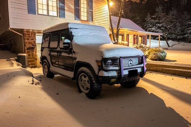

Back in December the G saw its first real snow storm.

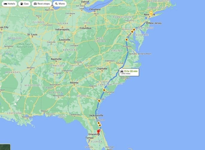

For the Holidays I went to visit family down in Florida. I drove the G down to meet the wife and kid who went down 2 weeks earlier. Surprisingly, the G made a very comfortable road trip car. I did NJ to FL in 16 hours including a 4 hour nap at a random rest stop and 2 hours of traffic around DC. Took the most direct route and hovered around 75mph the whole way down.
Stats for the trip down:

I did, however, get a chance to install my rear view mirror/lcd/backup camera/2ch dashcam. I have another model in my Volvo and have loved it so far, so saw this one on Amazon made by Vantop (H610) and wanted to try it out due to the low price, good specs, and good reviews. The things is GREAT. HIGHLY recommended for any older G owner who wants the safety/convenience of a front/rear dashcam setup, as well as a rear view camera. I really didn't want to add a permanent screen above the central AC vents as I don't think it looks right, so this really solved all of my issues/wants.
Installation is very straight forward. I used an add-a-fuse under the passenger glove box and used a generic dashcam hardwire kit. I ran the video wire all the way to the back cargo area by tucking it into the side of the headliner (I'll fix this later when I eventually drop the headliner to redo the fabric).
