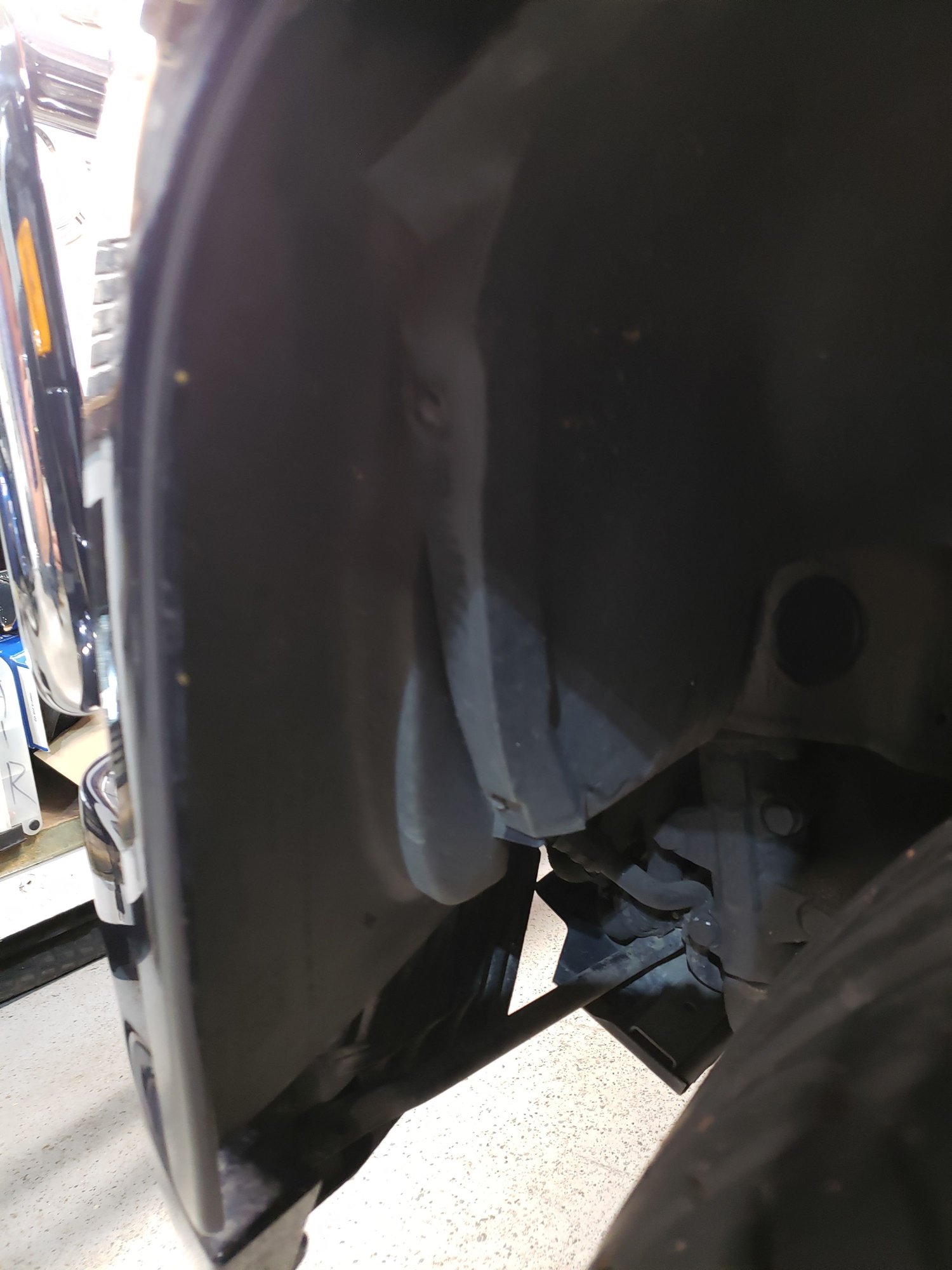

Hi guys,
Pretty new here looking for some advice, I bought a specific wheel and tire setup for my 2014 G63 AMG I bought an AMG replica Wheel 22x10 with a +48 offset
I like the aggressive mud tire look so I went with the Aturo blade XT size 305/45/22
My G is on Stock height and I dont have any spacers, My question is does anyone have this setup and know if it will work, will it rub on turns??
Thanks in advance, I did read some similar threads on here,
new tires, rims havent arrived yet
my front fender well
Current setup im not a fan of
but it looks like the questions were posed on 2002 G wagons and the new new 2019 2020 G wagons
22''x10'' +48 Offset

you'll need 31mm spacers to keep the tires off the inner fender liner and control arms/ body mounts....
BTW those replicas and 22's will run at least 12lbs a corner each more then the heavy stock rims..... highly suggest a wider offset rim that doesn't need a spacer ( another 8 lbs + for the full set and lugs) and a 20" rim....
I used 20x 10.5 forgestars ET that are built to maximize the stance but with a 305 fit it squarely into the wheelwell without any rubbing... they're 23.5lbs and even with a 33.5" tire are less in weight then the stock setup. Well worth the wait and a few extra bucks IMHO.
