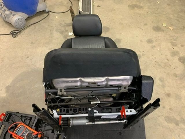

My seat rocks a small amount when accelerating and I have finally grown tired of it.
I pulled the seat out and seems to have found the issue.

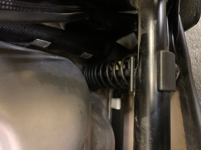

These rear springs appear to be not applying enough upward pressure on the rear of the seat....perhaps a previous owner was a big fella.
Regardless, I can’t seem to find the part number or name anywhere. Leaving for a road trip on Saturday and hoping to replace by then.
Also, has anyone replaced these? Any tips?
Thanks in advance.
You can’t see them in the first picture, but the red is their approximate location. There are 2 springs, one at each rear corner of the driver’s seat.

With that being said, I am proud (actually, just happy) to report that after I disassembling and reassembling the seat, the rocking is gone!!
If I had to guess, I would say I think it was one of the clips circled in blue. When I reassembled the chair, the clips appeared to be re-attached properly, however, I hadn’t heard one of the “snap” into place. It was awkward to get the proper angle, but eventually it snapped in. (And as reported, the rocking is gone...I am not sure how/why it would have been removed previously, but at 12yrs old, I don’t know what the PO have done to it.)
With that being said, I had researched the web a lot on this issue prior to diving in. Some people reported issues with a bolt that they had to wrap tape around, others had loose mounts....It appears there are a variety of issues that can cause the rocking I described.
Once you get the seat out, which is literally takes about 15 minutes, (4 Allen bolts, and a torx for the seat belt), the culprit should be pretty obvious.
In my case it wasn’t so obvious, as after I had the seat out laying on the garage floor, it still rocked, leading me to believe it was those springs.
There are quite a few clips/snaps that hold everything together. I encourage you to tackle the project. I was hesitant to take the seat out, but it couldn’t have been simpler.
