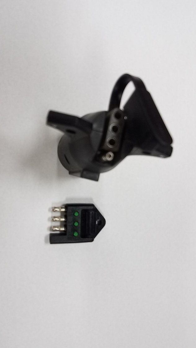

Originally Posted by Floobydust
If that is the case it may be possible to rig a "dummy load" plug for the trailer socket which with then disable LKA for good.
I tested a dummy load comprising a 7-pin/4-pin adapter and an LED tester (about $14 together at Harbor Freight). The LED tester provides sufficient loading such that the G thinks a trailer light system is connected. Being under the bumper, it's hardly visible. Alternately, a receiver hitch accessory brake light could probably be used.

Good idea. So I assume that it worked well and disabled lane departure? If so I guess it also disabled blind spot monitoring? I could live with lane departure but not blind spot...too used it.
I can confirm this disables the blind spot monitor, but I would like someone to confirm that it also disables the lane departure (another post indicates the the GLE disables both with trailer lights connected). I hacked the lane departure system about 6 months ago such that it automatically shuts itself off, and reversing the hack in order to test the trailer lights is not practicable. I don't need this trailer light solution now, but I'm curious to know if it kills the lane departure. I'm too paranoid to rely on the blind spot monitor and can't unlearn looking over my shoulder, so I'd certainly use the trailer light plug-in if not for the hack.
