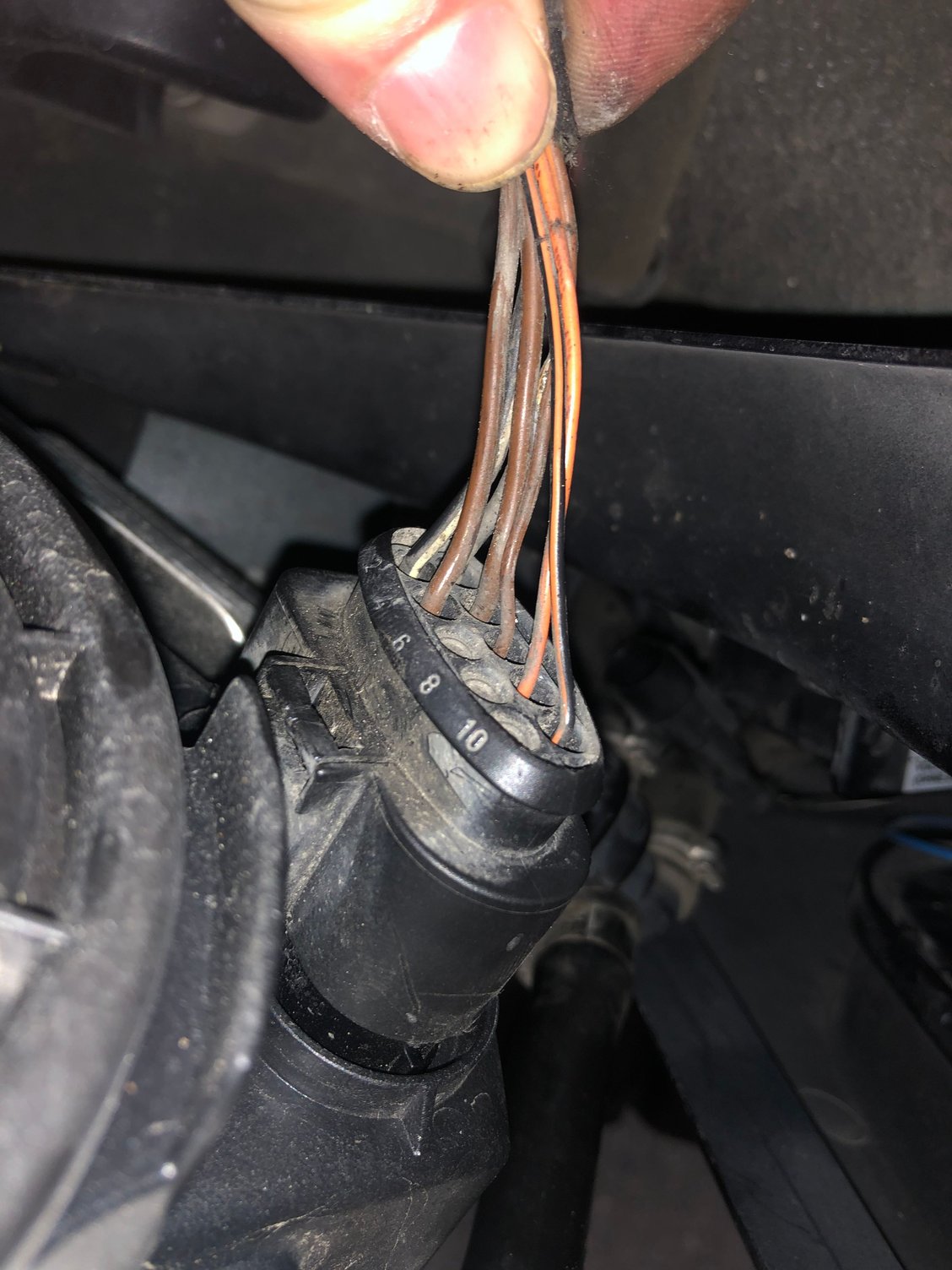

I have a 2014 G 63 that was damaged in a vandalism episode. I'm trying to rebuild. The headlights were stolen and the wires slashed. i have gotten the OEM headlights and OEM plug, but I need to know "WHICH color wire goes to WHICH pin"?
Does anybody have a picture of how their wiring harness to headlight plug connection looks. I am attaching the 7 wires that I see coming out of the harness, where it got slashed. There is an additional cable that has 2 wires and i am guessing that it is for the DRL.
Would someone have these pictures or able to look it up on their W463. I will really appreciate it. i know it involves work, but I am kind of stuck- and need help.
Headlight cable splitting into 7 wires- Need to know which wire goes to which pin on the connector

Your second photo - brown is ground, the other wires is (+) for either DRL or parking light. On mine I have a connector with 3 wires (brown, yellow/blue, and red) -mine was unplugged and it caused 'Front Left Parking' light error and 'Front Left DRL' light error. I think they were maybe both plugged into the 5 LED DRL bar below the headlight. Mine was removed bc I have a 2015 Brabus G63 so my wiring's all been modified. The headlight wiring I can get you a photo of the back of my right headlight later today.

i also took a video, might show better clarity, you can DM me and i'll text or email to you
headlight "even" side of pin
headlight "odd" side of pin
parking light

that is very helpful. I will go back and see if I can wire it up in the same fashion. That picture makes it much simpler.
if you don’t mind sharing the video that’ll be even more helpful.
I’ll dm you.
thanks

just wanted to give a big shoutout to Alex.
i was able to get my headlights working thanks to your pictures and videos.
i am still working on the DRL and the Parking light but at least the headlights issue is sorted out- no errors. THANK YOU.
