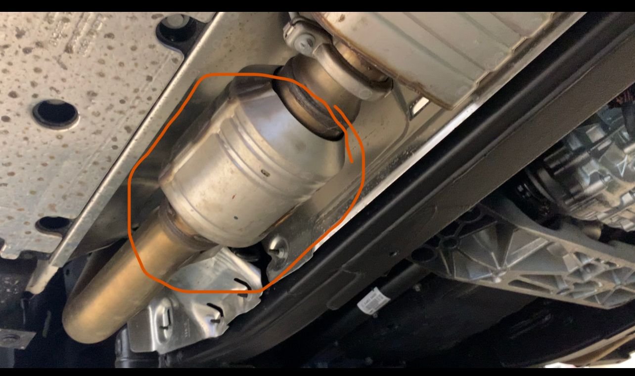

Ok, the AMG Gtr is obviously different but as far as components is the same. We cut the cat on each end of the pipe and welded a pipe in place, as simple as that. I know they are secondary cats because you can see the tiny cells on them. They are small.
For the G ( I haven’t cut them yet ) you can see on this video the long exhaust muffler and shortly after that is the secondary cats ( note it has no sensors ) the primary cats are located closer to the engine like you mentioned and it’s really hard to access them in the event you want to replace them and it would most likely cause you check engine lights if you don’t tune it for those modifications.
My opinion is this; it’s a no brainer if you want louder exhaust start with this easily reversible modification and if you feel you want more then replace the muffler.
I had two cayenne turbos in the past and did the same modification. Best bang for the buck. Only on my second cayenne I installed a tubi muffler and regretted Quicky. ( too much for a daily driver )

Not sure if the video was uploaded but basically this is the secondary cats located next to the big muffler.
The primary ones are higher up very close to the engine almost towards the hot V of the engine.

Ya that's perfect no O2 sensors near that way up high by the first cat, shouldn't be more then $120-$150 done on both sides simple straight piece of pipe 2 cuts and welding. Seen some videos on youtube of other amgs.
