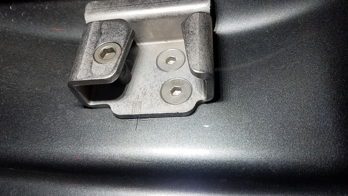

Seriously, inspect the striker that's mounted on your door frames. My 2019 G has alignment scribe marks (see photo below) on both the pillar and the striker. Check all your doors to see if they're all the same with respect to these alignment marks, and if there's any evidence of shifting (or if any of the bolts are loose). Judging from the presence of these scribe marks, I would assume some adjustment is possible. Mine requires a 5mm hex head drive to fit the bolts. If yours is similar, try moving the striker inward one tick mark and see if this improves the closure situation.
