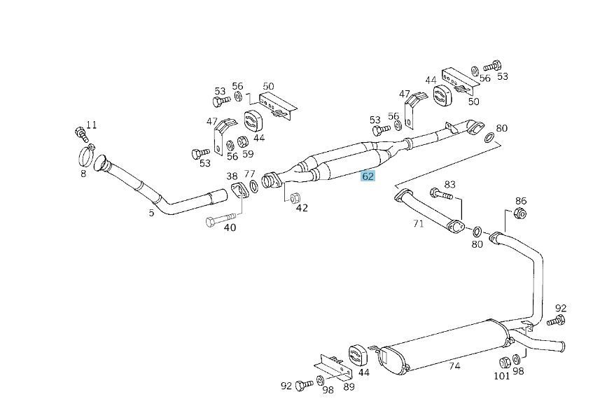

I'm looking to install a DPF on my G300 TD
The model I have is G 300 3.0 Turbo diesel (463.330, 463.331) (130 KW / 177 HK)
I found this DPF which fit the car, but its not approved by TÜV so it won't be registered in my country (Denmark)
https://www.sk-handels-gmbh.de/shop/...enz-300-g/1350
Im curious to hear if any one have tried to install a DPF from another model? or have knowledge about where to find a DPF that would fit with right documents.
/LekerGD300

hi, the reason is that the city i live in has environmental zone. EURO4. So with a DPF on the car I can drive there .

Seems I found a solution this is a original part DPF
OEN A463 GA4904214
