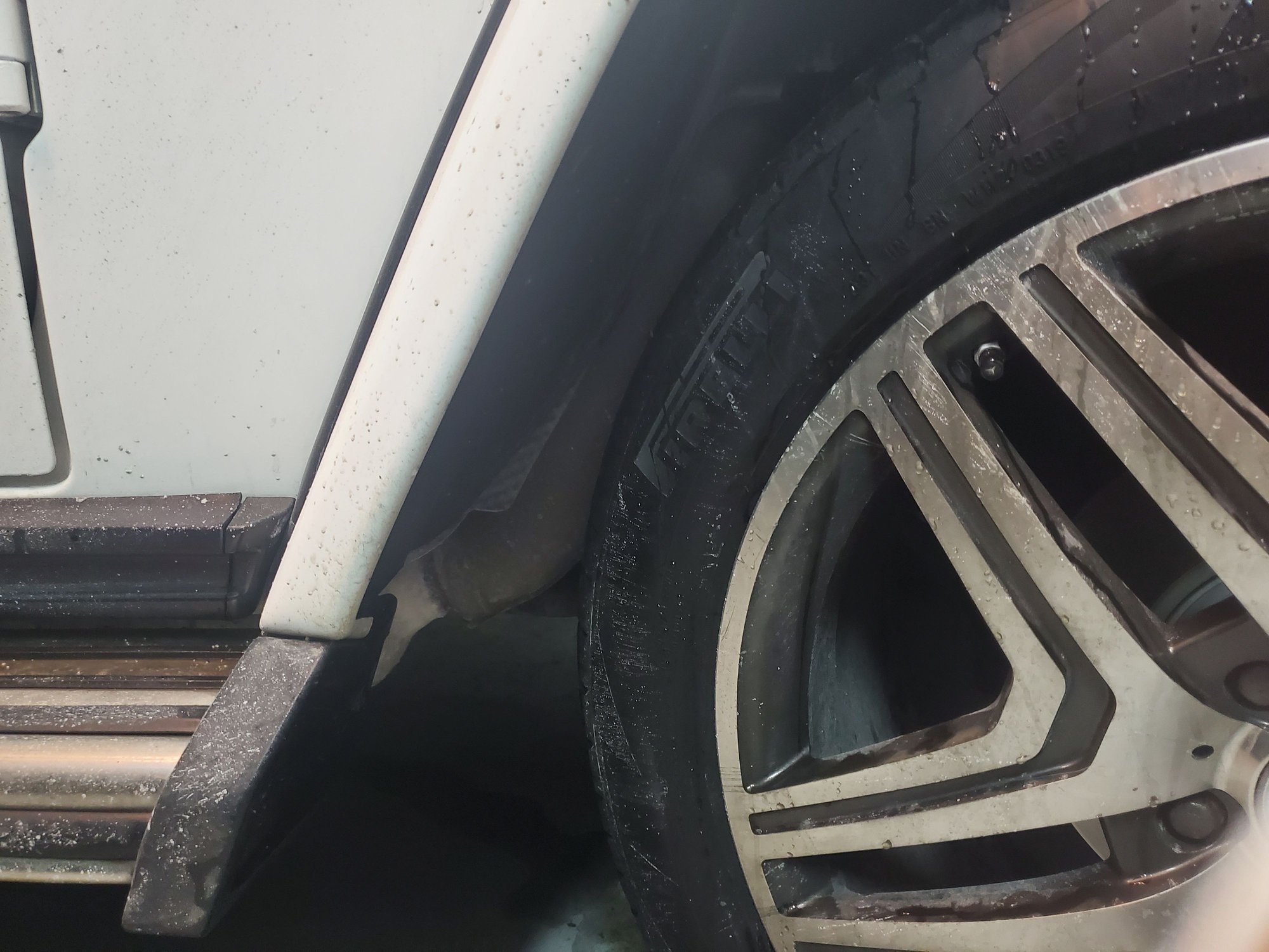

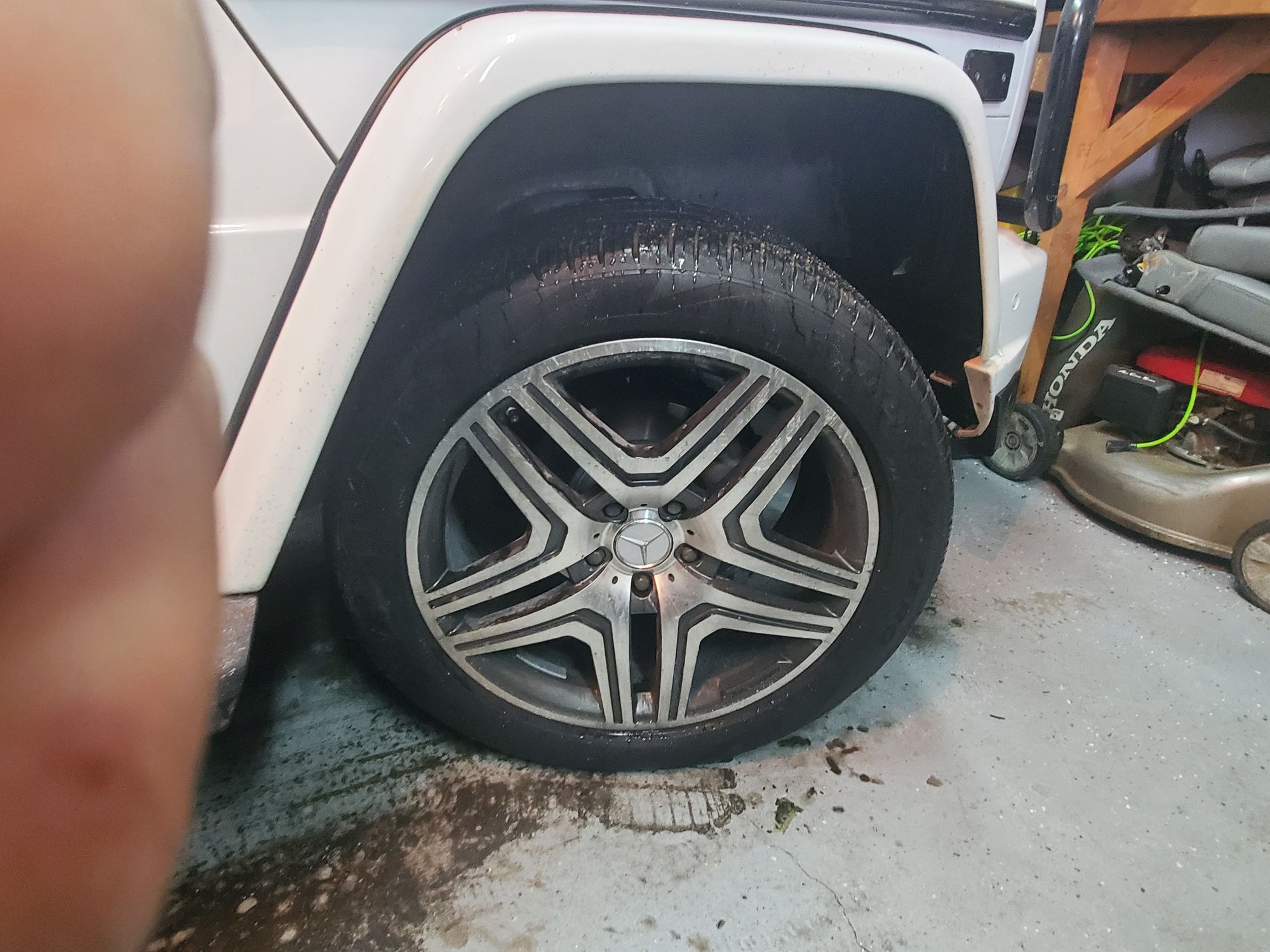

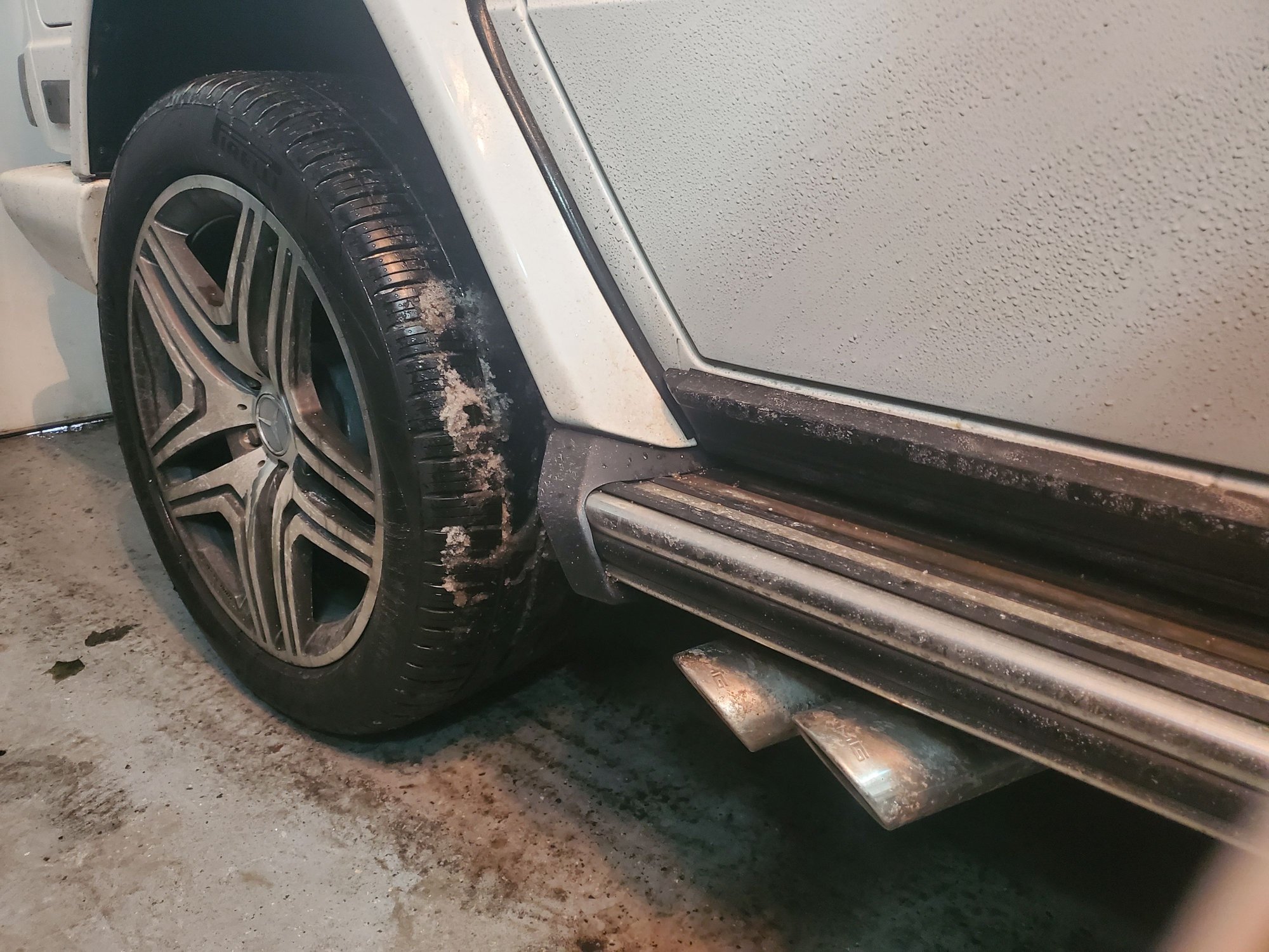

I use 315/40/21 and it's amazing.Fits perfect.Tires Michelin Rims OEM R21 AMG
really ? no rub when going full left / right / U turns ?
thank you
I read that G550 has a little more wheel room than the G63 but if you get no rub at all i`m willing to buy the tires and test how it goes
Old Feb 5, 2022 | 12:54 PM
Andrew G550's Avatar
Joined: Jul 2021
Posts: 9
G550
thank you
No,everything is fine,the car more comfortable now and looks great

iIcan confirm that 315/40/21 fits with no rub or other problems on G63amg
