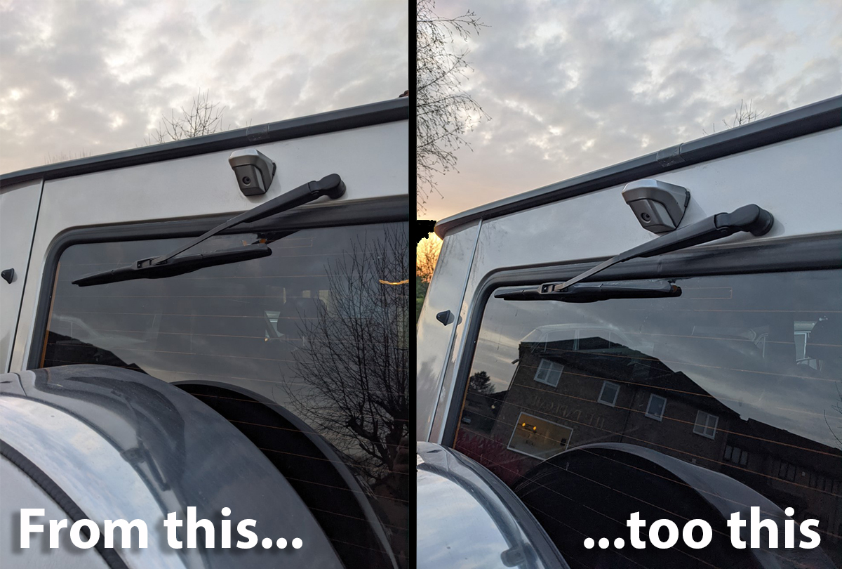

Just some clarification as to what this is about:
HOW TO: Resetting Default Rear Wiper Position-zojv2jn.jpg
Older members who have owned Mk1/2 Golfs may have done somthing similar, many many moons ago

What circumstances result in this offset position?
Old Mar 22, 2022 | 09:41 AM
KILLERHERTZ's Avatar
Joined: May 2003
Posts: 301
Likes: 66
From: Englandshire
2013 SL63 AMG
Some just came like this from factory...
Wasnt a problem until the high-level brake lights appeared in the mid 90s.
Old Mar 22, 2022 | 09:50 AM
Limey Hooligan's Avatar
Joined: May 2017
Posts: 459
Likes: 301
From: Plano, Texas
2012 G550 - Capri Blue Metallic
Mine currently seems to be halfway between the two pictures above - a little lower than horizontal but not quite enough to block the brake light.
But it seems an easy fix, so I'll keep it in mind for later if needed!
