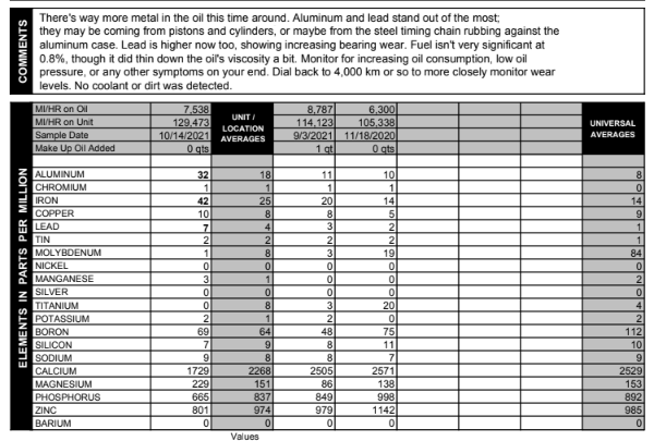

I have owned it for 2 years, from 100,000km to now 133,000km.
Universal Averages: Alu 18, Iron 25, Lead 4
1st report: Alu 10, Iron 14, Lead 2
2nd report: Alu 11, Iron 20, Lead 3
3rd report: Alu 32, Iron 42, Lead 7

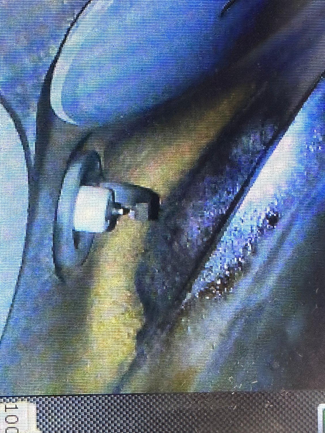

The engine sounds great. However I have in the last 10,000km started experiencing oil consumption. Recently 1L after 3000km. No other issues to date.
Sadly I did not take many photos but here are the couple I did. I would say 3 pistons looked clean like this one, 4 were fairly dirty, and the dirtiest one is shown below.
Cleanest piston
Dirtiest piston
