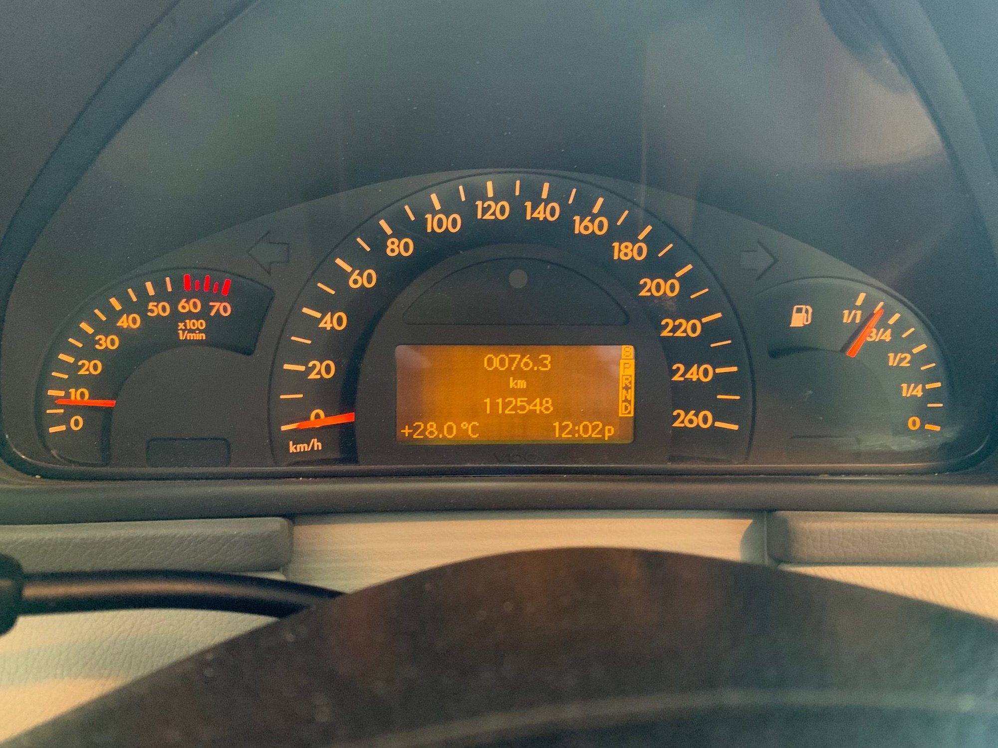

Hello
Anyone have any thoughts on solving the problem of a dim instrument cluster? At night I can clearly see the digital read out but during the day I can see almost nothing.
Any tips or tricks for fixing this?
05 G55
Thanks

I don't think there's any fixing it. You can replace the screen though. My screen is exactly how you describe.
I've purchased a replacement screen from this Amazon vendor, but haven't installed it yet.
Tanin Auto Electronix Replacement LCD Screen | Mercedes C-Class W203 & G-Class W210 | Instrument Cluster Display Tanin Auto Electronix Replacement LCD Screen | Mercedes C-Class W203 & G-Class W210 | Instrument Cluster Display
Brand: TAE
Price has gone up since I purchased in July. I got it for ~$75.
There's a video on YT for installation but I don't have a link for it.
