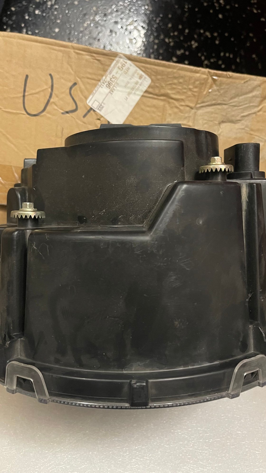

Old Nov 5, 2023 | 09:46 PM
xxaarraa's Avatar
Joined: Jul 2006
Posts: 883
Likes: 93
Multiple
Mine looks like this below. Does that rod turn somehow?
