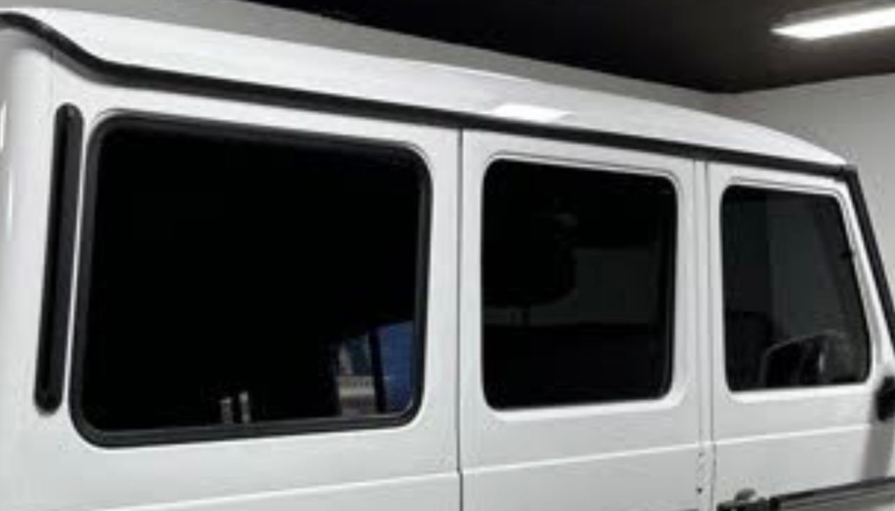

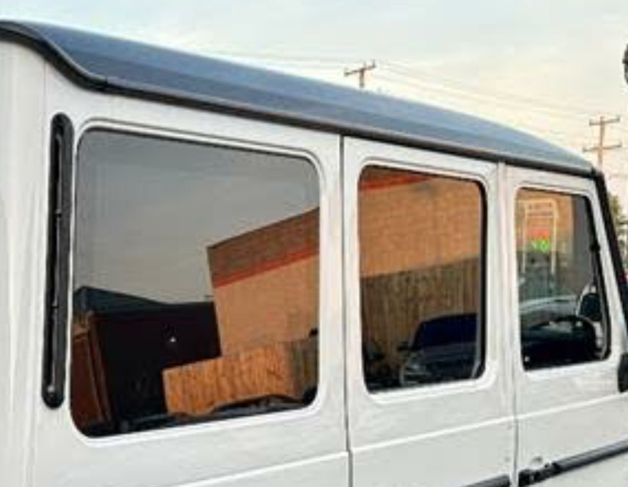

2018 is determined to had better brake pedal angle, making it more comfy. Little more sound deadener. A exterior diff between them all and only on the 2018 on the cargo area side glass it no longer has the thick rubber surround. It matches the way the doors look. It’s a major subtle diff but once you see it to me it was a big diff. I am unsure what they changed to allow for it and if an older one can be retrofitted to that style. I really need to ask my buddy to owns a certified MB repair center if he can tell.

2018
2002-2017

I didn't notice the antenna thing but I did actually spot the window seal change, it was actually something I thought was a bit odd in the older model.
