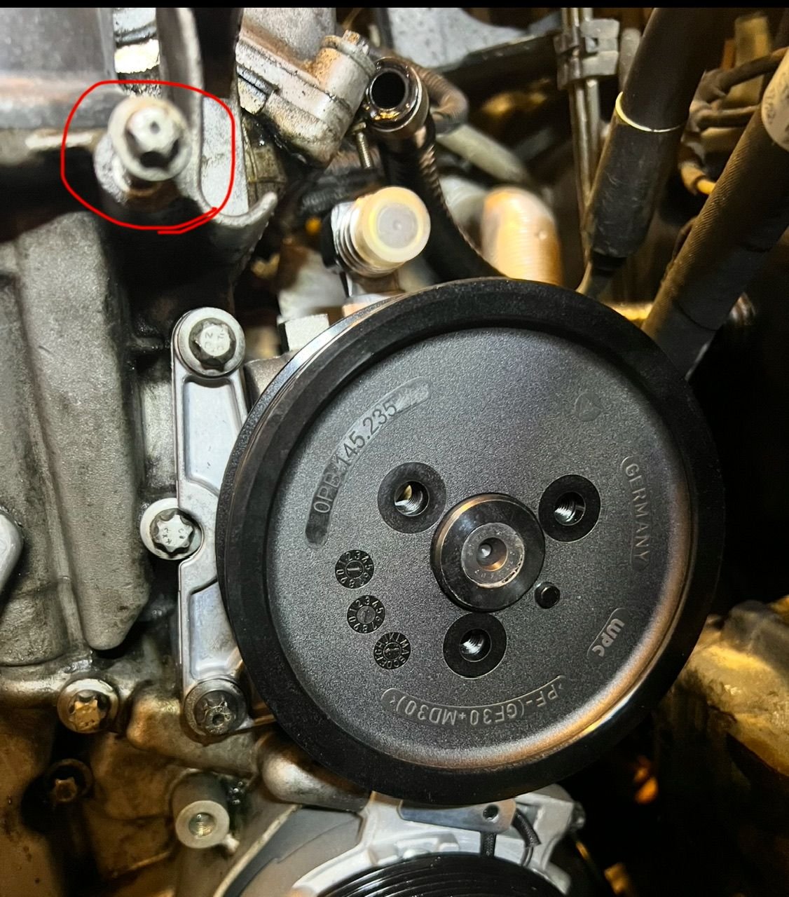

Howdy, recently replaced my SP reservoir and realized the E8 bolt did not "over tighten", it just stripped the threads on the back end of the bolt hole. Can still get it on/off but the back 1/3rd is definitely stripped.
Where specifically is this going into? Is it something that will be replaced if I do the oil filter housing or steering pump itself?

That bolt threads into the casting of the timing case. Don’t think you want to go replacing that. However you could use a nutsert. Look closely at this photo and you’ll see there appears to be a brass bushing that this
bolt is threaded into.
