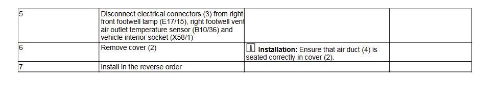

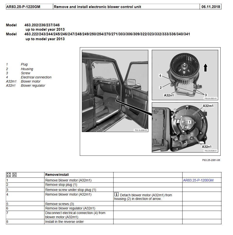

Well... so one day, someone looking for this will find it...
