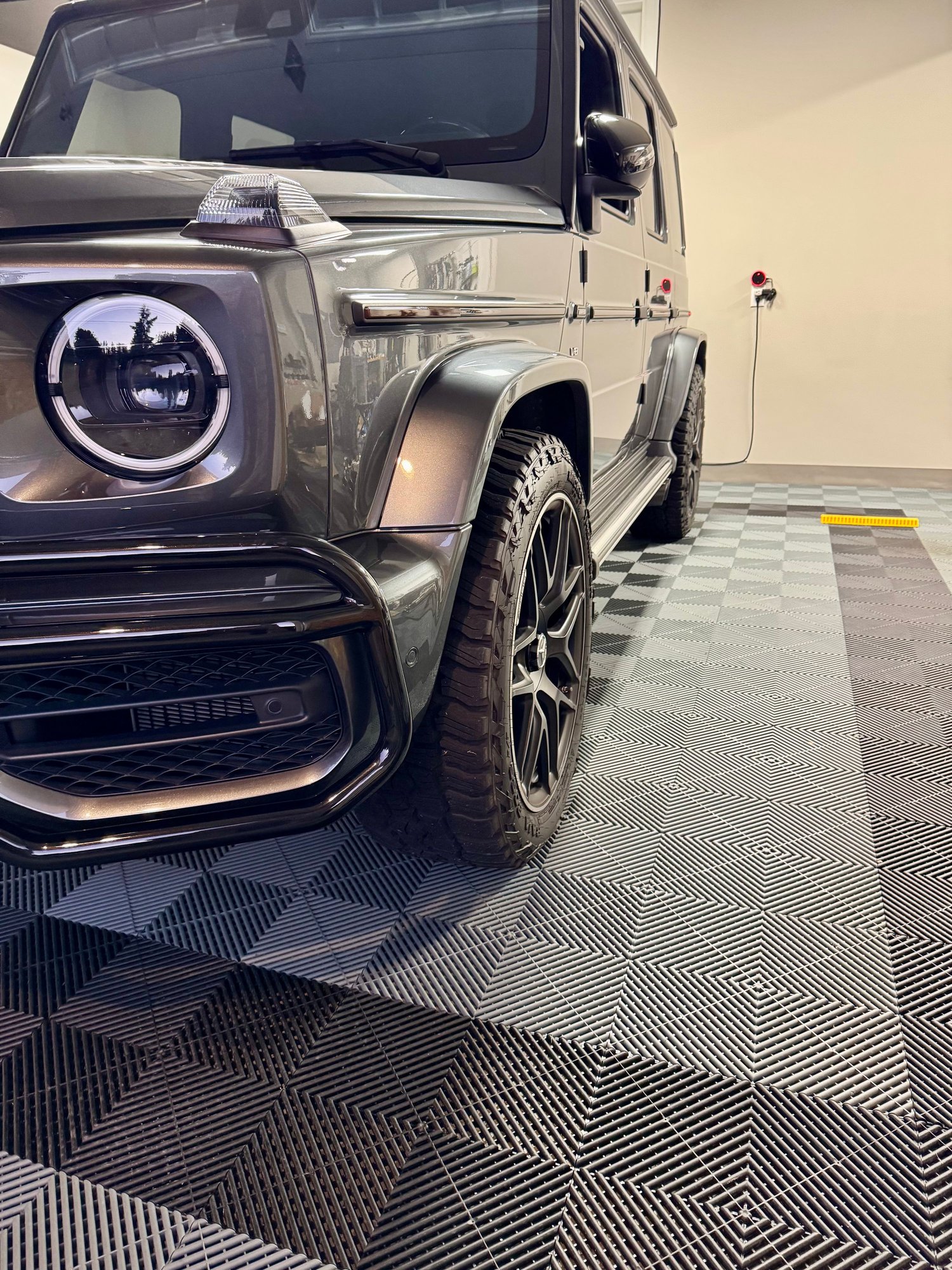

Just swapped out the OEM tires for Mickey Thompson Baja Boss A/T 285/45-22. I'm now looking to add 23mm H&R spacers. Can anyone confirm whether this is the right p/n? 46958410SW

As for the spacers, I believe those are the correct ones. I was looking into doing 31mm h&r spacers. From my research, the 31mm seems to make the wheel flush with the fender. Both will say not compatible with your car but I spoke with an h&r representative and he told me that if it fits the old G it will fit the refresh too.
31mm part # 62958410FW
Here are some pics I found of 31mm spacers with oem tires

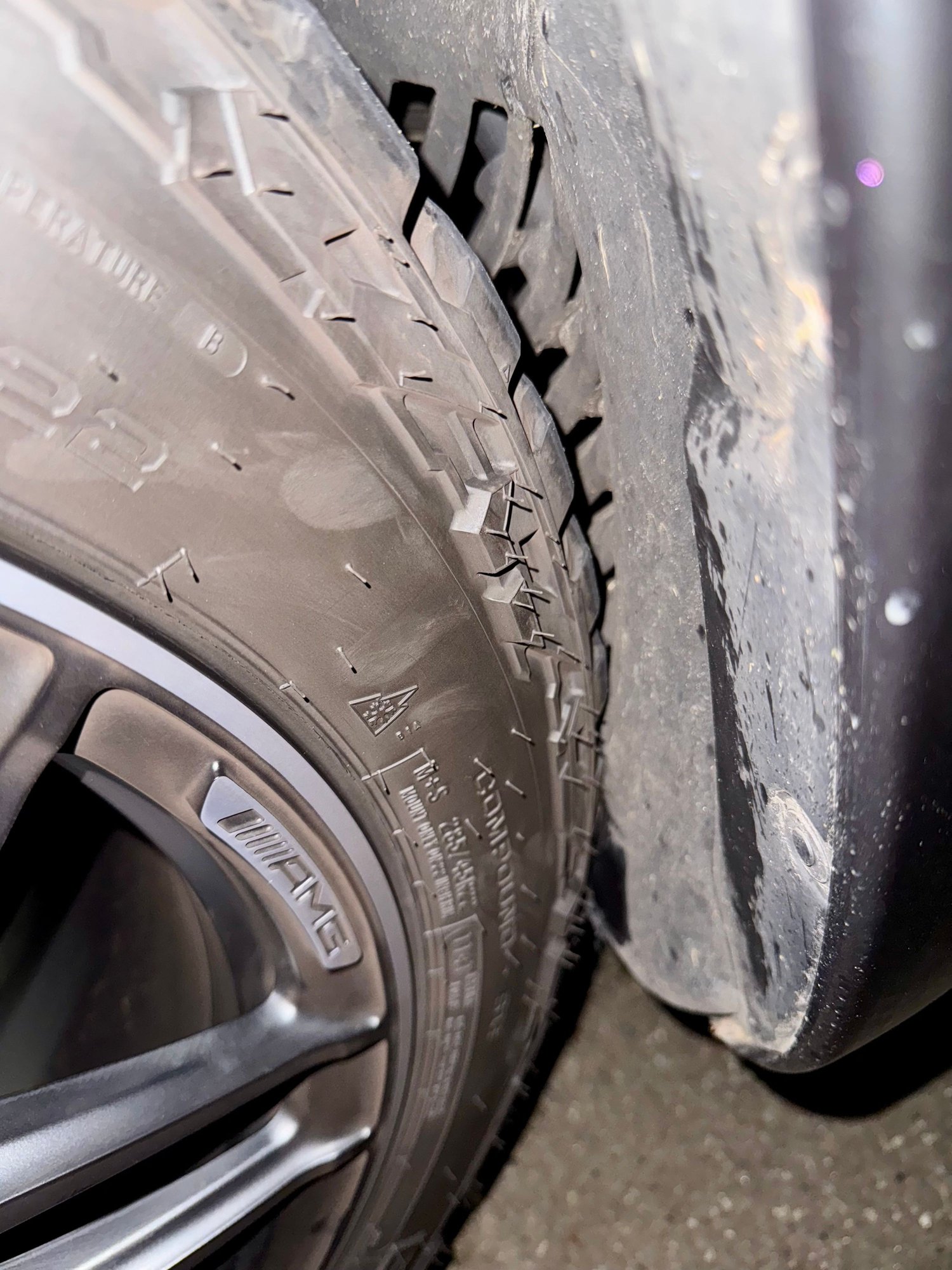

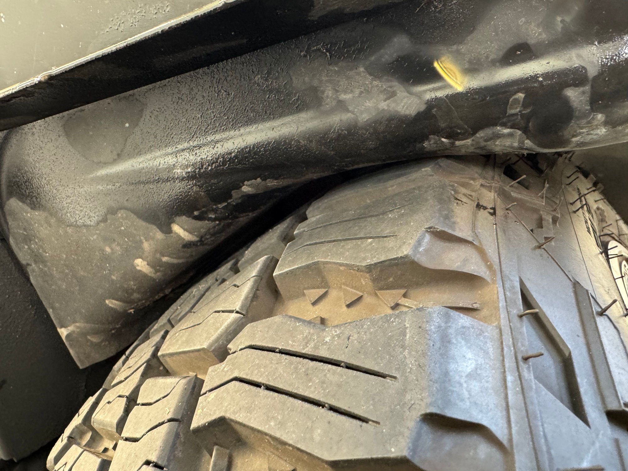

31mm spacers rubbing
I put on H&R 31mm (P/N:62958410) spacers all around. I think it looks great but now I am rubbing the front fender liner. So I am considering going with the 23mm P/N: 46958410SW but just on the fronts. Does anyone know what size bolts I need? I recall someone saying the stock bolts are 45mm which would mean I need to order 68mm bolts which I believe are H&R P/N: 1456802. Does that sound right?

Just replied to your DM, and then saw this post. I think you are correct in your math. If using the stock wheels, and you add a 23mm spacer then you need 23mm longer bolts than stock. Measure your stock bolts to confirm (just the threaded part to the start of the taper). I can't recall if the 23mm spacers are through bolt, or if they have offset lug bolts to mount them to the hub first, and then bolt the wheel to the spacer.
