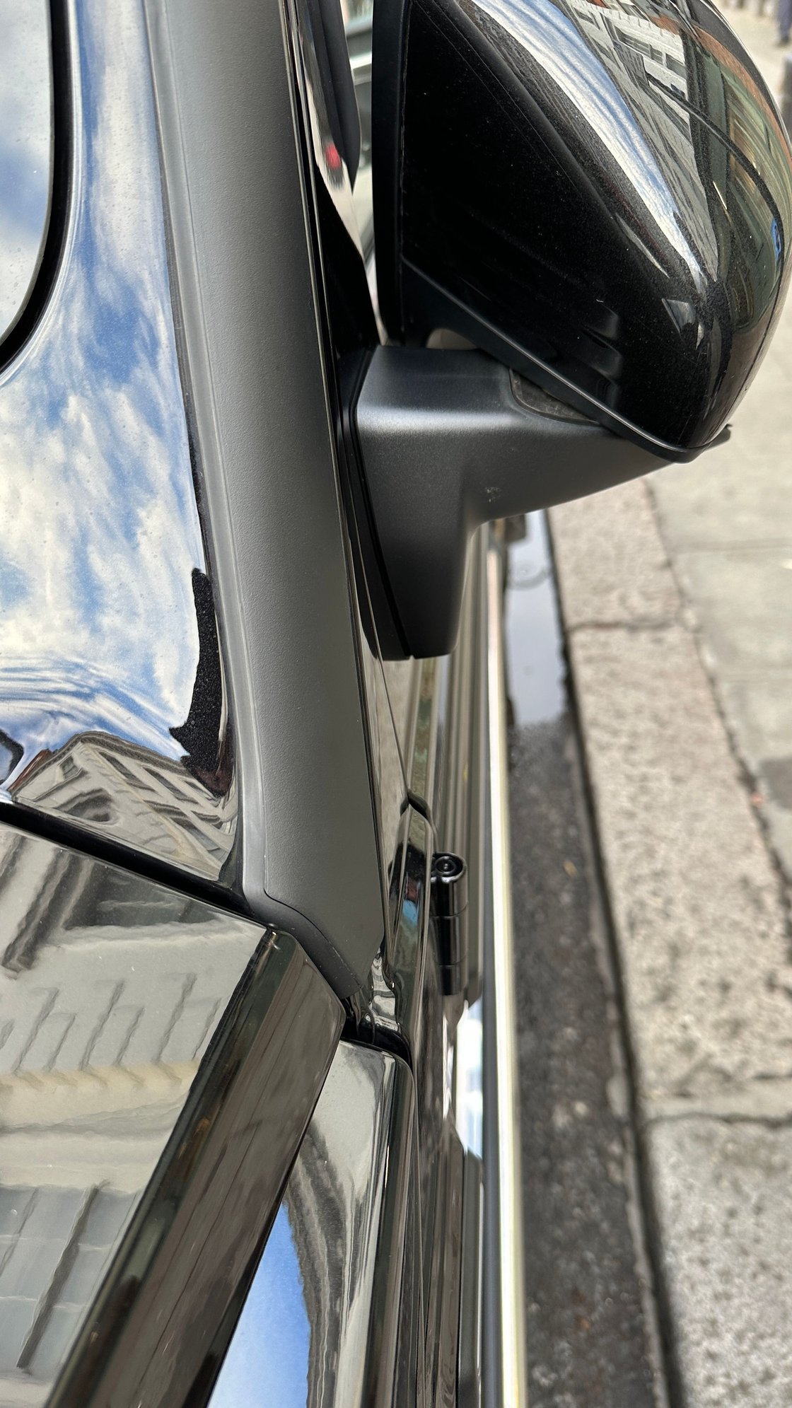

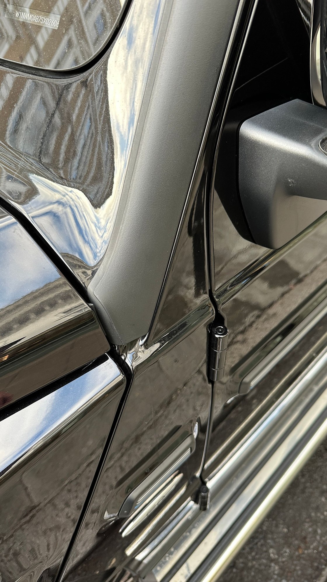

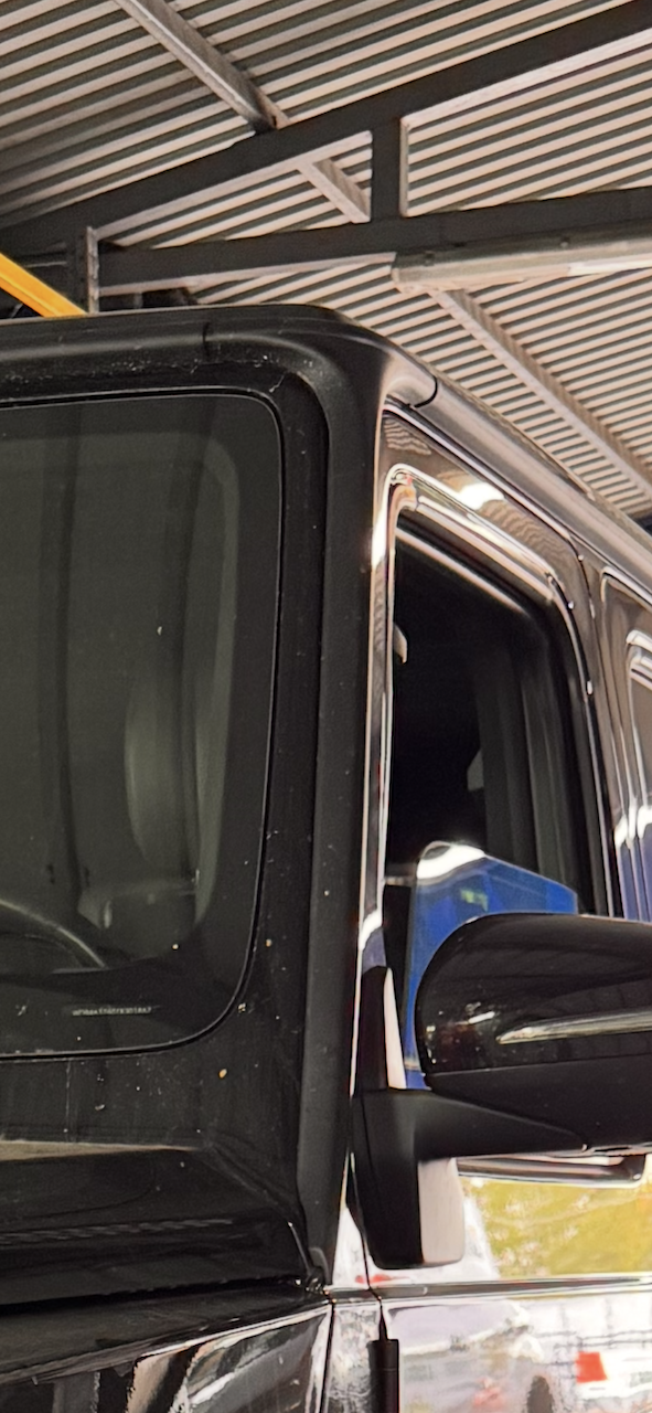

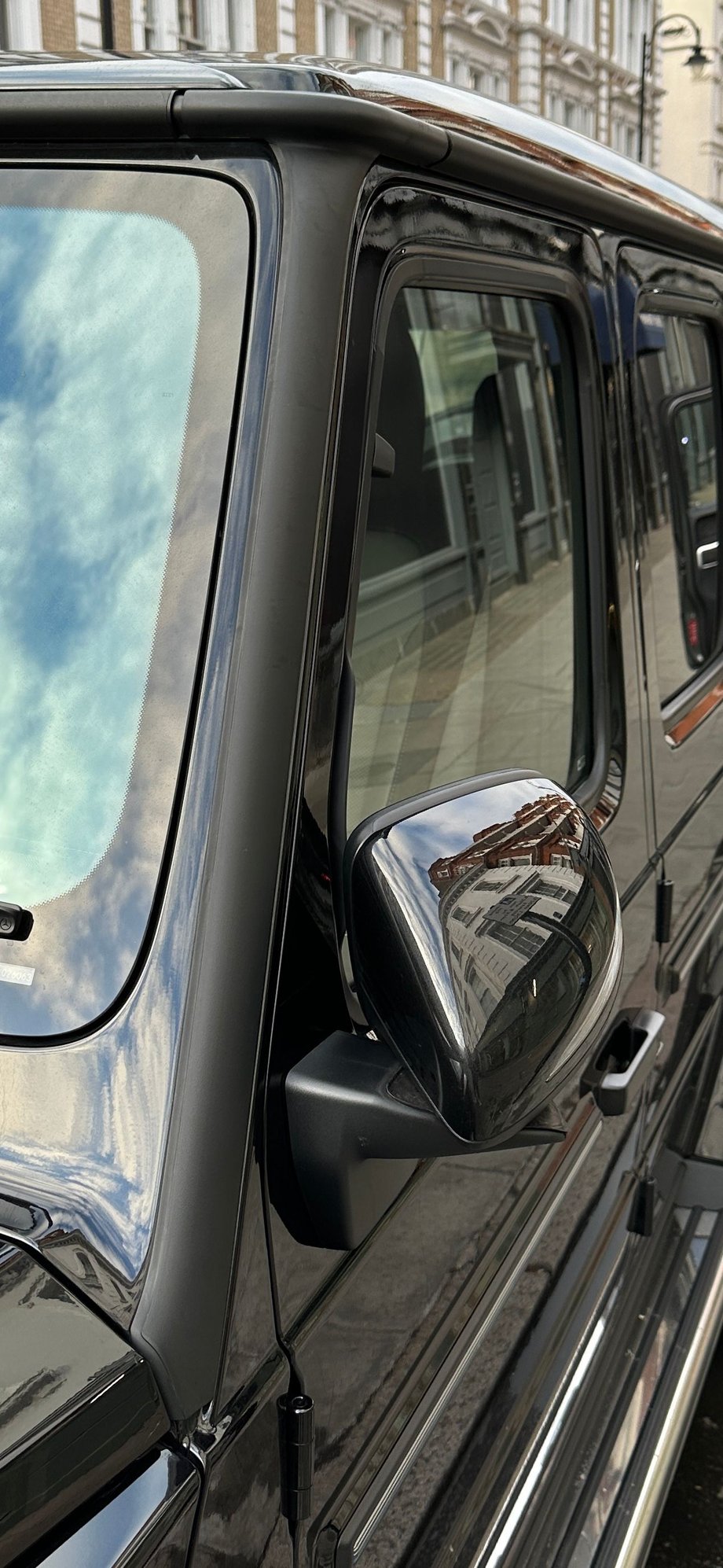

W463A
W463A
W465
W465
As seen above, we can observe the difference in the A-pillars. In the facelift model, the design is more refined and fits seamlessly with the car's frame, whereas in the pre-facelift version, the plastic trim extends from the top in a bulkier design. The question is whether this swap is an easy fit and installation to update the old design with the new more aerodynamic one.

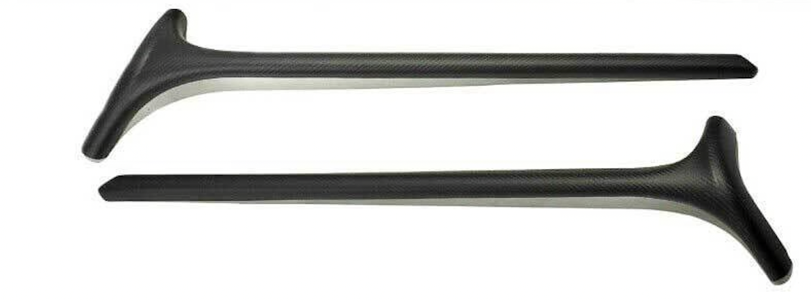

Following the unanswered topic, I discovered something very interesting: the aftermarket W465 A-Pillar Carbon offered by Gwagenparts is not compatible with the W463A. This raises a new question: could the new model have an indentation in the metal to allow the plastic to fit inside?
https://www.gwagenparts.com/product/...-g-wagon-w465/

I contacted gwagenParts and received an update regarding the A-pillar dry carbon parts. They informed me that the reason these parts do not fit the W463A is due to differences in the structural designs and dimensions between the W463A and W465 models. The W465, being a newer generation, has updated bodywork and frame specifications that are not compatible with the older W463A. This includes variations in mounting points and overall fitment of certain body components, such as the A-pillars.

Here is a demonstration of how the A-pillars look — you can see the differences in the angles and curvature. W463A Above - W465 Below
W463A
W463A
W465
W465
W463A
W463A
W465
W465
Yes, it's entirely visible when you put the 2 cars next to each other, the entire metal contour and indentations for the trim in the A-pillars are different! You would need major major body work on the A-pillars to fit those pieces of trim!!
