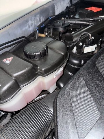

Here’s what’s odd:
  • When the car sat overnight, the coolant level was below MIN.
  • Drove to buy coolant, and suddenly the level read normal again.
  • I topped it off to MAX just in case.
  • A few hours later, the check engine light cleared on its own.
The car drives and runs perfectly—no noticeable performance issues. This just has me on edge because it feels like something is off, but no real symptoms yet.

Car sitting for hours - coolant LOW
AFter driving car to buy Coolant - Level was NORMAL ( no coolant added)

Hi,
I think that's normal. I Googled it, and found this explanation:
The radiator fluid (coolant) level does change depending on engine temperature. When the engine is hot, the coolant expands, causing the level in the reservoir to rise. As the engine cools, the coolant contracts, and the level drops back down.
This change is normal and expected due to the thermal expansion of fluids. That’s why coolant reservoirs typically have separate "cold" and "hot" fill marks, indicating where the level should be when the engine is at different temperatures.
If you are checking the coolant level, it should be done when the engine is cold, as the "cold" mark reflects the proper level for a non-running engine
