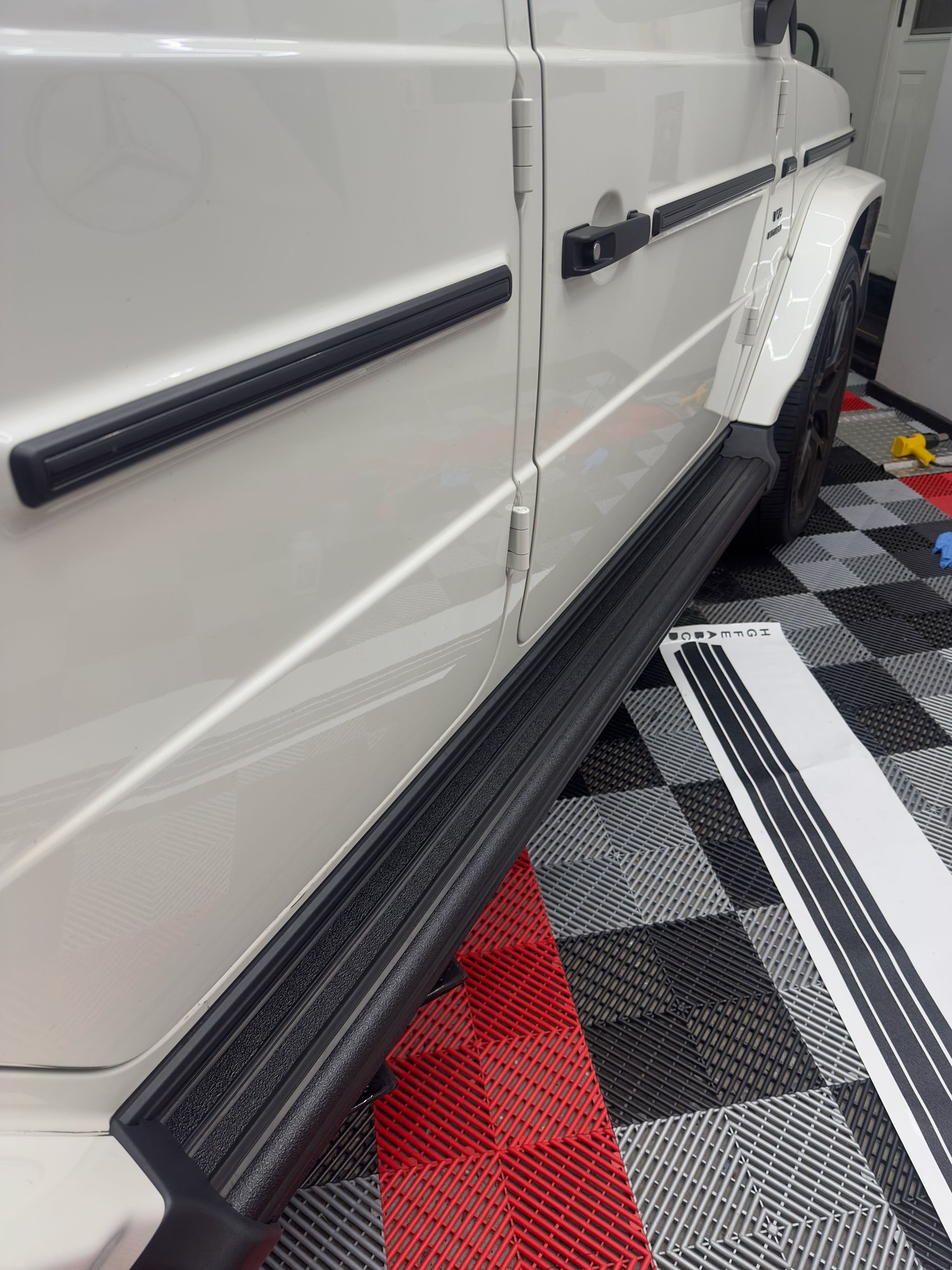

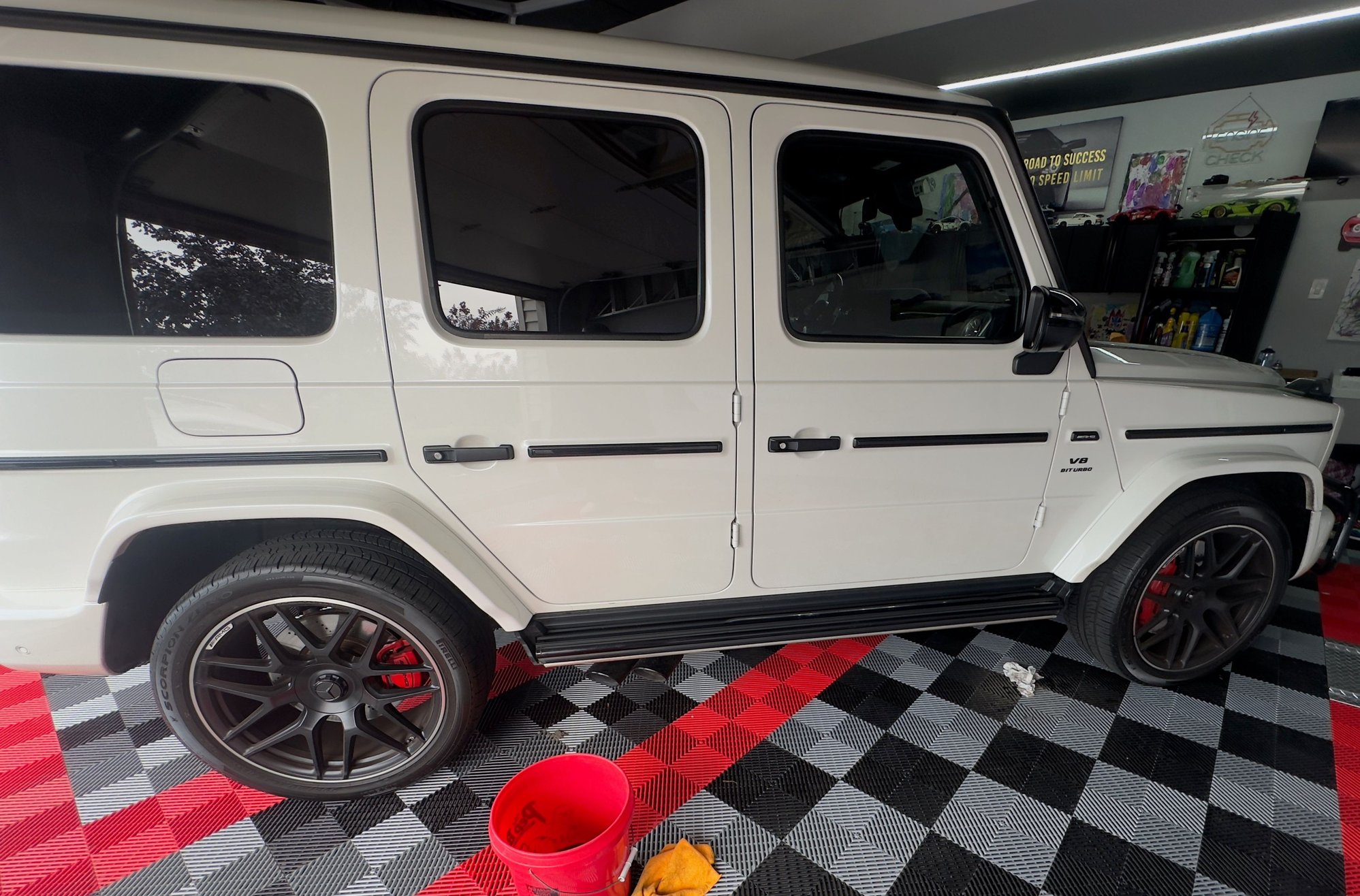

I recently picked up a ’21 G63 and have slowly started making a few custom touches. The truck has a “stormtrooper” look—Diamond White (799 - G manufaktur diamond white bright) with AMG Night Package black accents. The previous owner had wrapped the side steps in gloss black vinyl, but it was starting to show its age, so I decided to refresh the look.
After some research, I landed on the Sliplo blackout kit. The older version of the kit came in two half-pieces, but the updated version now comes as a single, full-length wrap for each side. Installation was straightforward—just a matter of removing the rubber gaskets, cleaning the application area with soap and water, then wiping it down with 70% isopropyl alcohol. I dried the surface with a lint-free microfiber cloth before fitting the kit underneath the gaskets.
The adhesive had plenty of give, so if I placed it slightly off, it was easy to reposition without any issues. Once everything was lined up, I used a heat gun to ensure it was properly bonded and left it to cure for 24 hours. I handled the install myself with no problems and would rate the process a solid 4/5 in terms of difficulty.
For anyone looking for a clean, reversible way to black out their side steps, I’d definitely recommend the Sliplo kit.

I see you took the plastic end caps off (which I assume you are referring to as the rubber gaskets), but you left the rubber tread pieces in place, correct? I assume each strip of vinyl is individual, and you place them between each of the rubber tread pieces, correct? The kit is not just one piece of vinyl that lays over the chrome as well as the rubber treads, correct? How long did it take you to complete both sides?
Thanks for posting the write up. Always fun to see people posting their DIY stuff.

Apologies for the earlier terminology mix-up. I removed the end caps along with the innermost rubber tread (gasket), then placed the vinyl strips between each tread. Once the vinyl was in position, I overlapped the tread above it for a cleaner finish. It’s done with multiple vinyl pieces rather than one continuous strip, and if you look at the pictures you’ll notice the cutouts.
The whole process took me about two and a half hours, though I paused a few times to help the kids with homework. I actually enjoy these small DIY projects—it adds a personal touch and gives me that sense of pride in ownership that comes with being a car guy.

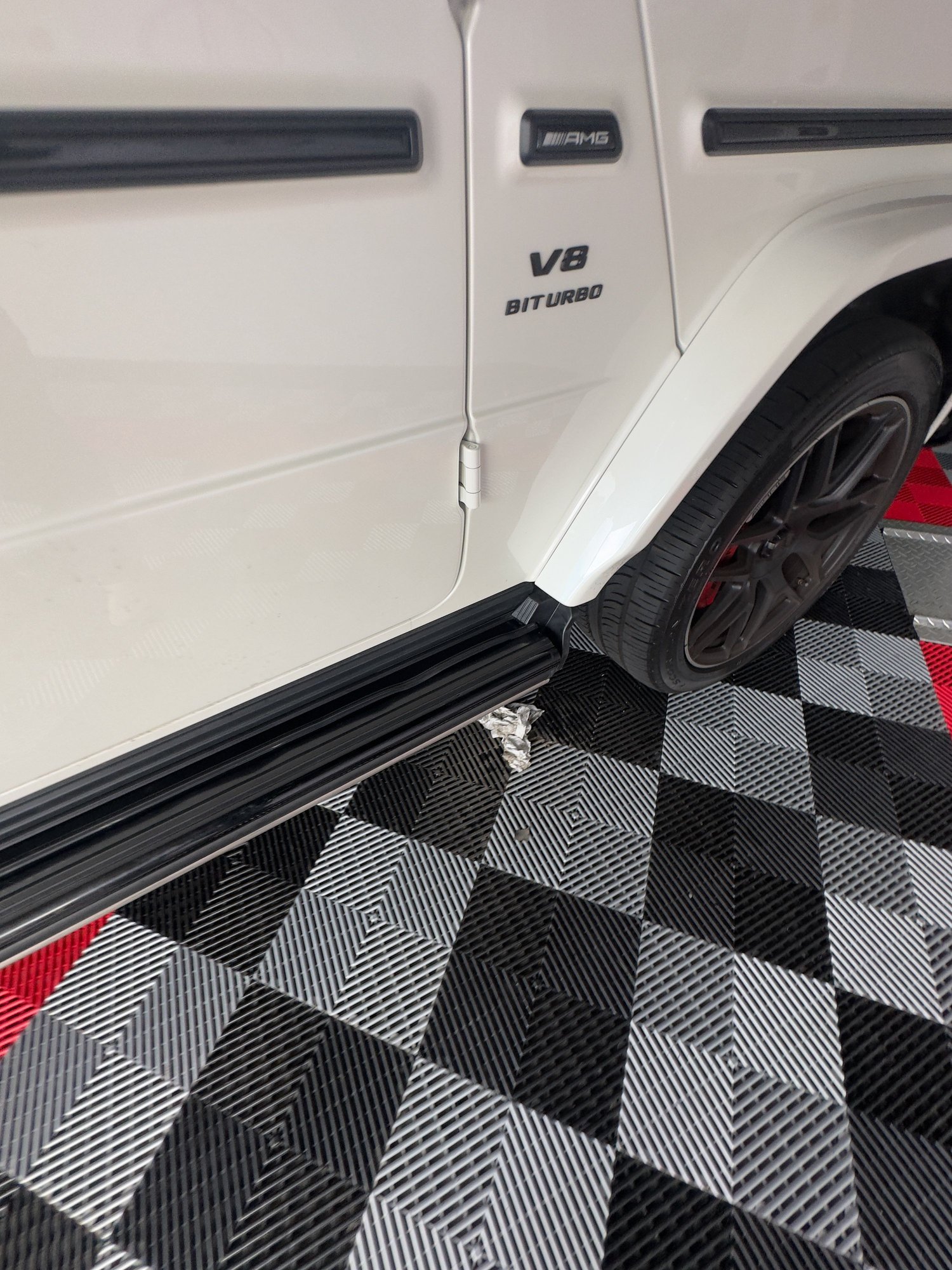

Just sharing mines as well, once again thanks for the reminder looks much better and a very low budget mod!

Great job, Jacob! The install came out clean and professional. I think the blackout vinyl with the texture compliments your Brabus carbon fiber side blades and matte paint. Looks great.

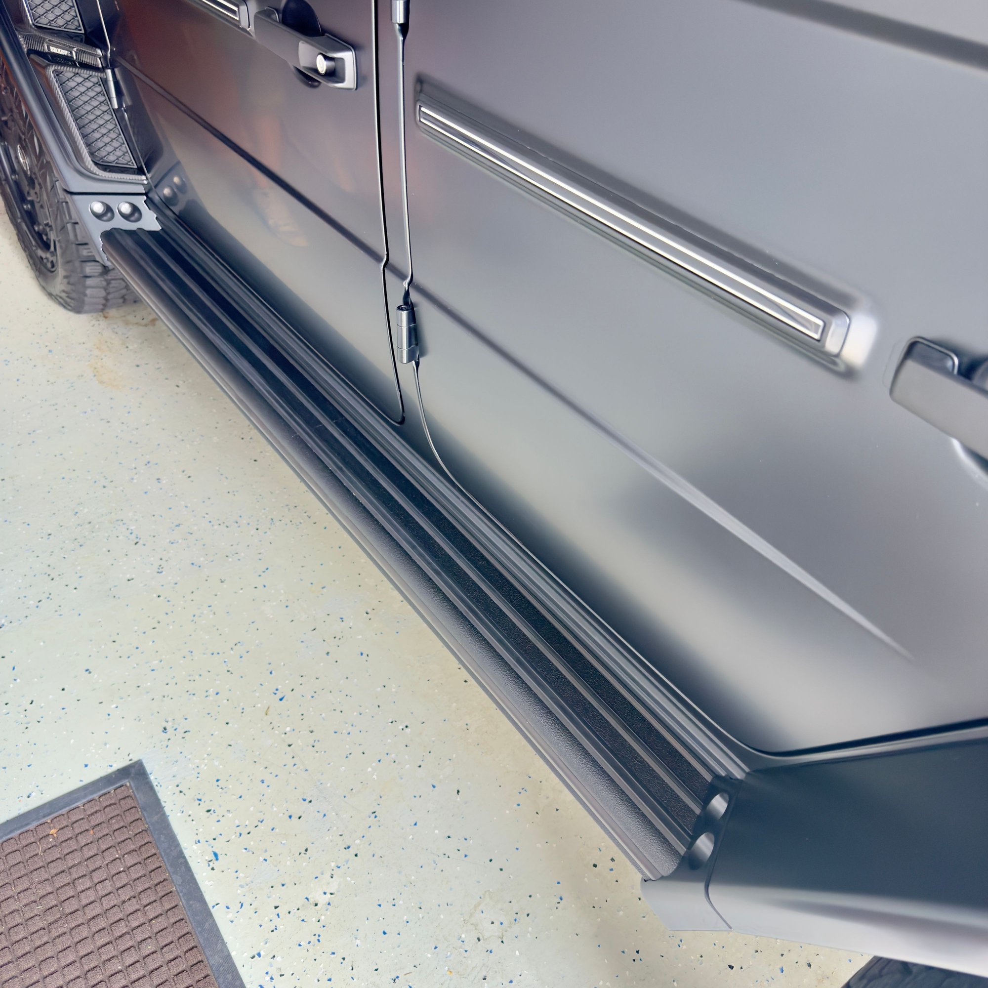

I just installed this kit on my 21' G550 and did not remove the strips nor end caps, turned out fine. The material is very forgiving if you need to stretch it or you can use the extra material provided to cover up any small gaps.

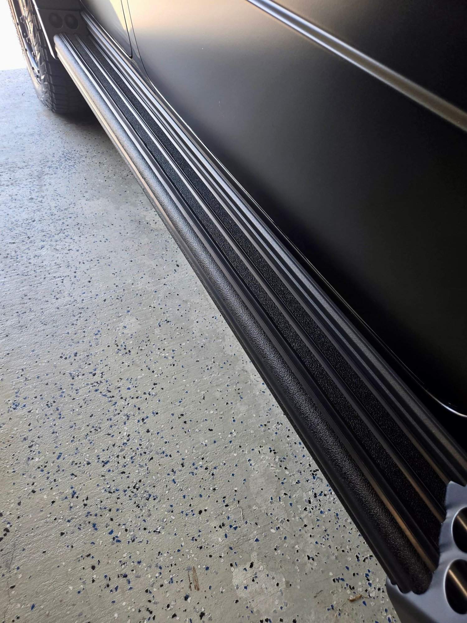

I also just did this. Thanks to the OP for the idea. The older kit came in two overlapping pieces, the new kit comes in one long piece. I did it without removing the end caps and it worked fine, in fact with the current one-piece kit I don't think there is enough length of material that you could even run it under the end caps.
