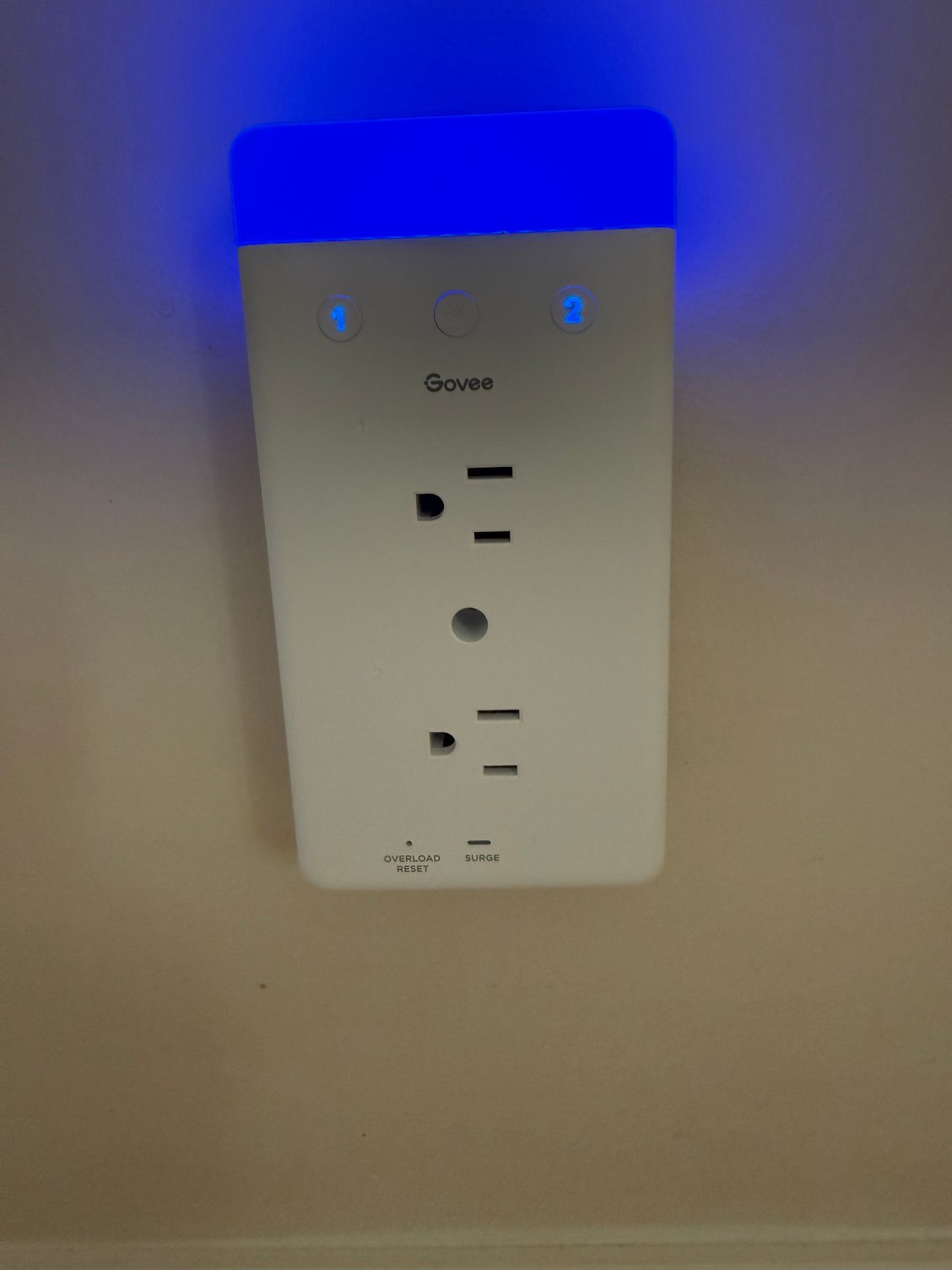

Hi folks. My Govee Smart Outlet arrived today, and I've already downloaded the app and plugged one of them in. I'm waiting for delivery of the Noco Genius 5.
Just a heads up - I had my company's IT department do some research on Govee Smart Outlets. To my surprise, they told me NONE of the existing Govee products have a surge protection feature, except for the "Govee Smart Plug Outlet Extender With Night Light", which is a new product recently released by the company. My IT guys told me it's a common misperception people have that all smart outlets have surge protection capacity, but apparently that is far from the truth. Here's the link to the model I ordered: https://us.govee.com/products/outlet...1wYtQHZZMm7TNO
I just wanted to share this information with those of you who're currently using a Govee Smart Outlet. As I indicated in one of my earlier posts, I'm in SoCal so we are all a bit sensitive to electrical items and potential fire hazards due to the fire(s) we experienced earlier this year.
I'm also attaching a photo of my newly activated plug. Stay safe.

If you're concerned about surge protection, you can have a "whole house" surge protector installed at your circuit breaker box (
Amazon Amazon
). I have one installed in my house and another in my out-building, and they do work.
