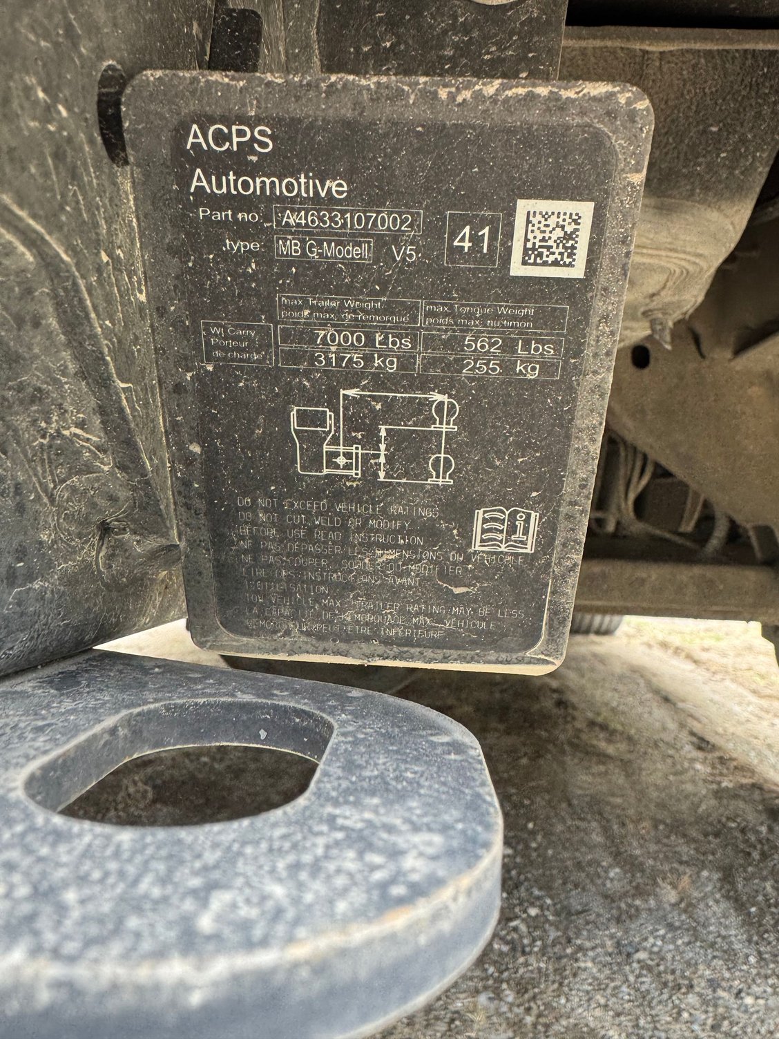

W465 G550 tow rating is 7000 lbs, a 16’ Bambi is 3500 lbs. The G will handle this with ease.

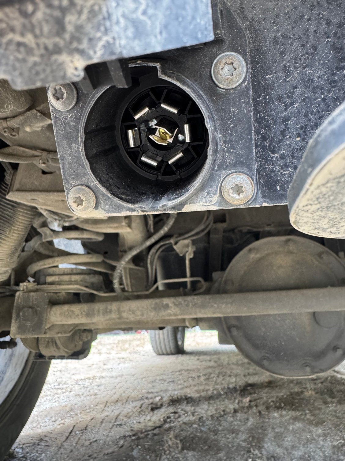

Text from MBUSA for the Trailer Hitch (standard feature). Looks like you have an electric brake controller pigtail somewhere in the vehicle, likely near the OBD port.
"Trailer hitch
With the standard trailer hitch, you can tow up to 7,000 lbs. The hitch includes the wiring harnesses for the trailer lights and brakes, while every G-Class is factory-equipped to handle the rigors of towing on the engine, cooling system and transmission. Standard Trailer Stability Assist helps keep trailer sway under control."

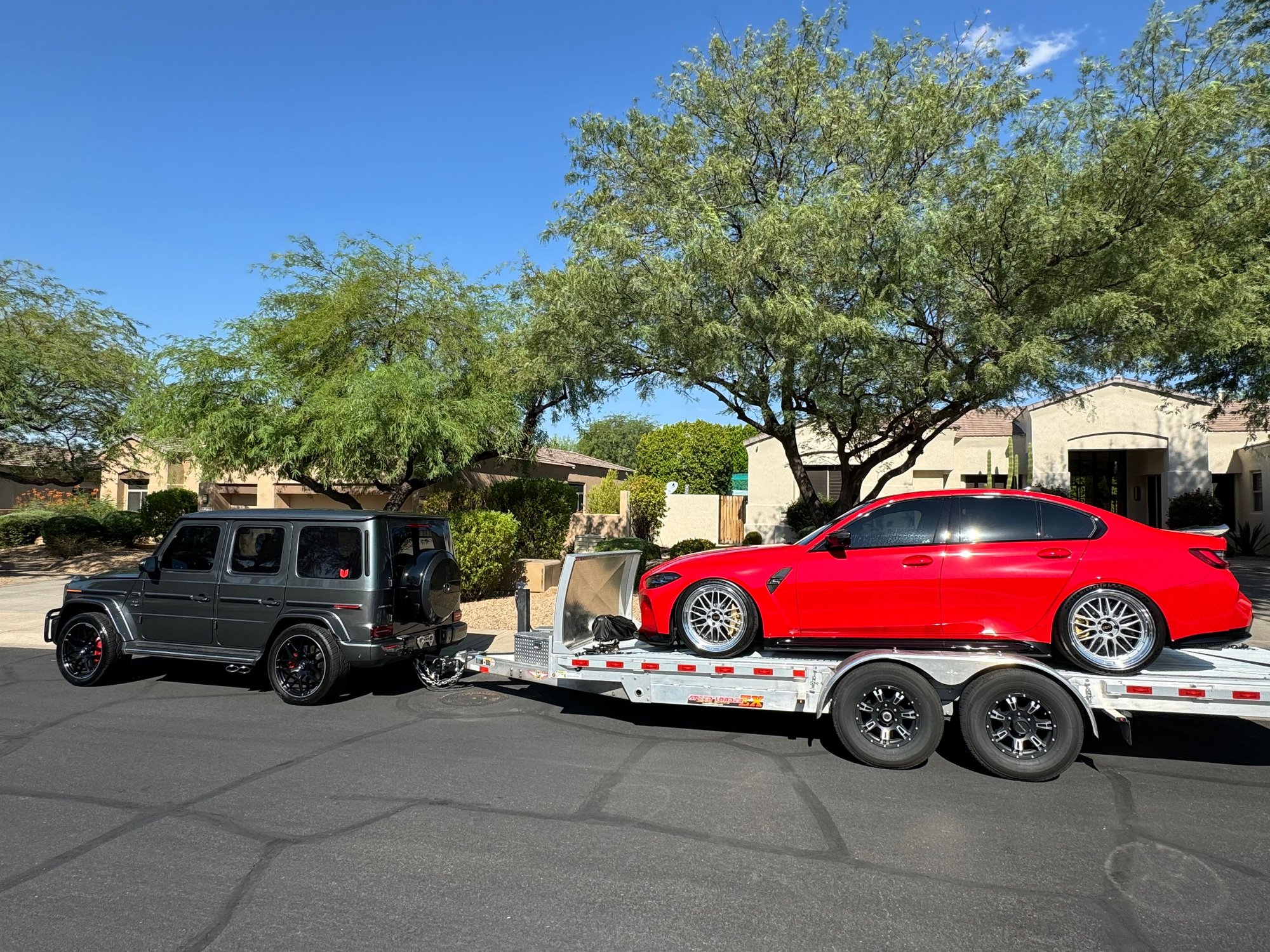

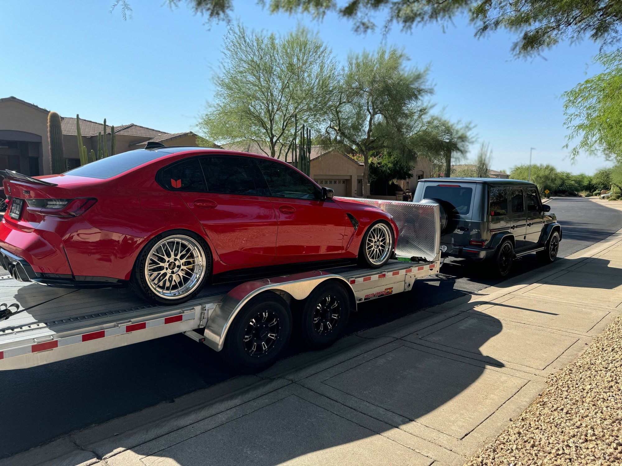

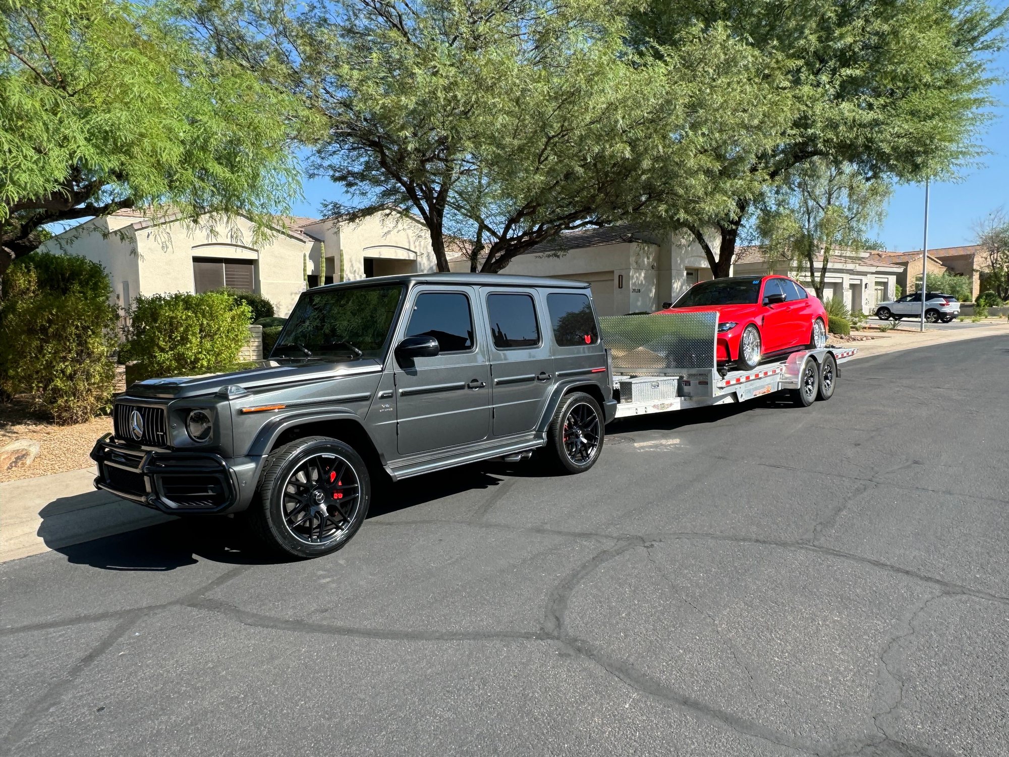

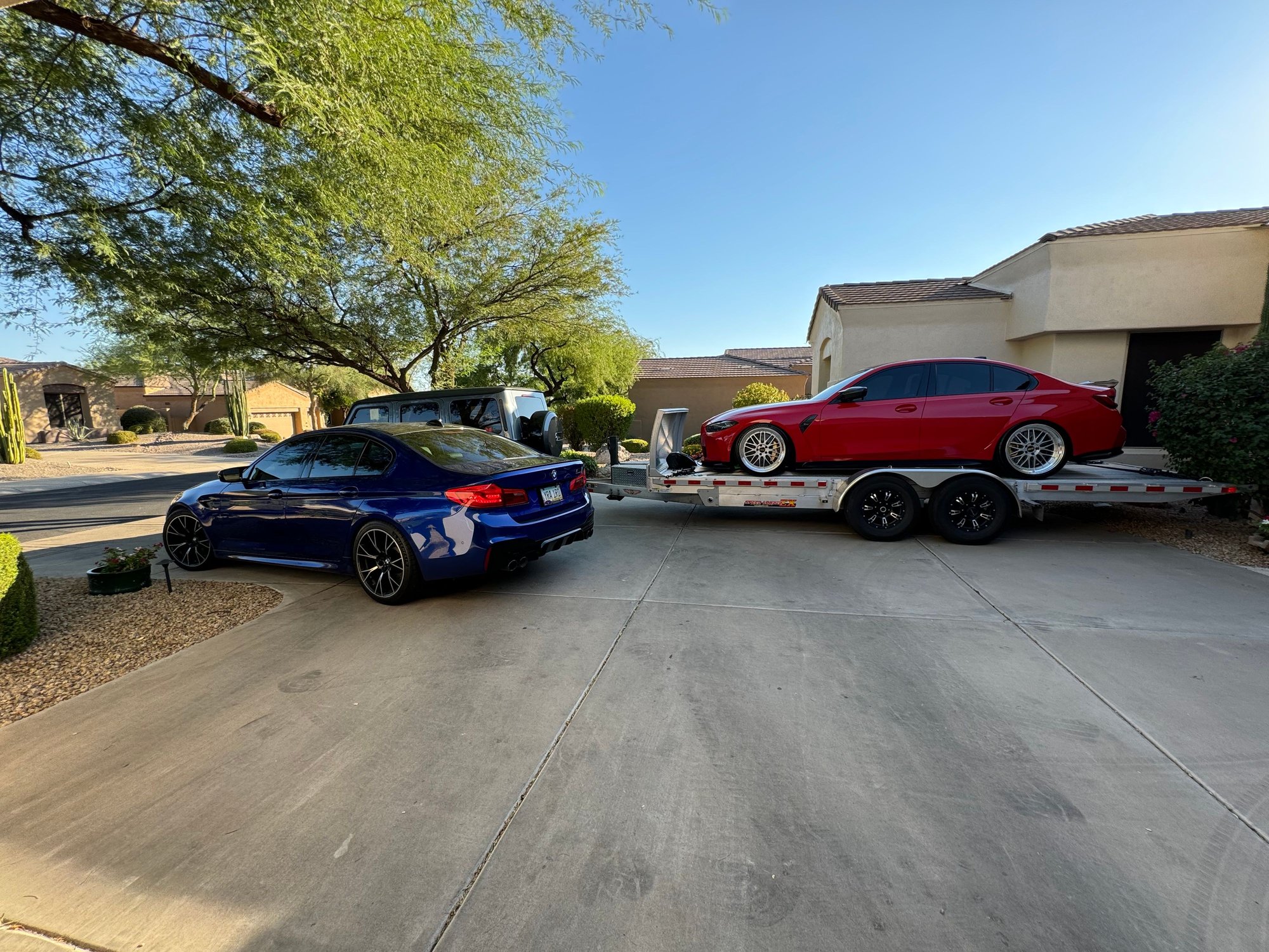

Not quite the same thing... but FWIW, I had a 2019 G63 (now 2025) and I towed a car hauler with a bmw m3 on it from Scottsdale to Los Angeles and back over a weekend, in the summer when it was 110+ degrees.
I had zero issues, nothing concerning, no surprises. At the time my G63 had about 50K miles on it. Like I said not quite the same story, but thought id offer my experience. and I would have no hesitation about doing it again.
I want to say the trailer was maybe 18-20 ft also. Probably 1500-2000lb trailer and the M3 3500-4000lbs. So I was towing anywhere from 5000-6000lbs through the desert up the hill from Palm Springs in to AZ on the way back. probably 8-900 miles total over a weekend with zero problems.

Brilliant @ffejnotrom, thanks for the awesome pics! Nice rig.

Looks great. This speaks to the cooling system performance, that it can handle added load at high ambient temperature.
Questions about your rig:
- passenger and cargo load in the vehicle?
- air suspension?
- weight distributing hitch?
- trailer brakes, and if yes, electric or hydraulic?
- if electric brakes, wired or wireless controller?
Old May 20, 2026 | 01:41 PM
ffejnotrom's Avatar
Joined: Jul 2023
Posts: 222
Likes: 74
2019 G63 AMG & 2024 AMG GT63
Myself, an adult male friend, some luggage for the weekend, and the car thats it.
- air suspension?
On the trailer? Not sure, it was a car hauler we rented from someone.
Great question, and not sure, im not well versed on the specs. Sorry about that.
Yes, it had trailer brakes for sure, and honestly couldnt tell you what type but I know for sure it had trailer brakes.
There was no separate controller for brakes, so maybe they were mechanical/hydraulic?
The trailer did have a hydraulic/electric tilt button to load and unload. But other than that Im not too sure on the trailer specs as it was a rental. We just had the guy we rented it from check in to everything to make sure his trailer could support the car, and that G63 was capable to handle the job, which it did with flying colors. One of the more pleasant towing experiences i've had to be honest, it was planted, felt solid, didnt feel like it was being over worked, I monitored the temps constantly, and there was nothing notable the entire weekend.
