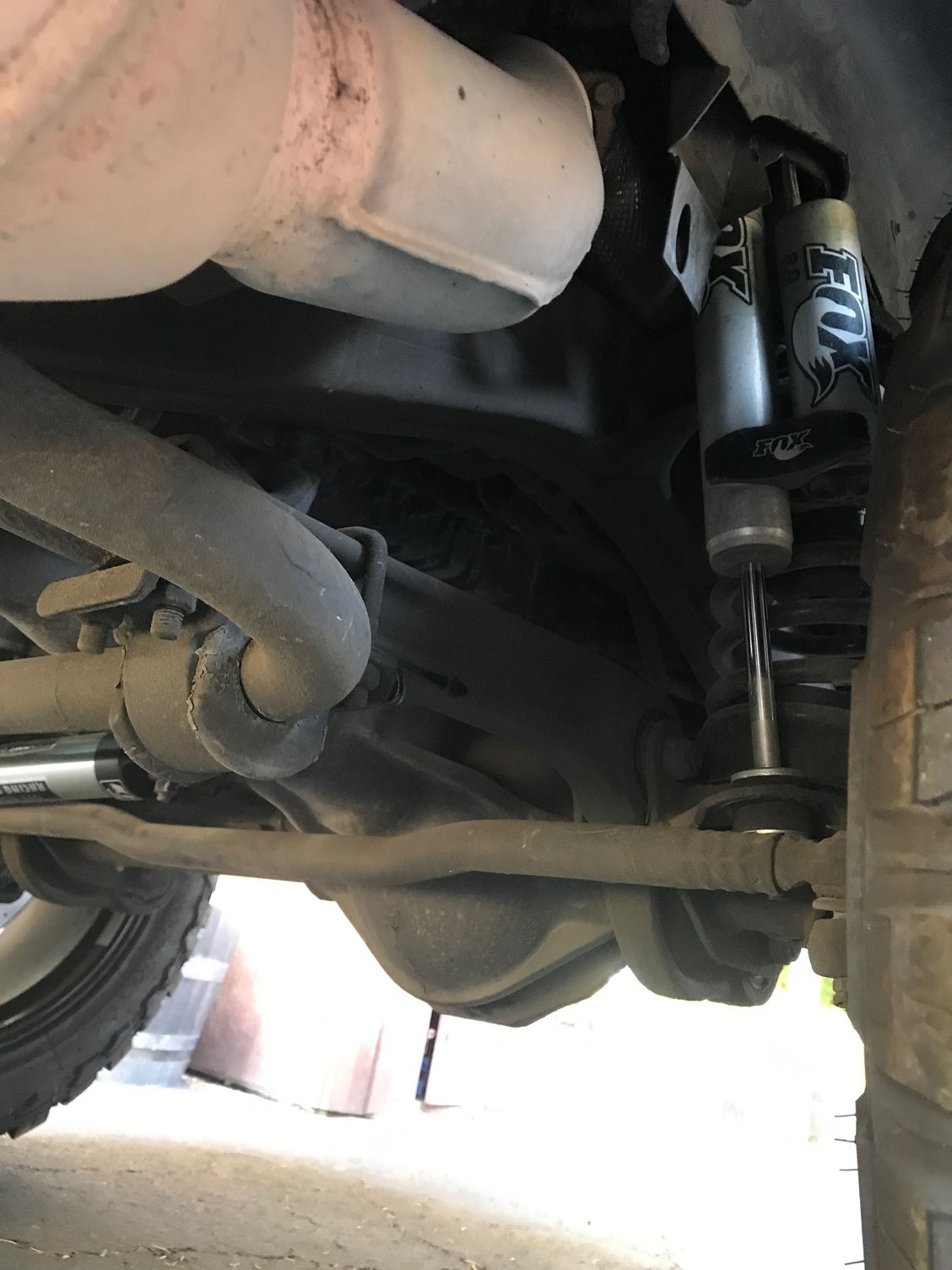

I just ran into this thread, and I'm suprised to hear such glowing reviews of the Viking suspension system. So, I have a question: how did you get the front Fox shocks to fit? did you cut out some of the inner fenders or modify the steering?
Reason I ask, I purchased the Thor Springs and Fox Shocks set from Viking about 3 years ago, and (so far) it has been a rather unfulfilling experience. The result was that only the rear Fox Shocks were installable without modifications. There seems to be no way to fit the front shocks without cutting out the inner fender walls, and on the drivers side, even then, I don't think it will clear the steering linkages safely, as there is no room for the remote reservoir, on either side of the truck. Without fitting the new shocks, I can't fit the new springs, due to the lift.
It seems like the shocks are made wrong, that the hoses to the remote reservoirs are just too short. But when I called Fox, they looked up the drawings and we measured the shocks, and Fox says they are correct, at about 5 inches long.
Alvin at Viking told me Fox should fix the shocks so they would fit, that they were made wrong, but Fox says they are correct already. I told Fox I'd pay whatever it cost to make the Fox shocks fit a G500. They said I would need to send measurements and photos and work with them to redesign the shock.
I'm baffled, and honestly I've been pretty discouraged that I spent $3K on this suspension which won't fit the G500, and so far has just sat in a box for 3 years.
Any help would be much appreciated.
Garret
Last edited by Mogster; Jan 5, 2021 at 11:47 AM. Reason: Needed to tame down the emotions.
Old Jan 5, 2021 | 11:04 AM
The Butcher's Avatar
Joined: Aug 2020
Posts: 783
Likes: 266
G63, G65
Reason I ask, I purchased the Thor Springs and Fox Shocks set from Viking about 3 years ago, and (so far) it was a disaster. The result was that only the rear Fox Shocks were installable without modifications. There seems to be no way to fit the front shocks without cutting out the inner fender walls, and on the drivers side, even then, I don't think it will clear the steering linkages safely, as there is no room for the remote reservoir, on either side of the truck. Without fitting the new shocks, I can't fit the new springs, due to the lift.
I'm baffled, and honestly I've been pretty disgusted with Viking that I spent $3K on this suspension which won't fit the G500, and so far has just sat in a box for 3 years.
Garret
I looked back at all my G wagon pics and this is the best one I could come up with for the orientation of the front shocks. You do have to cut the fender liner a touch, but it's just a fender liner. Not a big deal at all. I don't know if your G500 inner fender liner is any different than the G63, but that pic is from a G63.

Yes, you do have to cut to nicely fit the reservoirs in the front. If they supplied the front shocks with much longer hoses, then it would not be an issue to tuck the reservoirs in the engine bay or something like that. There is a user on here who cut a hole in the metal fender liner and fed the shock reservoir through and mounted it horizontally behind the wheel. I'll be attempting this modification and welding the fender liner back together in the spring.
They do not interfere with the steering linkage at all.
So Fox currently has been out of stock/production of their W463 kits for about a year, apparently to make changes to the design, but being the W463 kits sell very slowly vs their other applications, there really was no hurry. Double that the state of the world for all of 2020, they weren't available. I purchased the kit through Eurowise which had all the same issues. Had to do a lot of fender liner trimming to get the shocks to fit, and am still not happy with them, so will go back and redo it in the spring. Not sure when Fox will release their 'new design' for production or if it will actually solve any of the issues with the older kit.
