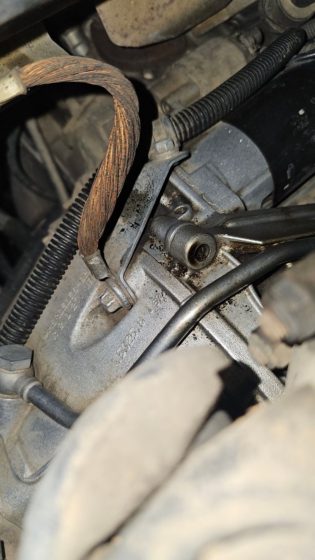

I cleaned the whole area and noticed that the leak is coming out in this place in this hole as well.
reng this photo is before I clean up the oil is not coming out rear retainer of the box

is that a rear main seal leak?

Kind of looks like it, doesnt it.
Usually its not super serious, but there does seem to be a lot. I have rear main leak in one of my cars too, but its a lot less.
Transmission drop, new seal, no other way around that.

is not coming out of rear main seal i cleaned and checked opened the two black caps inside this dry and clean check in photos 1 and 2 will notice that this one leaking somewhere else

i checked everything and i have a little oil leak from the oil pan sensor but thats not the only one because its also coming from back top engine.

I changed the oil sensor today, will be checking following days if everything will be clean and it does not leak any oil again. Job was good to do, I only had to loosen the steering rod to remove the oil pan nicely.
