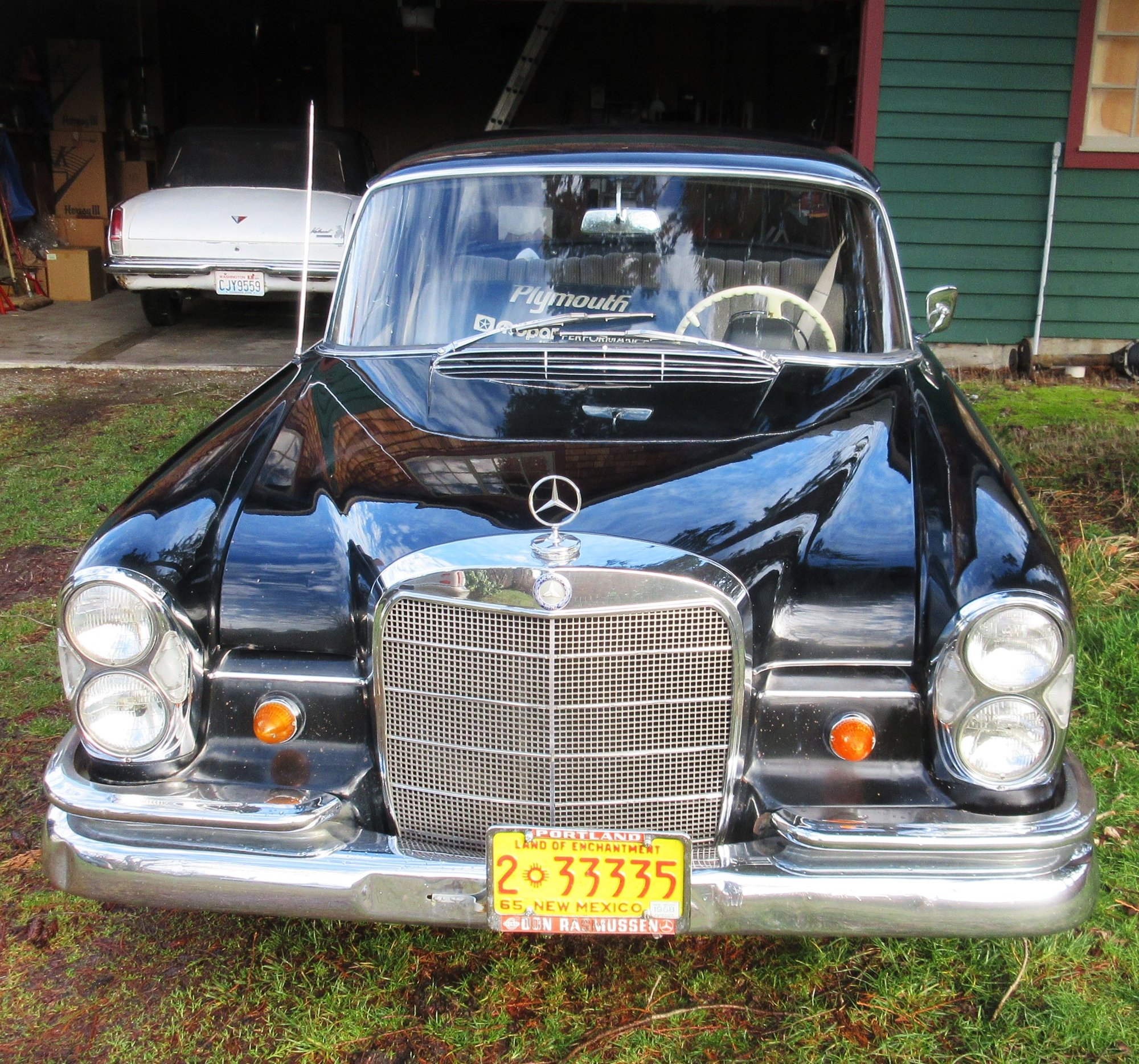

It took me 3 years . But , I finally figured it out . The "O" Rings on the Reverse Servo band had disintegrated . Also , On start up (3 years ago ) The Trans/radiator hose blew out . For some reason . Both at the same time .
I fixed the Servo . And did the lines , and pan gasket . This car has 800K on it . Original paint etc.... The only serious change is the front bench seat was recovered . The front bench seat is an oddity .
