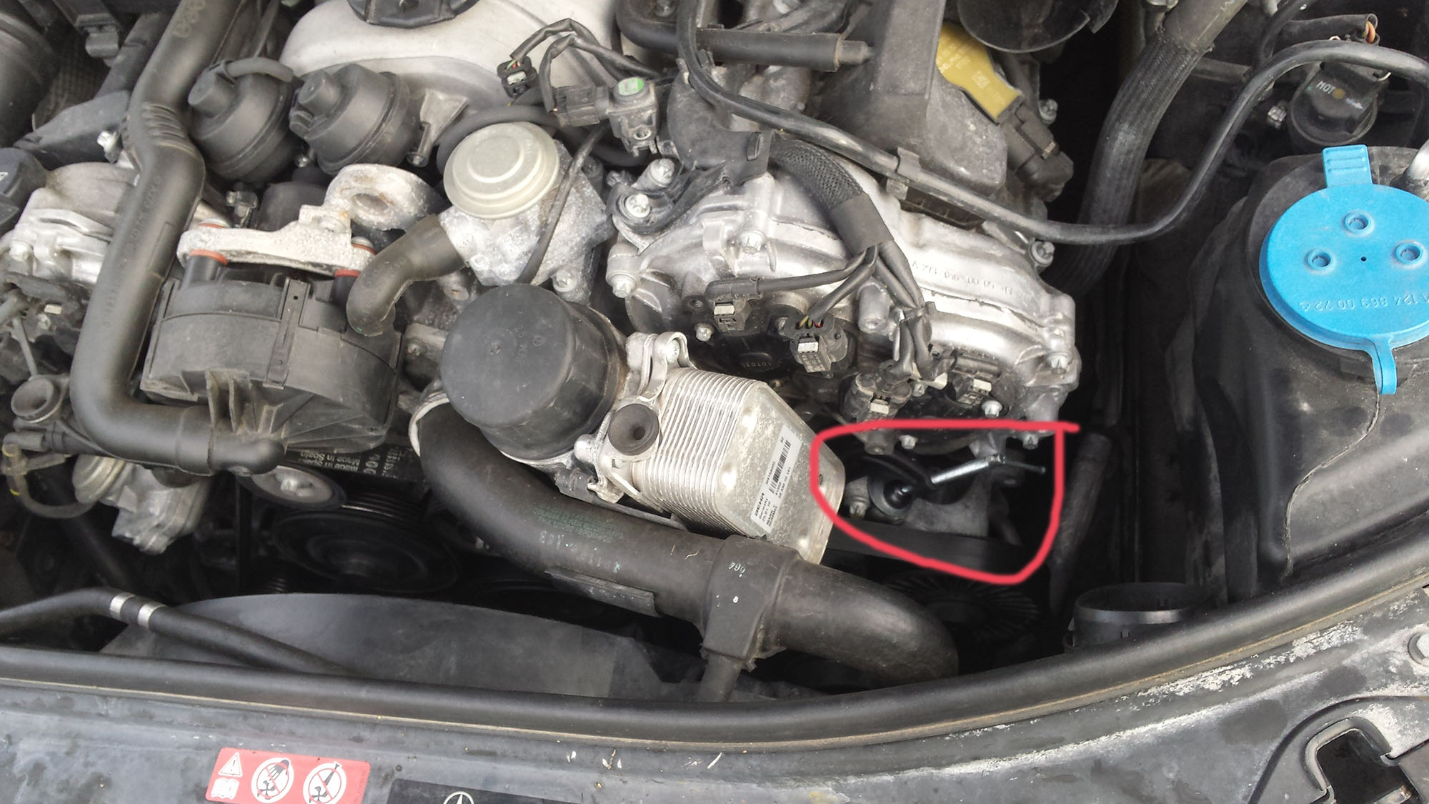

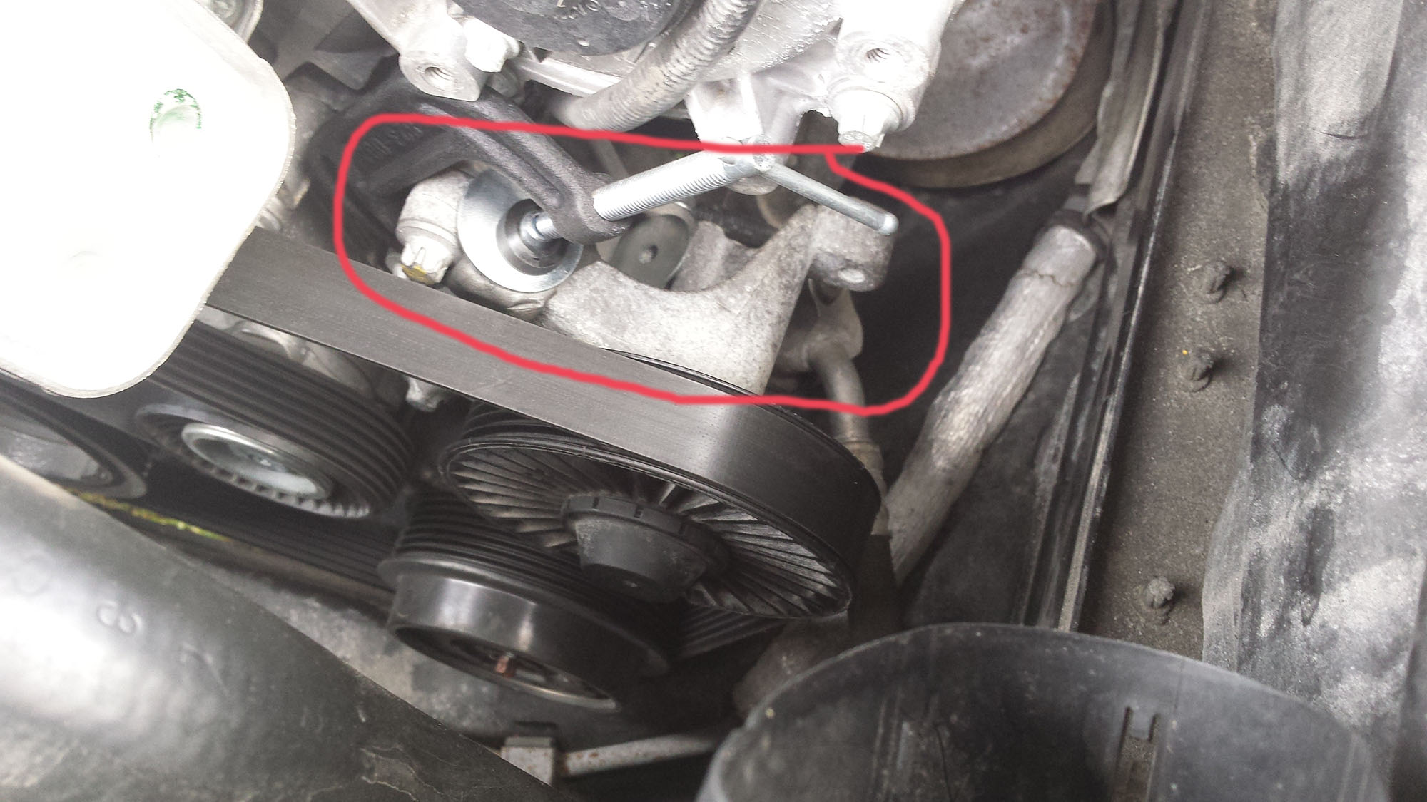

I have a 2011 S550 with an engine supposedly from a 2010 CLS550, I think that engine would be a 273960
A bracket on the engine holding a pulley snapped today as I was driving on the interstate. I patched it up to get home but cannot for the life of me identify the bracket, Ive looked all over google and the mercedes EPC, its driving me crazy
its a big chunk of aluminium that the wheel sits on (pictures below)
Please can someone find the part number for this so I can order replacement
tks in advance

SOLVED!! Even the stealership were stumped, they spent half an hour then gave up promised to check and call me back, still waiting.
after much more digging, I found it on EPC under section 21, Major assembly detachable components, subsection 230 V-Belt, Belt Tightener etc
Anyone else need this part in future the part number is A2722340339 BEAM Sheave Pulley
