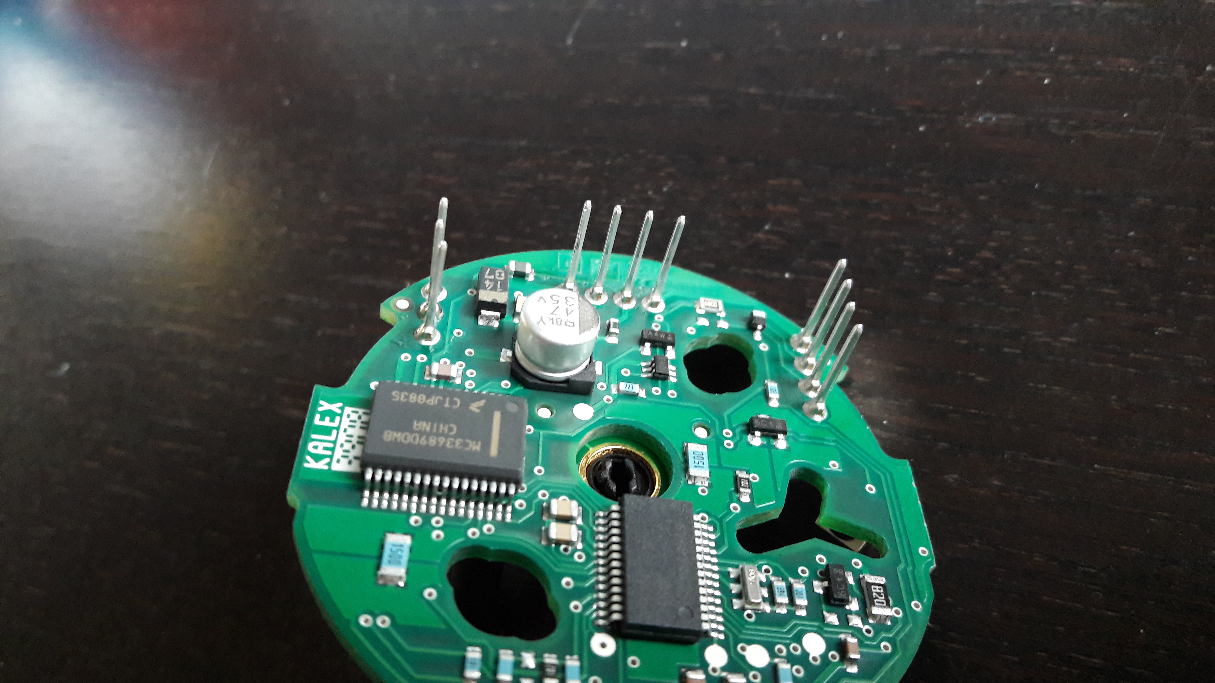

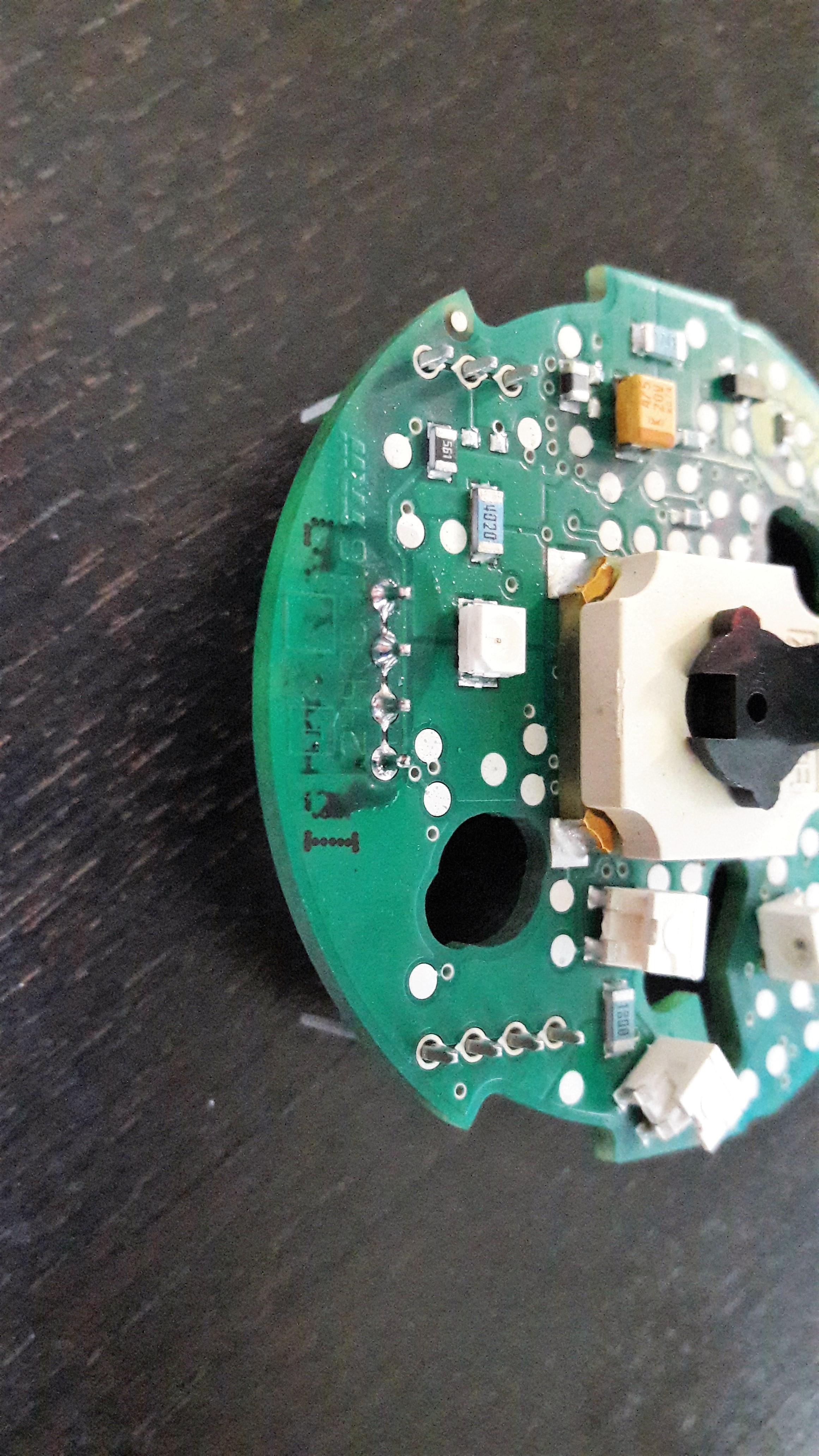

hi everyone I am new to the forum and thought I make a DIY for the Mercedes 204 light switch.
I had the right side parking lights coming on by themselves two three times a week draining my battery.
could not find a DIY for this. (only DIY for changing the switch witch is quite expensive.
I decided to open up the switch itself to see if I could find something.
first thing I noticed was the pins for the connector!!
they are not soldered just press fitted thru the circuit board
soldered this pins and my car has now bin fine for about 4 weeks.
maybe this can fix other issues with the switch. I don't know.
two pictures of circuit board inside switch.
apologies for my English.

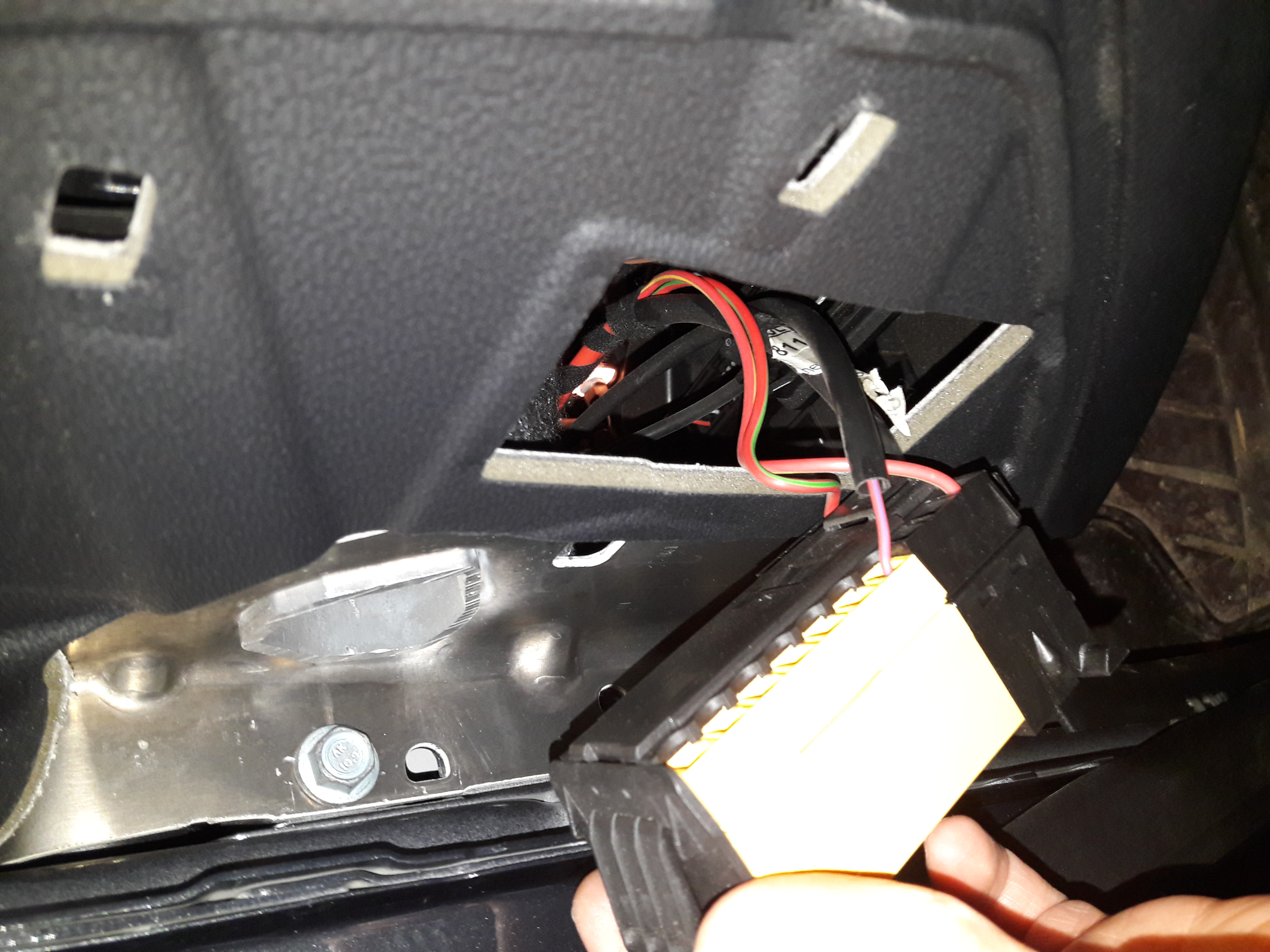

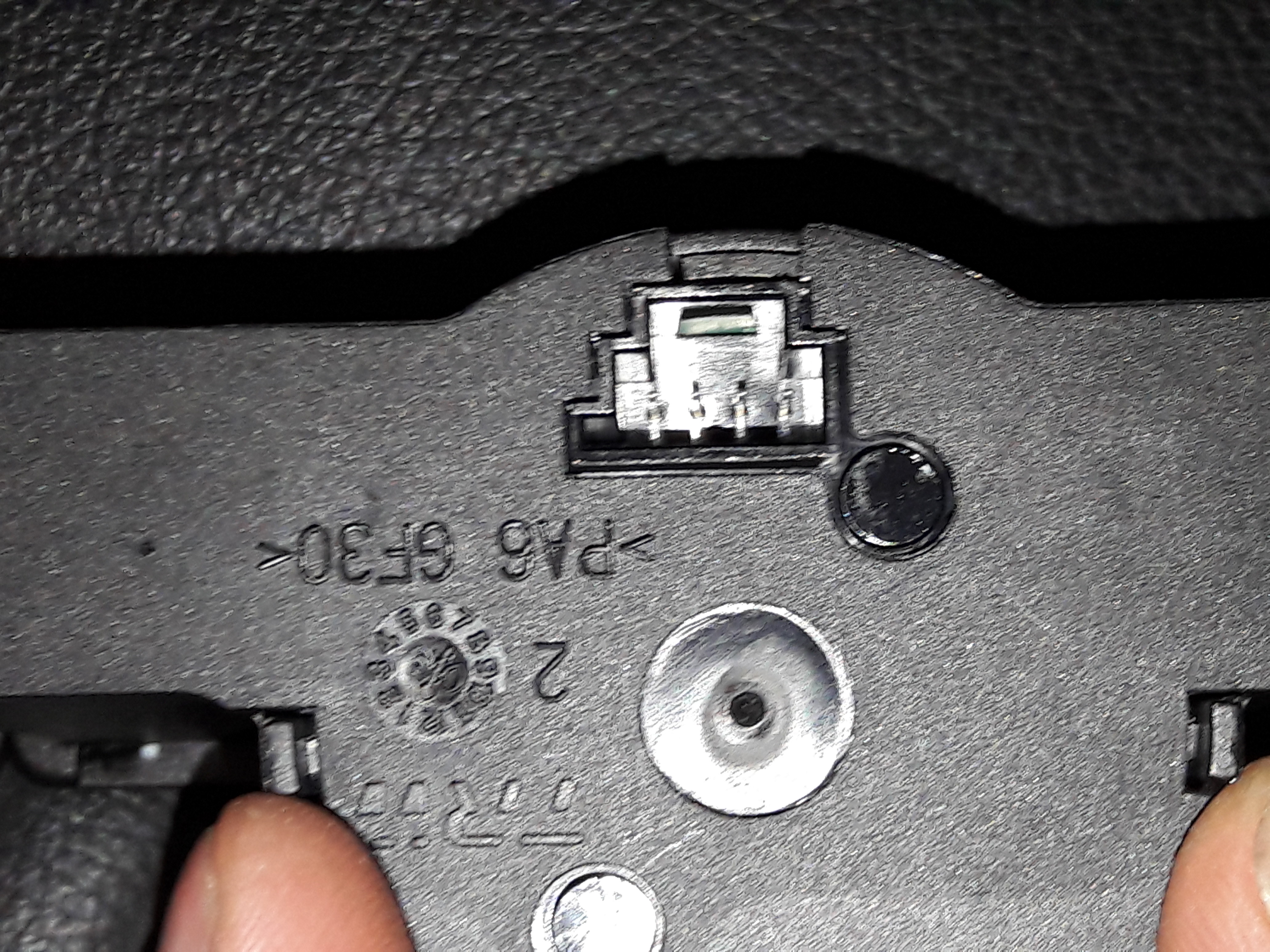

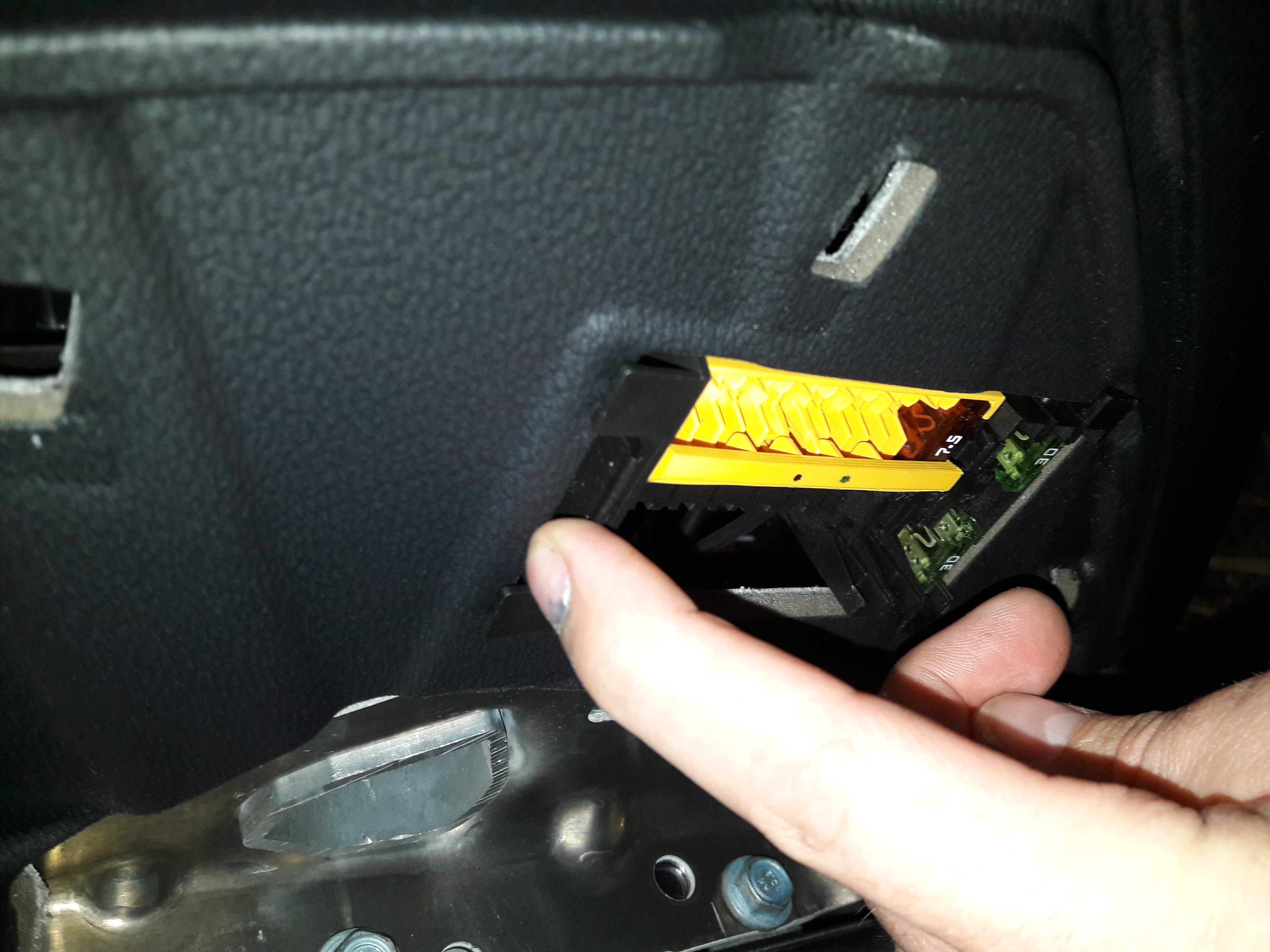

here are some more pics of how to take it out and how to take it apart.
take out the little fuse box. put your hand in behind the switch an depress the three metal tabs one at the top and two from below.
now push the switch out.
carefully take it apart as there at two small springs inside.
best to solder the pins for good connection.

I got the same issue. Headlight only works in Auto mode. Manual position sporadically turns off the lights or causing one side light to turn on or blink by itself. Or staying on after closing the car.
Just apply a bit of solder on the back side on those press-fit pins. So far so good.
