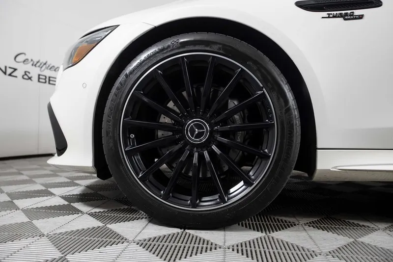

I saw a bunch of tutorials on the other type, but having trouble finding anything on how to take off the center cap of these type of rims. Anyone know how I remove these center pieces to get to the bolts underneath?
Reply 0
Mar 5, 2024 | 12:22 PM
Figured it out, you can twist the chrome circular part counter clockwise with your hand, then it unlocks. From there you can use a plastic pry tool (like when vinyl wrapping) to get it off without damaging it.
