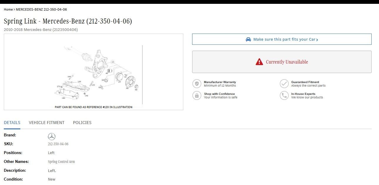

Just a quick follow-up on this. The rear spring perches were pretty rusty when I did the job last year. I got lazy and ordered new ones. Turns out that they were unavailable, with no known delivery date. So I cleaned up the originals, which was okay because they are a pretty robust chunk of steel. Today I was doing some updates to my vehicle service records and I ran across my old unfilled order. And I got curious. You can guess what I found. As of today they are *still* unavailable, *still* with no known delivery date.
I had the same issue with the lithium ion main battery in our S65 AMG Coupe; at least in that case Mercedes had a partial excuse, the factory that supplied them to M-B having gone out of business. But those are still unavailable too. I have to imagine that by now M-B has come up with an alternative. That's a lot of very expensive iron to leave sitting around for a few years! But what about those spring perches? If someone truly needs one there is no substitute. Seek one from the breakers I suppose...
More generally, the fact that both parts are unavailable for such a long period of time does not fill me with confidence. Maybe I should buy a 1967 SL, at least then I could get parts from M-B Classic.

Is the part on backorder?
As for the battery, you could have it programmed to use AGM instead, although you will need a third party coder to do so.
That's what I did. You can search the few posts I've made on here to see more.

I don't care. I only want to be able to fix a car that is otherwise in excellent condition, and I can't invent that part.

I see, I am not sure if I missed it but did you mention you tried other MB dealerships and ask why the part is not available? The image shows not available it doesn't simply say backorder, is it discontinued or superseded?
