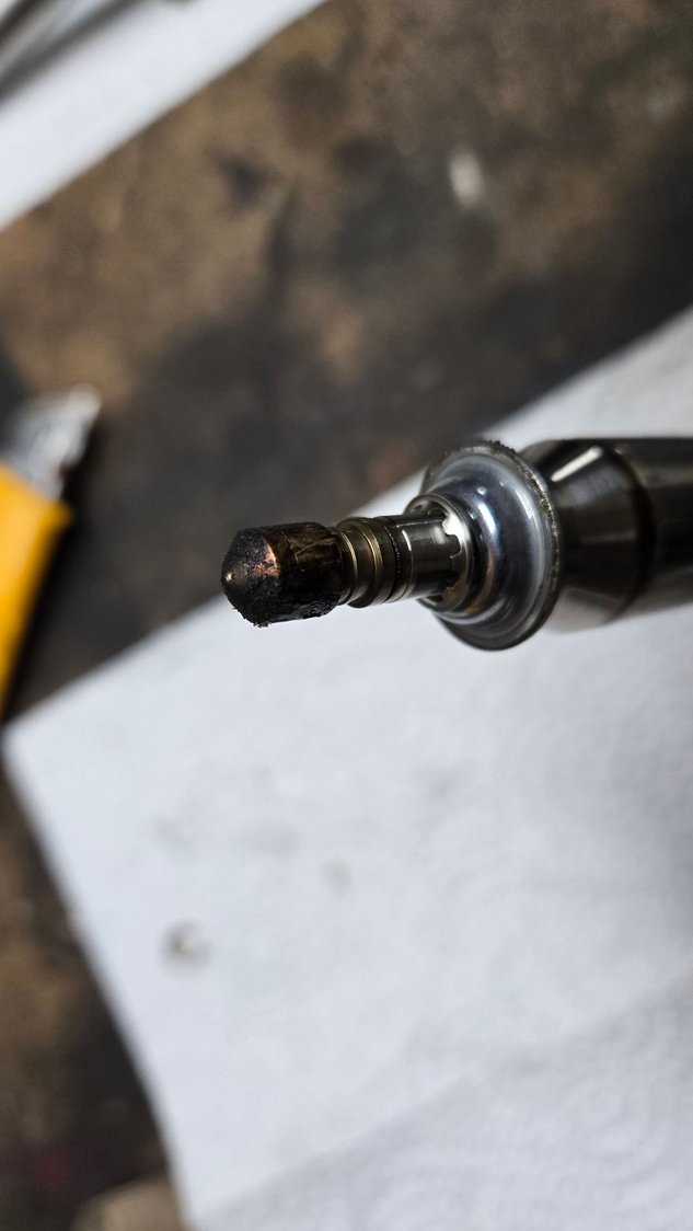

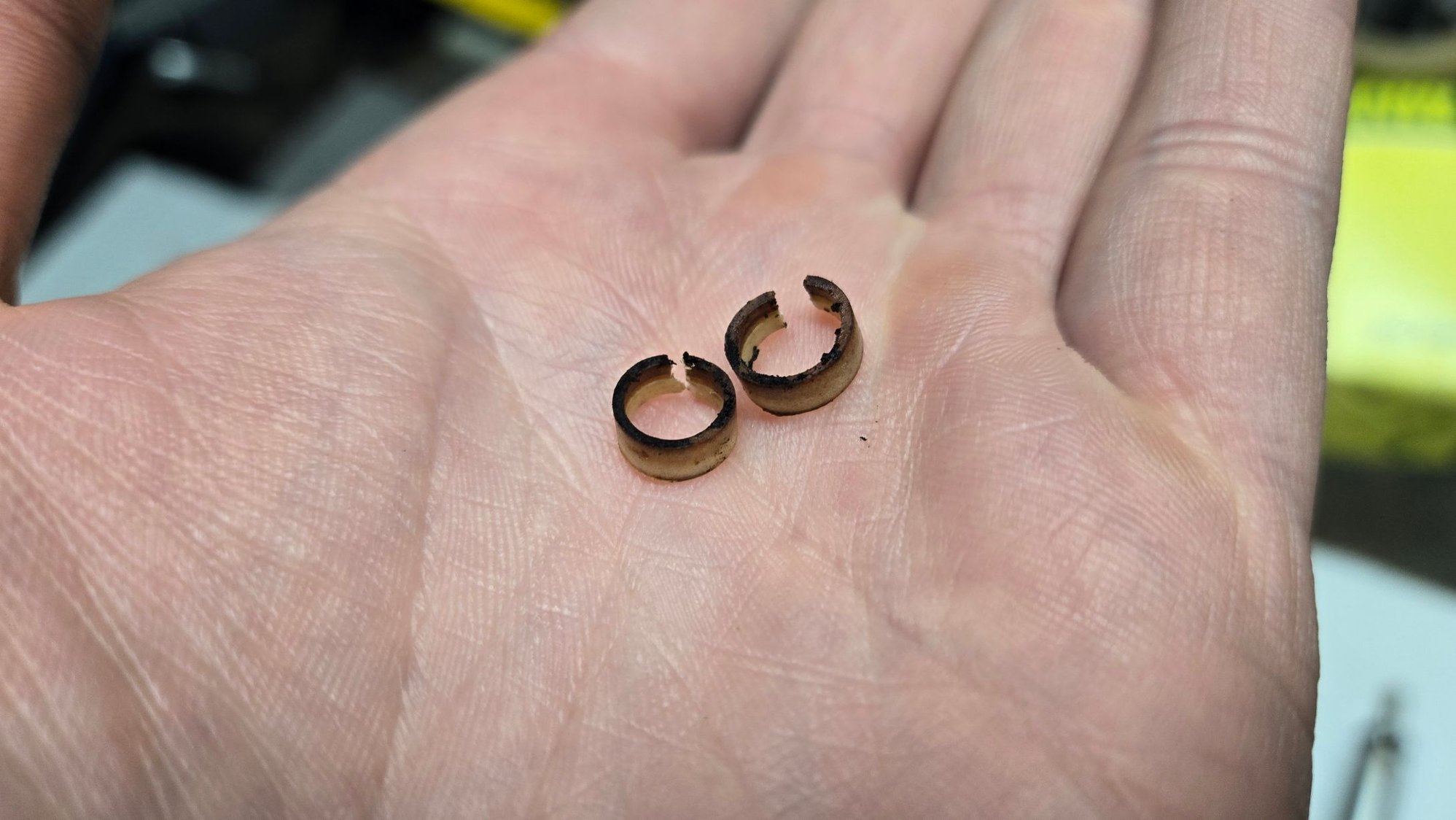

I recently had a miss fire on cylinder 4 so i decided to take all 8 injector's out for cleaning
as well as bore scoping to check for cylinder wall wear. will include pics later this week of every cylinder
i will include some photo's of what to expect regarding the condition of your injector's once you get up in mileage

these are some photo's currently @ 170,000 Miles, first time having the injector's out
and i am doing a OHM test to check each individual injector for function
(200+ is healthy) anything lower then that is signs of failure.
number 4 failed ohm test reading
oddly, the rear injector's have collected more carbon build up then the front, if anyone can chime in on how that developed i am curious.
cylinder 1
cylinder 1
cylinder 4
cylinder 4
