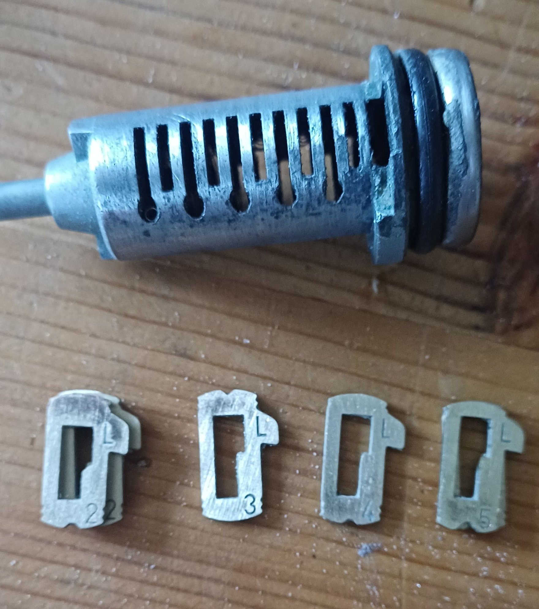

Hi stripped the trunk/book lock on my cl500 as it was seized, cleaned everything up but not sure how to put it back in order, ten slots, ten springs, but only seven brass pins. Three stamped L2, one L3, one L4, and two L5.

I'd take it to a locksmith to make sure it's reassembled correctly and that there's no damage to compromise its function.

You don't put a pin in every slot. Some are left empty.
Line them up with your key cut. Deepest cut gets the L5 pin, shallowest gets the L2.
