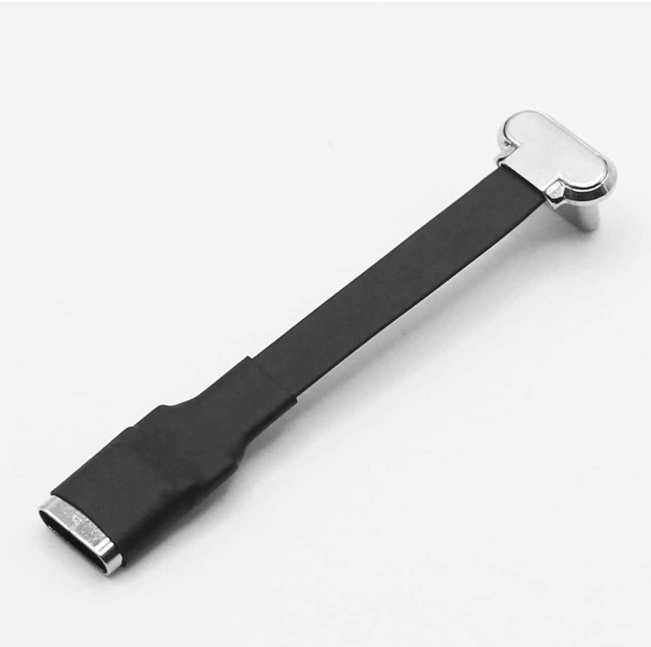

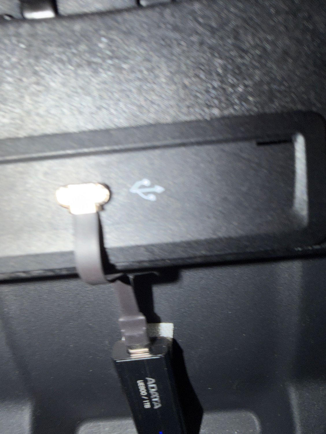

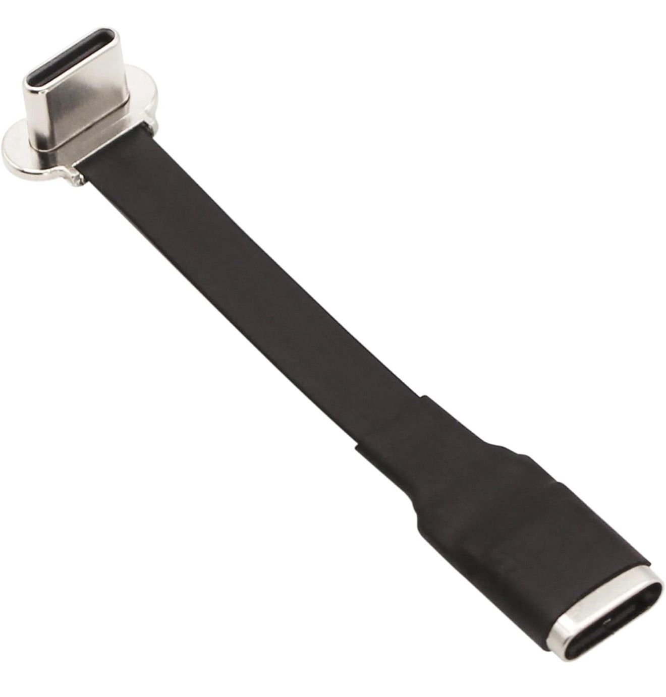

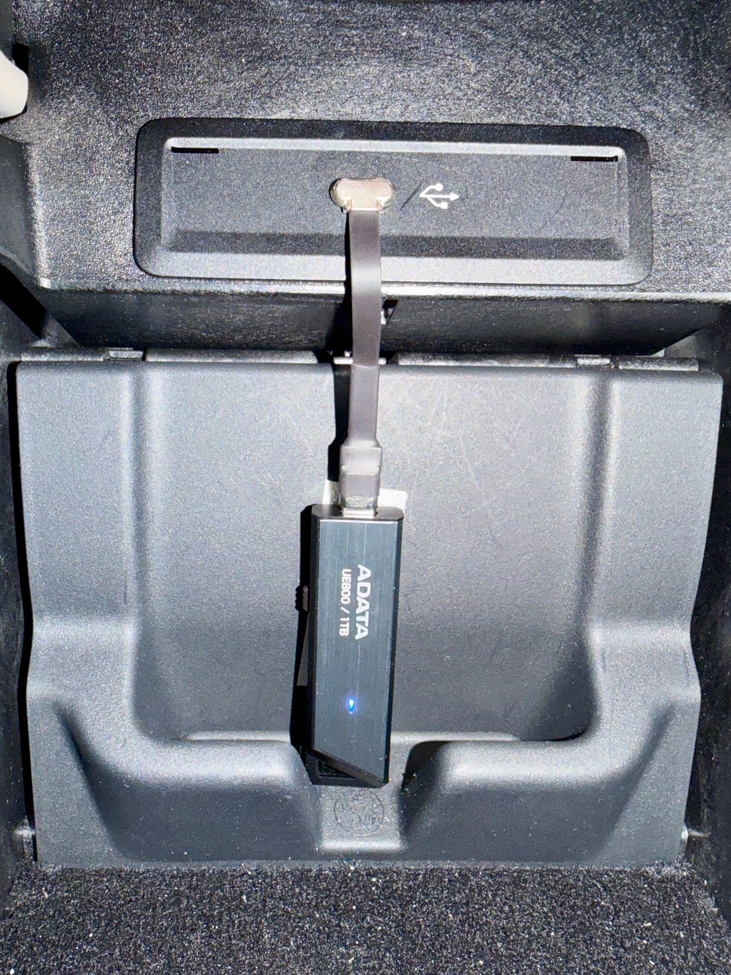

This is how I added my memory stick for to store the OEM front camera videos in my 2024 AMG GLE 53. Many recent MB cars have this sort of configuration and USB-C port inside of the center console. The memory stick is 1 terabyte which holds a large amount of videos. The cable is a 3.2 Inch Flat USB C Flat Extension Cable 90-Degree USB C Male to Female. I tried a 2 inch cable, but, it was too short for my set up. The memory stick is Velcro taped to the front side of the center console so that it is all out of the way.
I got the cable on Amazon for about $13. The exact 3.2 Inch cable is no longer available, but, other lengths are available. For me, it was important that the 90 degree terminal that plugs into the USB-C slot was very flat to keep things out of the way. See the pics & attached video.
