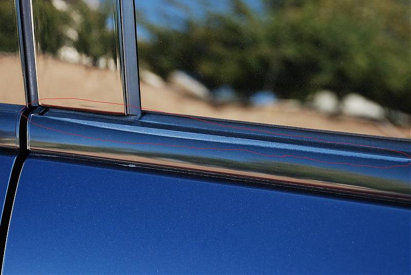

I noticed last week that the window trim on my rear quarter pannel windows appears to be deteriorating. In the pictures, it is highlighted by a red circle. It is happening on both sides. I sent pictures to my SA and he has ordered replacement parts and will have me bring my GL in to have them replaced under warranty.
Anybody else have this problem?

From the pictures, I wasn't sure if what I was seeing was a reflection of light, or a dent. So, when you say deteriorating, does that mean the trim pieces are actually denting inward? Or, are they beginning to chip apart.
I checked mine out and they look okay, but I'm curious as to how yours are deteriorating.

It's hard to see in the pictures, but there is a clear film over the black trim that is peeling away.
Perhaps the factory wrap was not 100% removed. Found several areas on my GL with similar overlooked wrap.
Okay, I can see it now. What I was seeing as a dent is where the film is peeling away.
Thanks for the clarification. I'm sure all of us will keep a close eye on ours as well now.
