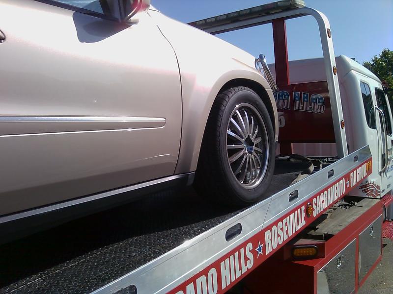

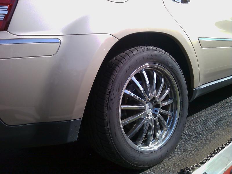

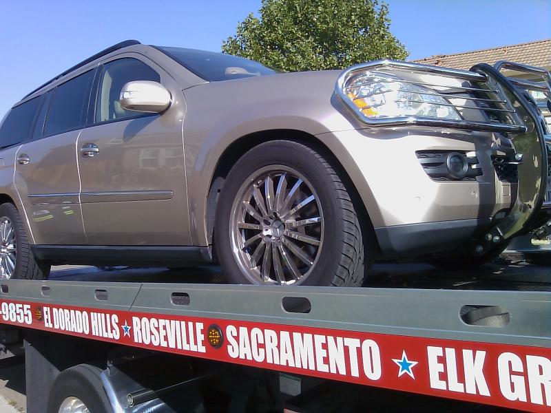

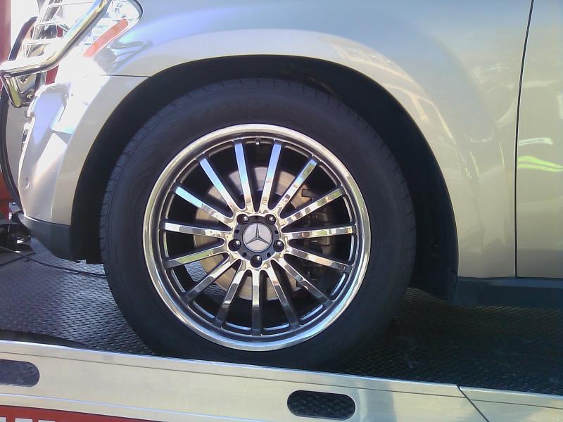

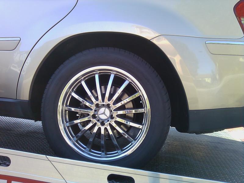

GL had an Airmatic light on the cluster and says visit workshop. So I schedule an appointment to take it in for checkup. The day of the appointment when I left our home I notice the GL dropped out completely and wasn't going to the normal height. I end up calling a dealer and setup a tow service. They fixed it in couple of hours. Airmatic compressor was faulty and it was a recall. While it was at the dealer they did a pulley recall. No issues now. See some of the pictures on the tow truck with GL(low rider) on tow truck. Any of other owners have any issues after new compressor was replaced.

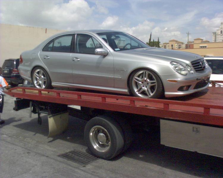

Its about time for the recall airmatic notice after all the failures. It is just a bad design and some manufacturing defect since it happened on so many different models. My E55 went out after 24,000 miles. The black GL was to the left was in the holding area for the same problem. It had to be brand new if the pic was taken in September 06.
