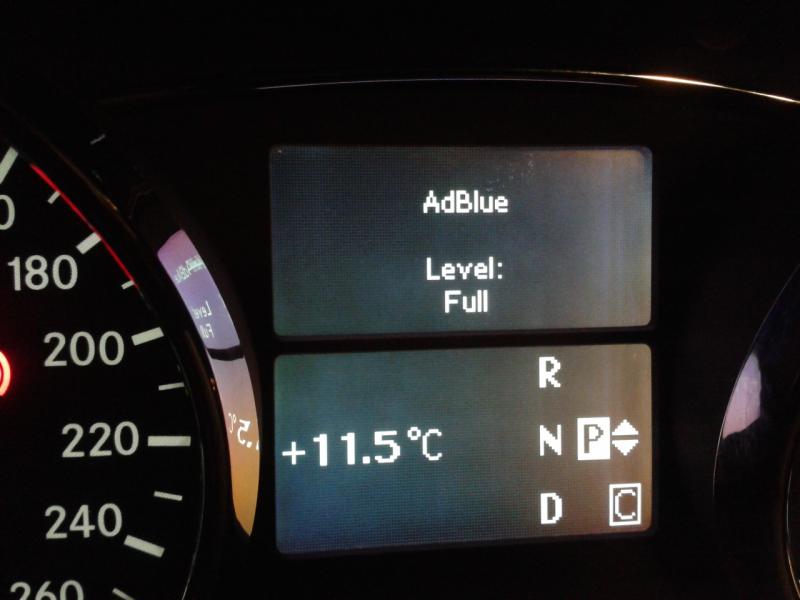

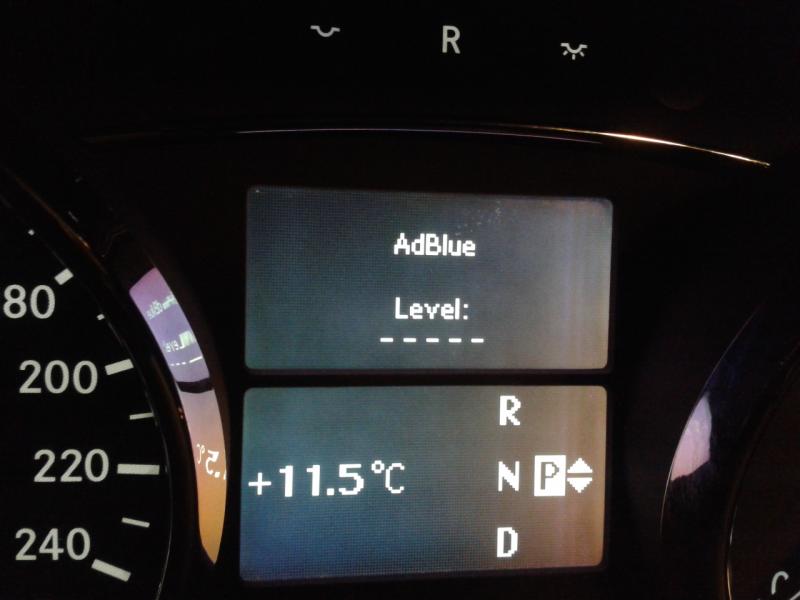

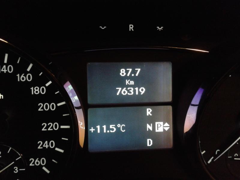

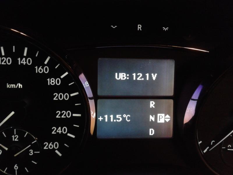

1. Insert key and turn to 1 position, press page button until you see trip meter. Do not start.Ad Blue indicator-2013-10-30-22.10.08.jpg
2. Press reset button 3 times. you will see system voltage.Ad Blue indicator-2013-10-30-22.10.18.jpg
3. Press up arrow until AdBlue level indicator.Ad Blue indicator-2013-10-30-22.10.31.jpg
4. Turn key to next position and you will see AdBlue level, see pictures.Ad Blue indicator-2013-10-30-22.10.44.jpg

Thats it - I was going to get around to posting it.. thanks!
