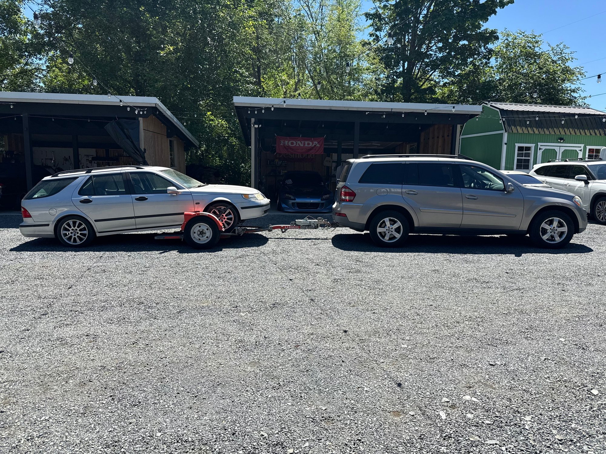

Sorry for the zombie thread resurrection, but this went fine:
